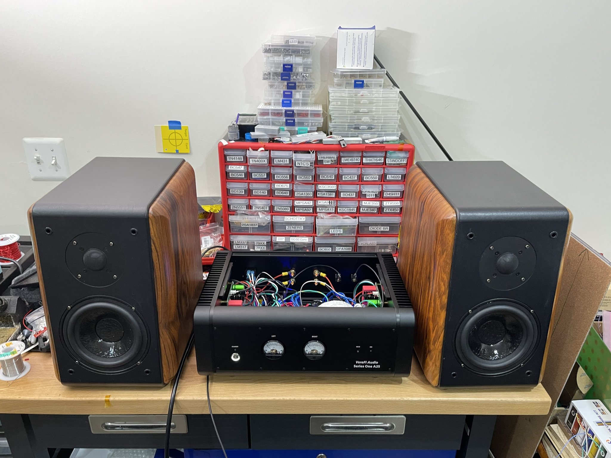

The Alpha Nirvana is playing music finally.

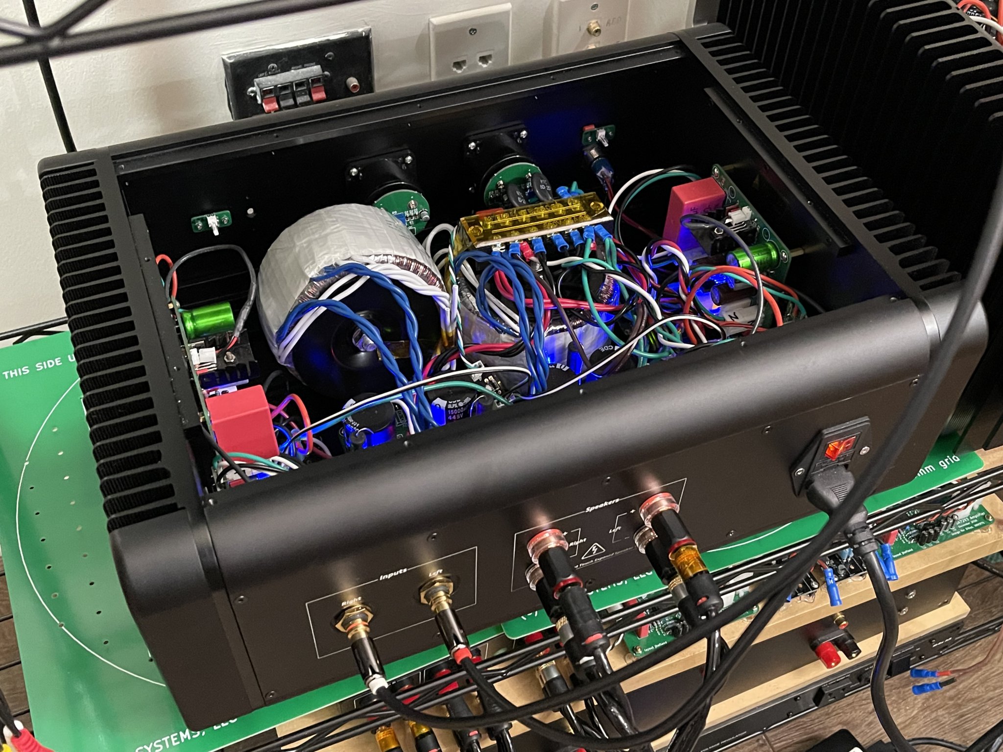

I’m getting +/-30.4V rails and 1.78A bias current. Heatsinks at 56C. SSR speaker protect with low capacitance PSU provides instant off to prevent thump. SSR activated by low voltage front panel switch works great.

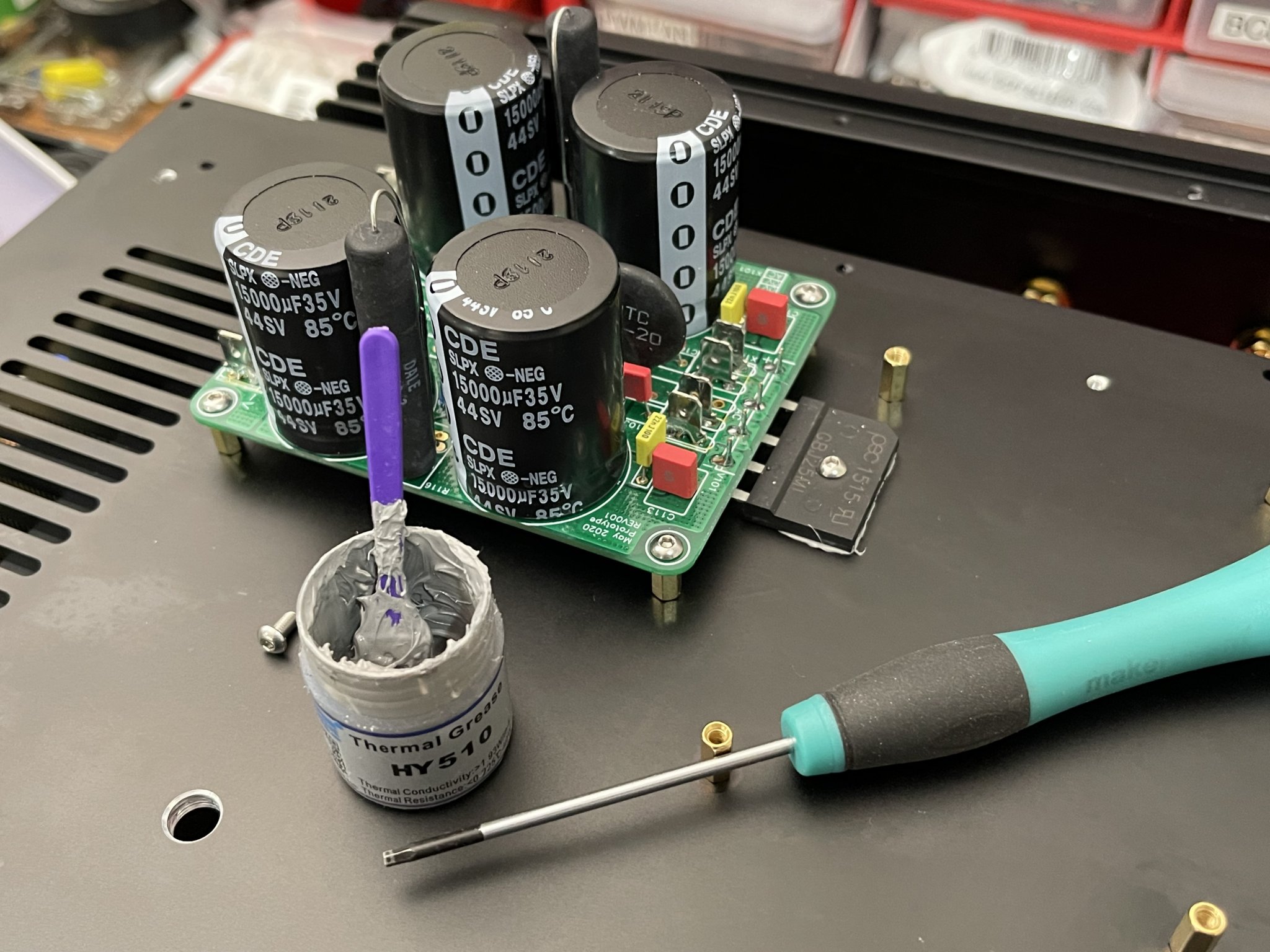

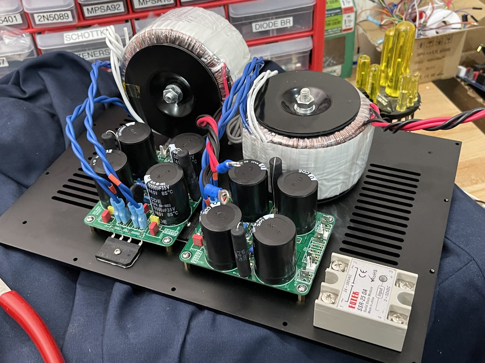

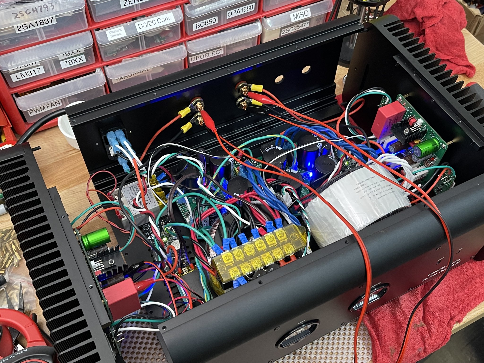

Thanks, Zman and Hugh. It’s a bit tight in there. That is what a pathfinder activity like this tells me. Couple of options is to move the PSU caps and bridges to the amp
PCB on the heatsink - a la Aspen. 🙂
That would free up a lot of space. We did this before on Deltic.
A custom 400VA trafo with 4x 21v secondaries would also reduce mounting points. Right now +/-30.4v rails will probably make close to 49w into 8ohms. The chassis os running a bit hot for my tastes as this is 108w dissipation per side! With the lid on it would be too much. Although a small Noctua fan would keep insides pretty cool if vented up and out.m
I love how the heatsinks can be removed or installed while amp is fully connected and running with 4 socket cap screws from the outside! Actually, all panels can be removed from the outside and this will make installing wires for the front panel much easier.

A pleasant surprise to see another AN born this Sunday morning while sipping an espresso, Nice work X! A custom Toroidy 400va, 4 x 22v sec. trafo would be sweet inside that lovely chassis.

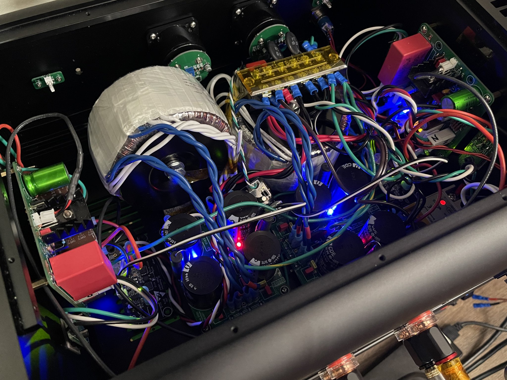

I don’t know how you guys build chassis with neat wiring with 90deg turns all wrapped up? Maybe more space inside would help? It’s tight on this one and I work quickly to see if it works, thermal dissipation is ok, and parts not too close where there is noise pickup. All that is good except a bit too much heat. I grabbed these trafos from another project. Without the SLB to drop 3v, the trafo voltage will need to go down. I think 21v will be about right. With 23v, I have 35v no load and 30.4v under load.
I moved it over to my main system and on the big rack now. Connected to XSD dipoles. I had the same amp here before but it was not dual mono. I think there is a substantial improvement in soundstage width and image depth now. The channel separation makes all the difference.

I’m really enjoying the Alpha Nirvana in dual mono. Track by Liz Wright sounds fantastic. The smoothness of Class A is always a delight to find again after listening to other amps.
