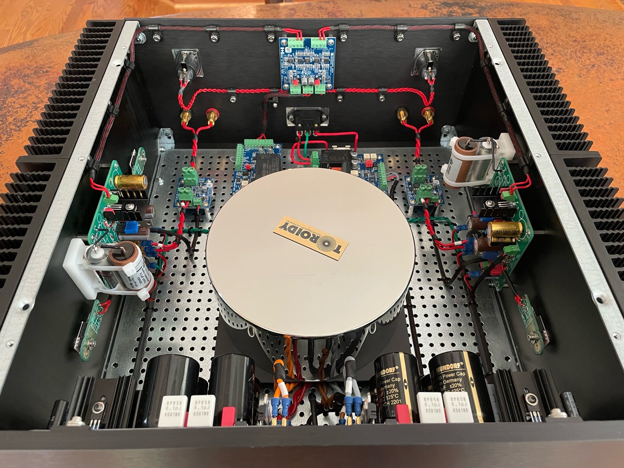

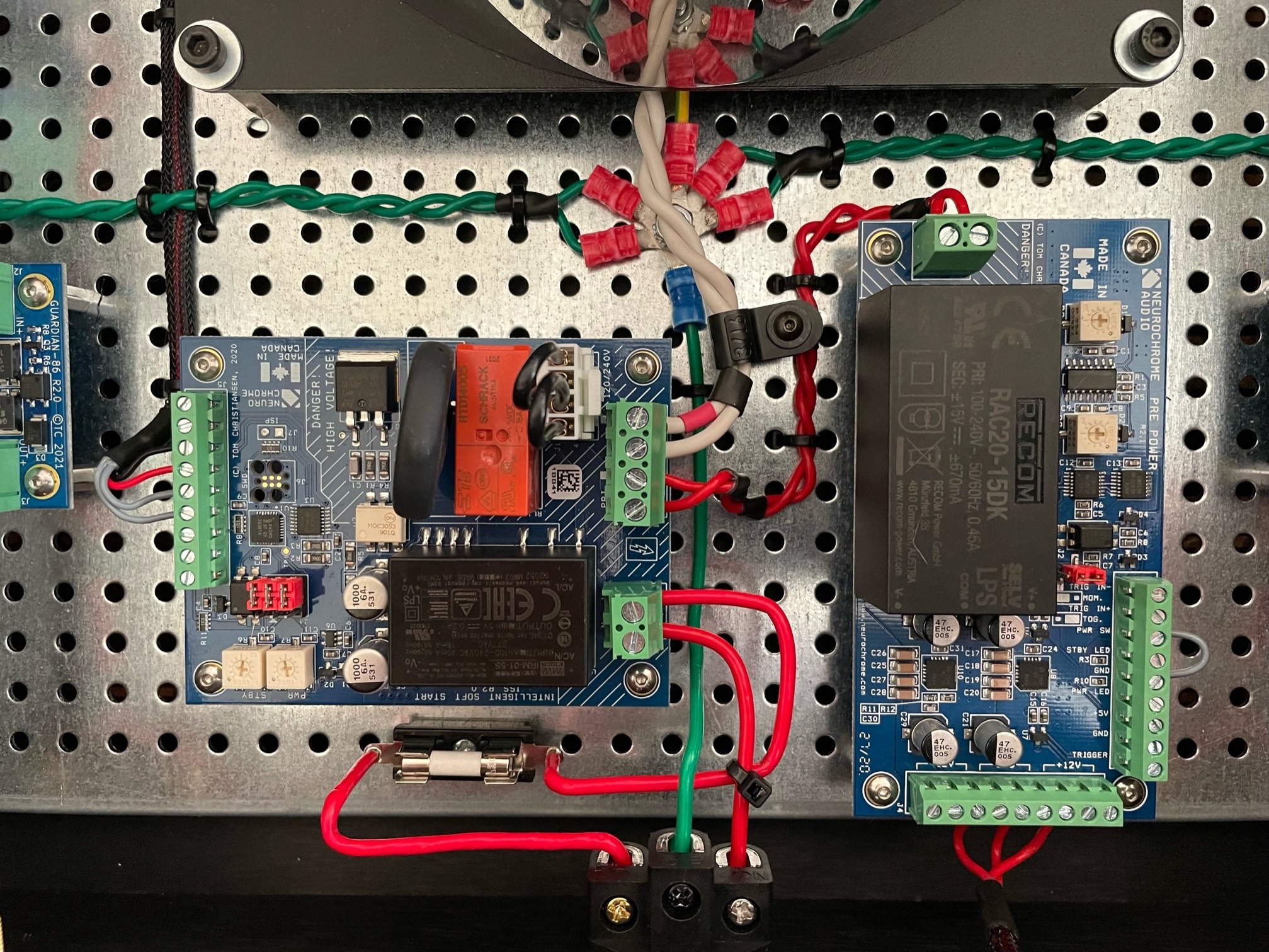

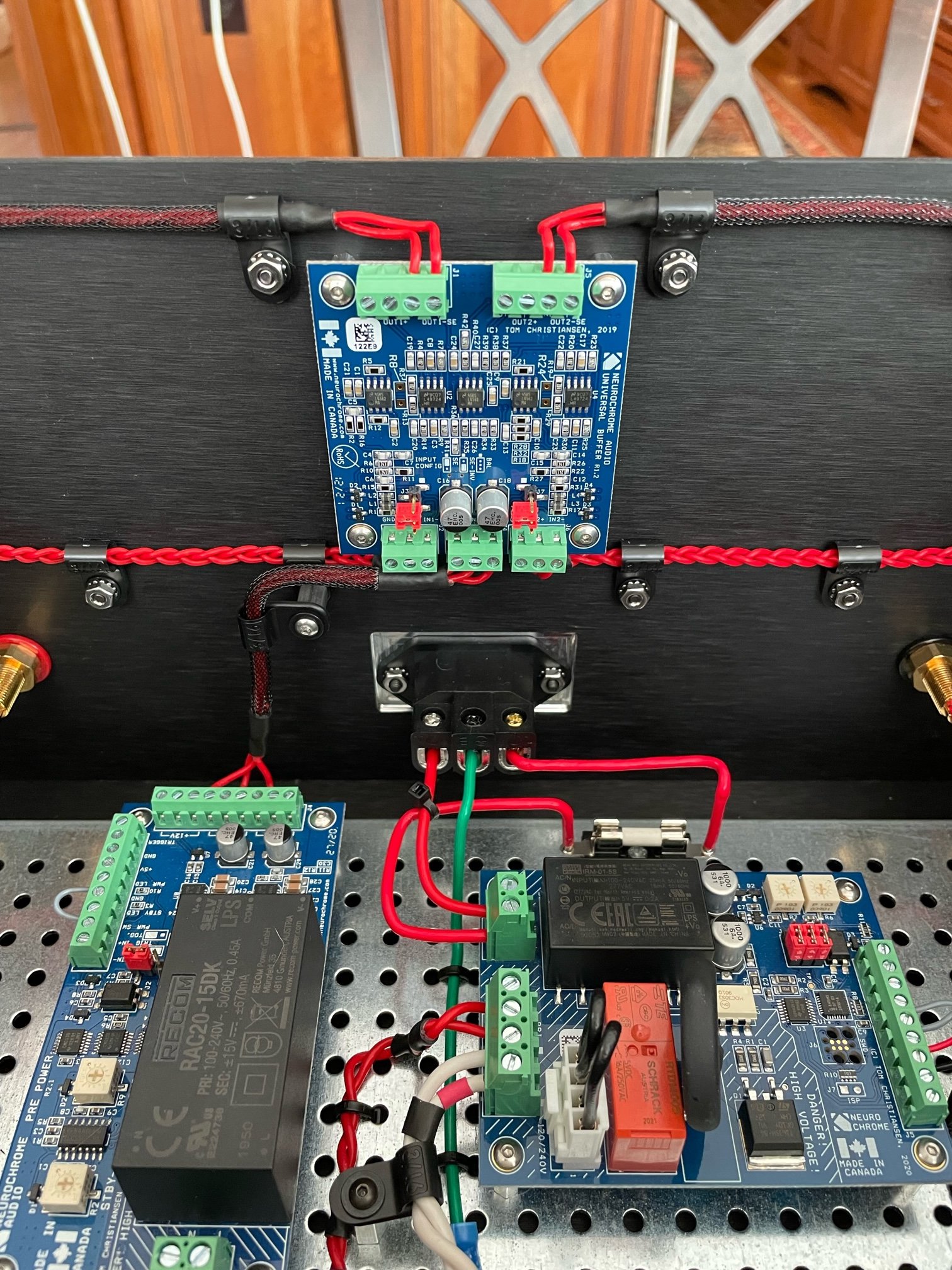

Hello AN39 Club:

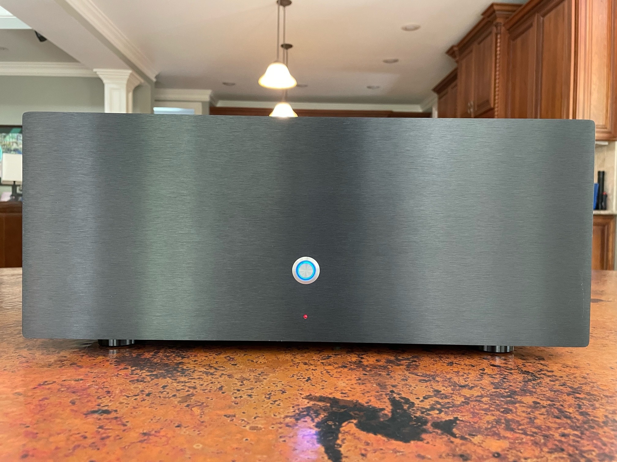

I recently completed my build of the AN39 and thought I would share some of the details. I consider myself very lucky to have had a weekend audition of Anand's AN39 build in my system before starting the project. After hearing first hand the wonderful musical qualities that several have spoken of, it was an easy decision to undertake the build, and to ensure that I built what I heard, I followed Anand's "blueprint" pretty much as he presented earlier in this thread. Here is a list of the items that I did change in my build:
1. 4U-400 Modushop chassis versus 5U-400. Rack was not high enough for 5U.

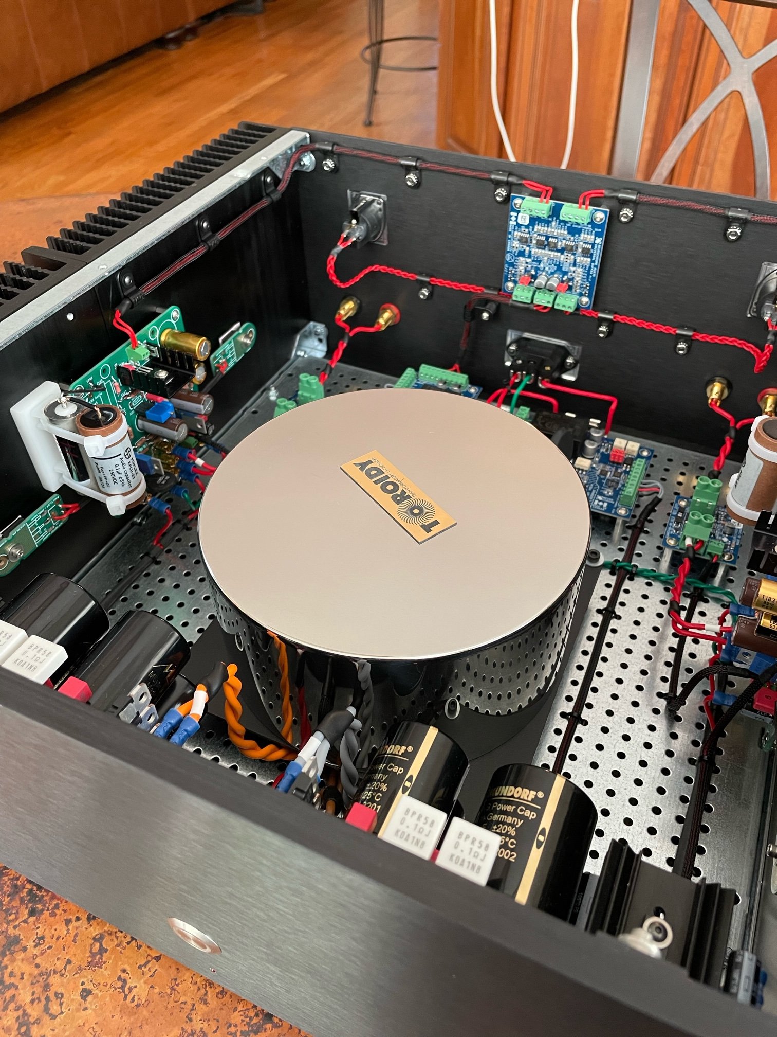

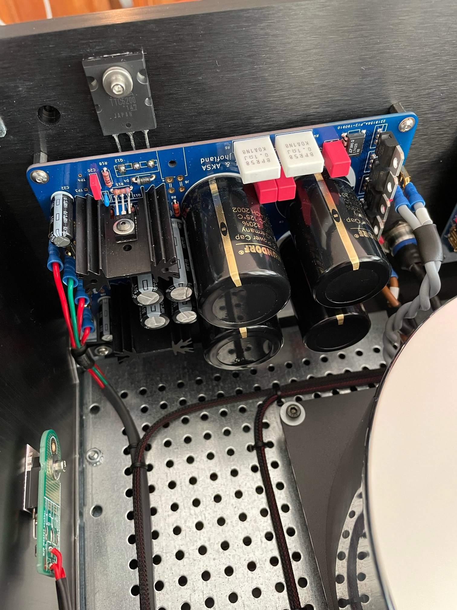

2. 800VA Toroidy with 24V secondaries versus 20V. I was shooting for 28V rails, but with the highly efficient Toroidy and SLB supplies, I ended up with about 30V rails. Plenty of reserve, and I have yet to clip the amplifier driving it extremely hard.
3. I used Tom Christiansen's Universal Buffer (unity gain) and Preamp Power Supply to perform balanced to single ended conversion. Very nice pair that I have used previously in my preamp.

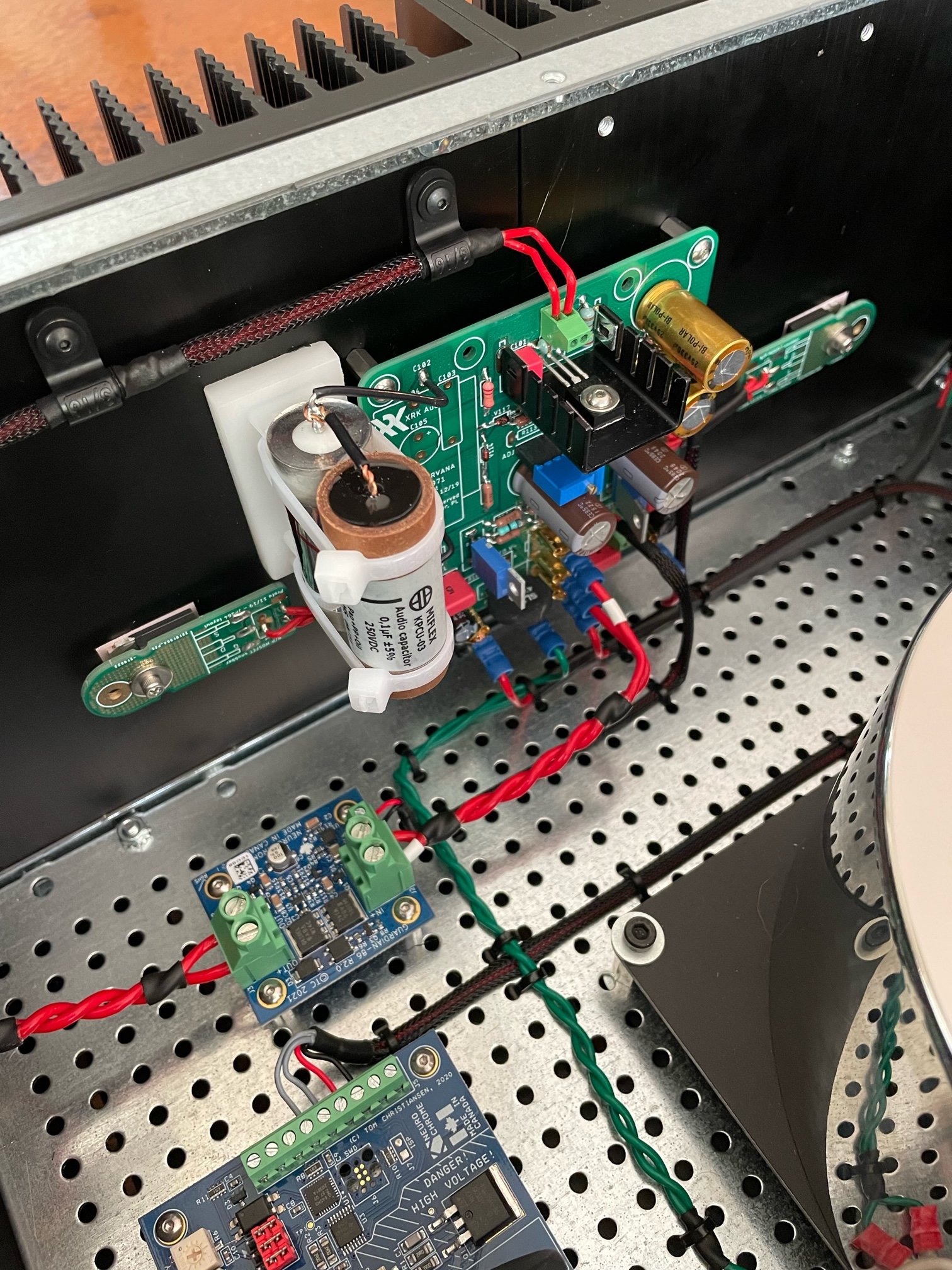

4. Miflex KPCU-03 versus VH Audio V-Cap CuTF to bypass V-Cap ODAM input caps
5. Audionote Kasei versus Nichicon Z for C111 bypass cap for the input LTP stage
Misc: Neotech UP-OCC stranded wire (22 thru 14 awg) throughout
LTP bias adjustment resulted in 2.7 mA per channel, with R/L DC offsets of 3.4 and 8.0 mV respectively. Heatsink temperature at base of Mosfets is running about 50 to 55 deg C. I am really enjoying this amplifier during the short time I have had it in my system. Definitely a keeper.
Steve

Beautiful Alpha Nirvana amplifier Steve!! Top notch attention to detail. Really beneficial to get to hear Anands superb AN, you knew what to expect 😊
Enjoy your newborn AN39!!
Steve,
I echo Vunce's sentiment - that's a beautiful build you got there. Well done!
What speakers are you using with your Alpha Nirvana amplifier?
zman01:Steve,
Thank you for the compliment. I am running GR-Research OB NX-Oticas with two triple 12-inch OB servo subs and two Power Sound Audio sealed 15-in subs.
Indeed, this is THE build that all builds will be compared to!

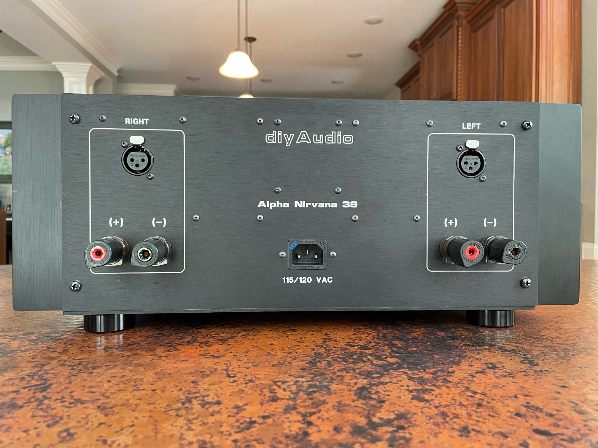

Hi Steve,
I echo everyone’s praises of your build. Superb workmanship. I think with 30v rails you may need to fix the label on the back panel though. It’s probably closer to 49w!
Congrats!
Congrats!
It needs a dual rail PS, single +24V won't work. It is possible to do +/-24V with SMPSs, you just have to be careful you choose the right SMPS and wire them correctly https://www.diyaudio.com/community/threads/alpha-nirvana-39w-8ohm-class-a-amp.344540/post-6983476Hi,
