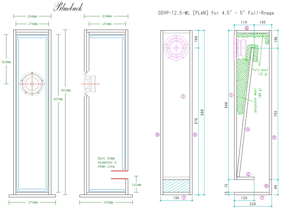

I always try to find a suitable length for the bass reflex tube.
If I make it shorter, the lowest frequency will be higher. If I increase the frequency of the tuning, it increases by a few db. It is important to adapt this to the room you are playing in. There will be more bass but not as deep. I can sacrifice a few herzt for a slightly stronger bass. Or on the contrary slightly weaker and longer bass reflex tubes but go deeper.
A pure matter of taste, it is the amplification of the room and the placement of the speakers that determine this.
If you put them in the corners, you have a strong amplification of the base.
It may well be; with those vent dimensions (slightly shorter than the panel thickness specified) it's tuned to about 57Hz. Assuming a regular voltage source amplifier & speaker wire / connections adding about 1/2ohm series R, then it will be on roughly a +2.5dB peaking alignment at Fb under anechoic conditions, although room acoustics etc. being what they are, it may not be quite so excessive in practice.

Now I have installed 3.8 mm long bass reflex tubes in the Bluebuck speakers. Still a bass that is relatively strong in my room.

Bluebuck is about the same size as my TQWT.
CHP90 mica seems to work well with this size box.
