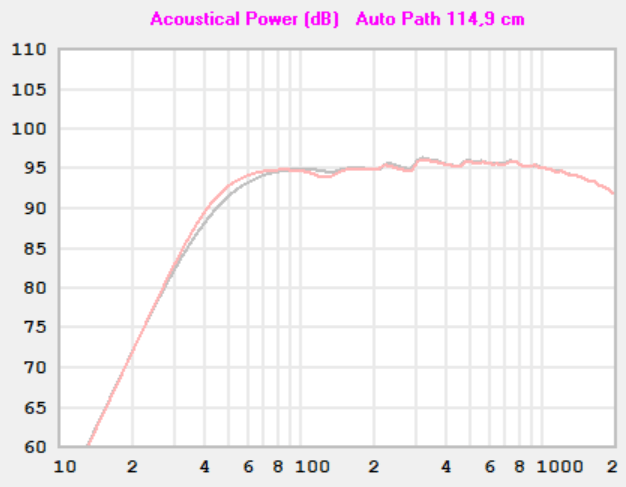

Which way to go with CHP-90. Red or Black line in hornresp
I think the red line either stands for smaller box volume or lower tuned bass reflex tube (longer tube).
Black line is the optimal tuned box.
It's hard to say which one is the best.
I vote for red.

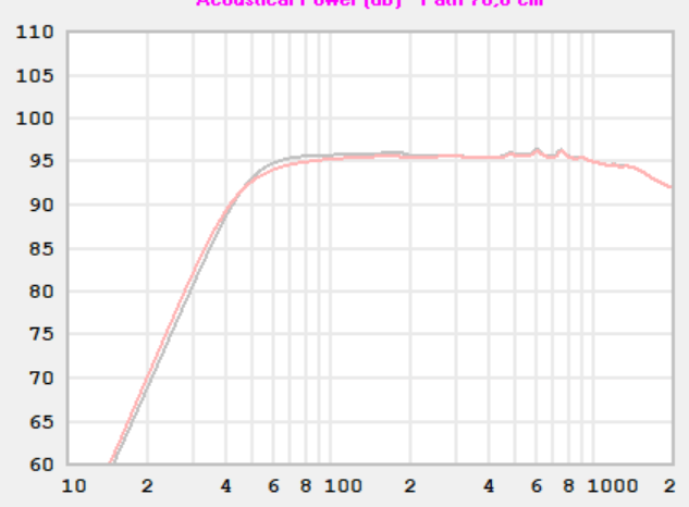

Unfortunately, there's no such thing as a single, universal 'more room friendly' response. It depends on the room construction & acoustics, the speaker's position in the room and that of the listener, the material played and (not least) individual preferences. Without knowing these, it's impossible to give a particularly useful answer, other than a variation on what I said before. In this case, the alignment represented by the grey line, being more highly damped, may limit excess gain if positioned near boundaries. The ~130Hz depression only apears to be about 1dB & its effects are likely to be completely swamped by variations in room acoustics & positioning; you'd likely get far more significant variation by moving 1ft in any direction.
