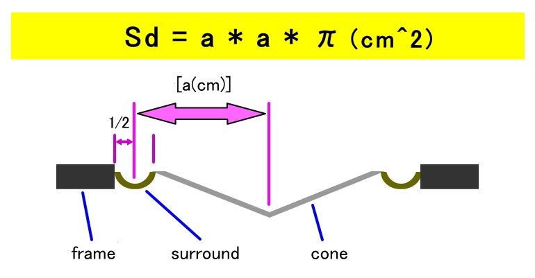

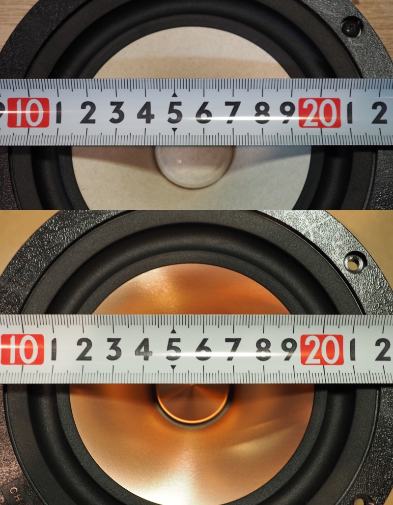

CHP-90 has an Sd of 85cm^2 relative to the Alpair 10 / MAOP 10 range which is 88.25cm^2 - 90cm^2 (depending on where you take your measurement on the surround). Assuming the former, then it's 96.32% rated Sd of the Alpair 10 series, and 170% of the 7.3 or P7HD, where rated Sd is 50cm^2.
Apologies for the confusion. I sometimes still get confused with the marketed diameter measurements of each Markaudio driver. The cones themselves are usually smaller diameter than what they market it to be (as a whole)
Come again? Sd (total emitting surface area) is always published TTBOMK, and for all companies, that's taken as cone plus a certain amount of the surround diameter. How much varies a little depending on surround design / type & its contribution to the radiating surface, so when in doubt, Sd is our friend. 😉

Ignoring manufacturer for a moment & speaking generally, the amount of surround included can vary with compliance, form-factor etc., so as a broad rule, I would suggest sticking with published / rated Sd & where relevant use that as a basis for incorporating into other measures. Same with Mmd; if nothing else, most reputable manufacturers get extremely close on this out of necessity, so it's one of the more reliable / consistent values available.

From outside edge of surround, but subtract dustcap ~ 85.
Using wchang's calculation method, MAOP11 would be 117.14 cm^2.
The published value is 107.5 cm^2.
