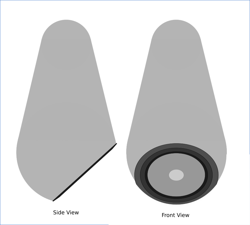

The round shape of my proposed pods isn't ideal for width and depth being the same, but for enclosures that will be rotated during positioning I like them being symmetrical around the vertical axis. However, on reflection there is no reason why they need to also be symmetrical top-to-bottom, so i could change that. Probably not a great benefit, but also no real penalty aside from being a tiny bit taller and (arguably) a bit more elegant as a result so seems like a reasonable thing to do.
For example: Rather than:
Thanks, zman01. Yes, i think you're right. Maybe it would be harder for standing waves to become established, and also the longer cone might offer slightly more opportunity to damp things.
Though the cone isn't up to the standards of the B&W nautilus (or similar), I guess every little helps.
Perhaps mine could be elongated a little more than in my image, and there could be an angled plane put behind the driver to reflect more internal sound upwards into the vertical cone, and less of it directly back through the driver.

Have you got any dimensions of the enclosure as of yet?
From the visuals, the elongated shape means they might end up being quite deep?
That much isn't clear. You seem to be basing this on not being able to manage what is in the box. If that is so, couldn't this be making things worse?I guess every little helps.
Nothing is really set in stone as yet, but I don't want them to be larger in girth than necessary (since larger cabinets quickly become intrusive given how close up they are). So in order to house the drivers, which have quite a large diameter for their modest sd, the bottom/spherical end of the cabinet will need to be around 200mm or 8inches in diameter, and ideally not much more.Have you got any dimensions of the enclosure as of yet?
This probably isn't large enough to bring the optimum diffraction benefits of a small driver in a big sphere, as in that classic work by Olson that gets pictured frequently, and the cone stuck on top also changes it of course. However, it is at least quite a rounded shape with few sharp edges in most aspects so I hope it should be reasonable.
The height is more arbitrary; I'd imagine the pods as being maybe 300mm 12" tall, but the new cone shape can go longer without seeming big, as such. So maybe a couple of feet tall or so wouldn't be out of the question.
Yes that is a possibility; a small nod towards the conical idea might be so half-hearted that any real result is pointless, and in some ways worse. For instance, the 2xhemisphere+tube shape is inherently quite strong, used both for pressure and vacuum vessels for instance, so diverging from it might be throwing something good away. I don't suppose a gentle taper would lose much, but a tall thin one might and could even create some undesirable pipe-like behaviour.That much isn't clear. You seem to be basing this on not being able to manage what is in the box. If that is so, couldn't this be making things worse?
Though aesthetically I do quite like the cone or teardrop shape for a hanging speaker, so it is something I'll want to read up on before deciding very much; to see what sonic benefits such a cone might be able to offer (if any) and how far one might need to go for effectiveness. Rightly or wrongly, I've got the impression that the more elongated ones involve a different way of managing things, rather than not being able to, but I could well be misguided about that at this stage.

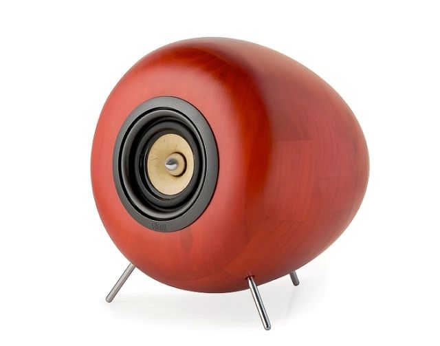

Attached is a pic of a commercial offering which looks like a smaller and more rotund version of what you are trying to make?
From eye-balling the illustrations it looks like you have 2.5x - 3x depth vs baffle diameter; so if the front baffle is 8" in diameter (including the round-overs), you will have a pretty deep (and big) speaker at 20"-24" deep.

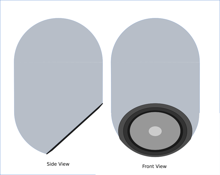

Yes, height is less of an issue than girth but it is still not exactly desirable; shapes closer to spherical are indeed more space-efficient.
It may be that I decide to back off again and go back to my original pod shape, but possibly just slightly tapered - simply to avoid exactly parallel walls. Which is not far from your picture there really. Sort of like an egg or stylised beehive, perhaps
Okay, I believe that interesting ideas are leading me astray from the main aims here. So I've decided to go back to the essence of what i wanted and test the drivers in a simple sphere, to see if they'll work for me or not. If not then fine, that would have answered the question and something bigger and/or more elaborate would at least be justified.

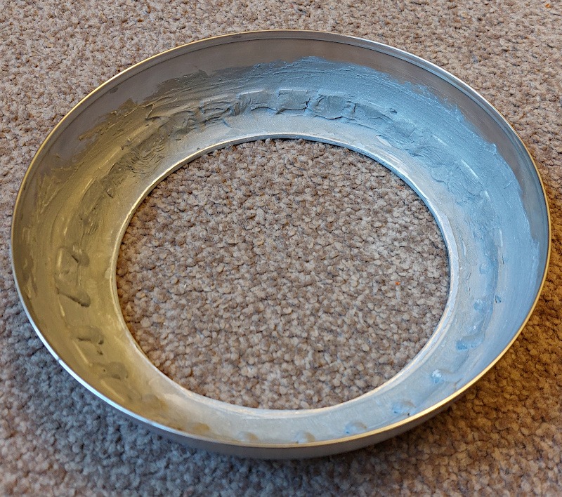

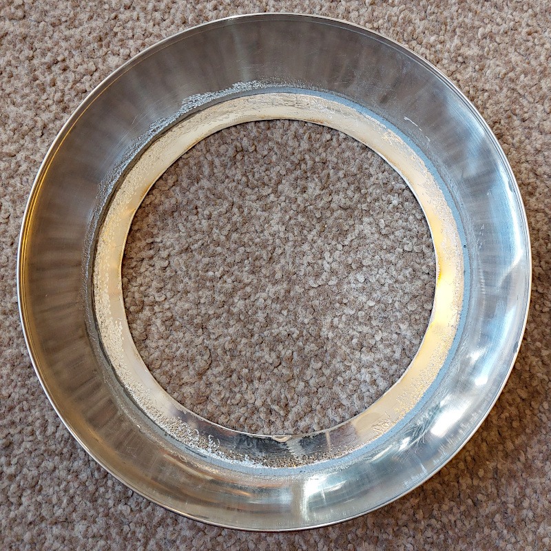

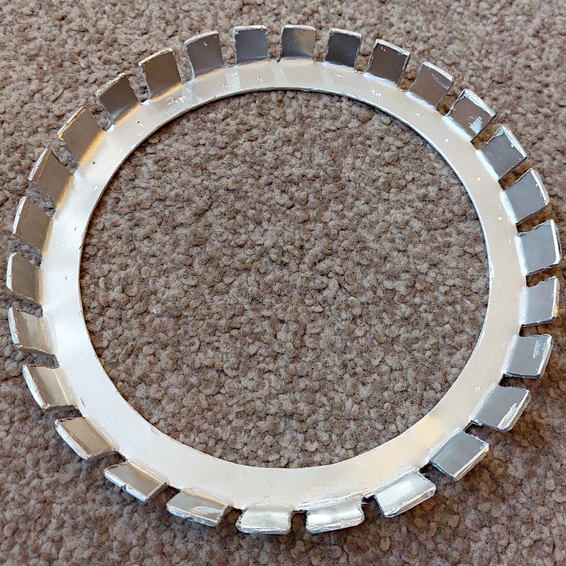

At last, I had a bit of time to start working on this. First the bottom of an ikea 20cm Blanda bowl was cut off, at a diameter of just over that of the 11ms. Then a stainless steel ring was glued in, using JB-Weld epoxy adhesive, to provide a minimal baffle or mounting for the driver.
The ring is quite thin but the width of it is sufficient to return a surprising amount of rigidity to the cut bowl.
However, such a thin baffle is quite flexible in one direction, and only offers a tiny edge to glue. So a thicker aluminium bracing ring was made, partly to prevent flexing of the baffle and partly to transfer forces between the baffle and bowl over a much larger contact area.
The bracing ring wasn't a particularly close fit, so I decided to bond it in using something cheaper than JB-weld. Specifically, some 'Big Boy' ultra-tough metal filler (there might be better options, but I already had it), which can accommodate a little flexing and can bond to aluminium and steel. The surfaces are fairly large and were thoroughly roughed up and cleaned with acetone just before-hand, so hopefully the bond will be good enough.
It looks a bit crude (because it is), however the result is pleasingly rigid. It is also very dead-sounding when tapped, which may not in any way simulate what a driver will do when playing music, but I still find it reassuring that it doesn't want to ring.
This will be repeated for the second of the two speakers, and then in some way a second bowl will be glued to these, in order to make a sphere (albeit truncated where the driver sits).
By my calculations, the internal volume will be a little under 3L (after the truncation) but the 11MS will take up some space; i can't see this specified anywhere but I estimate maybe 0.35L - leaving me with about 2.55L. Some more may be lost if I add bracing and wall-damping but some effectively gained when stuffing is added, so it may roughly even out.
If so, then the Qtc should be about 1.0, which doesn't seem unreasonable to be adjusted by EQ. That is especially so at the low SPLs intended - keeping a cap on the power needed (which would otherwise be the limiting factor), and perhaps even benefiting from more of a lower-frequency lift as indicated by fletcher-munson curves.
