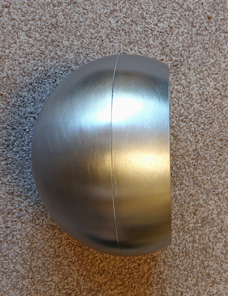

I realised that I forgot to add any progress to this enclosure build. There isn't really a lot to it, just the front part mentioned previously had some holes drilled and nuts glued to the rear of the baffle, to provide mounting for the driver, and was then joined to a full bowl for the rear.

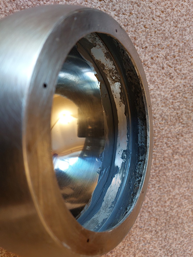

This was done by bending a metal strip into a hoop. It was bonded in place using JB-weld epoxy; the hoop was snug enough that the two halves would stay firmly together even before the adhesive was used, so I don't believe there is a lot of demand placed on the bond.
I stuck some self-adhesive bitumen on the inside, though it probably didn't need it as the assembled bowls don't ring like the open/half bowls do. Then a layer of felt and then filled with hollow fiber stuffing
