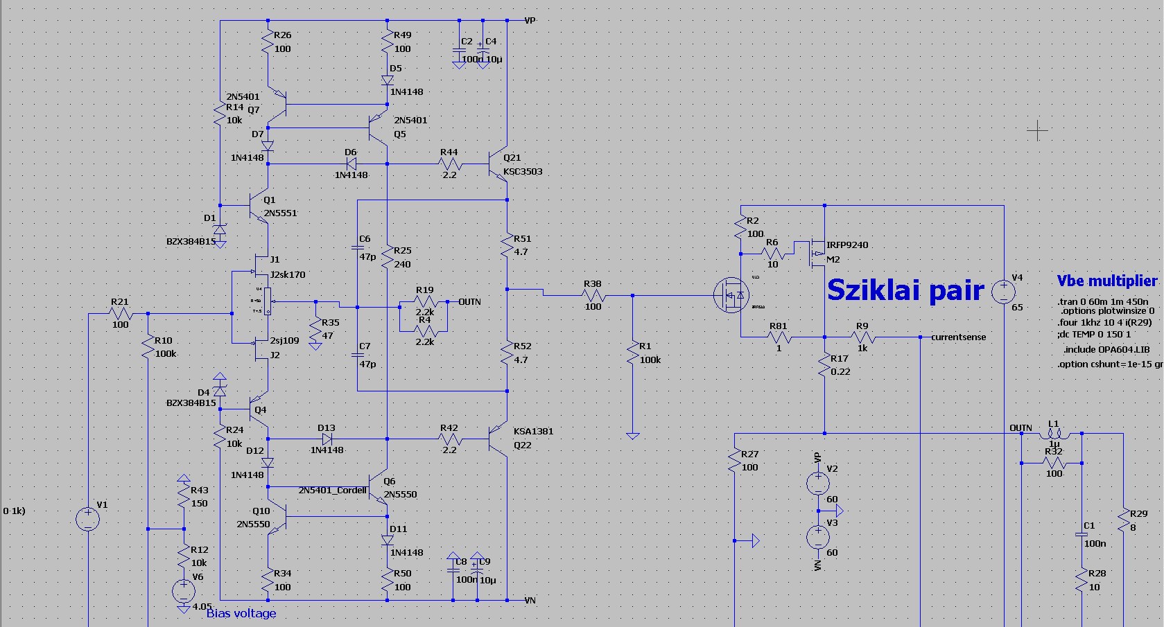

hi Kees,
Be aware that the input capacitance of the FETs on Compound Pair can be significant, and thus a (relatively) high VAS current should be provided/available. Not sure the 2SC-2240 configuration can provide sufficient current.
Good luck !
Hi Piersma
I am aware of that, the input capacitance of the irf610 is quite low, but because it is a drainfollower we have millier but the mosfet does just 1 x so that is not a big issue, if afcourse I am right here, miller is a effect from a transistor with gain. using cascode here is not a good idea here.
Replacing the smaller 2sc2240 for something more beafy is afcourse worth
considering.

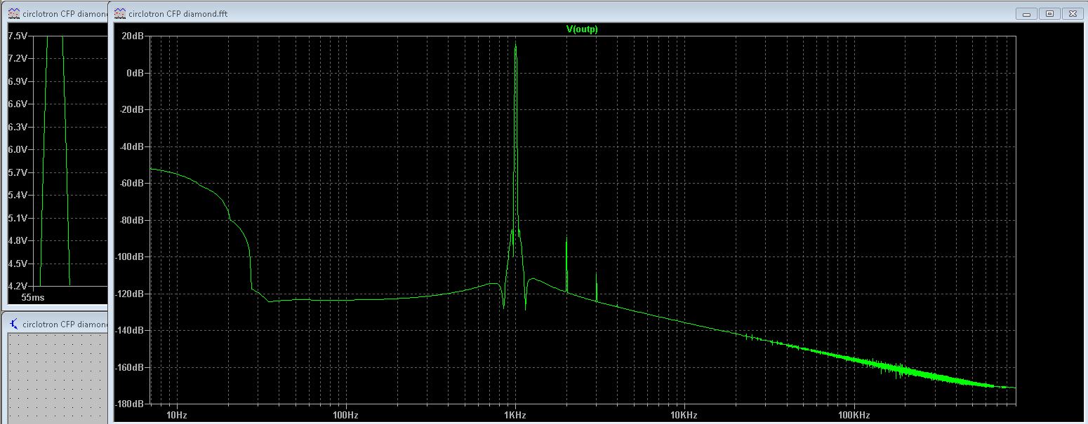

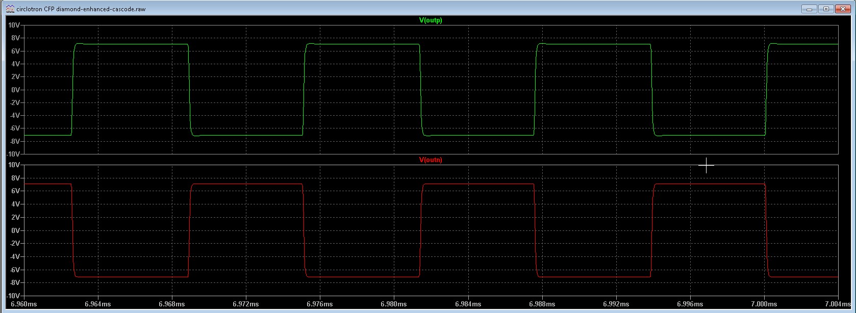

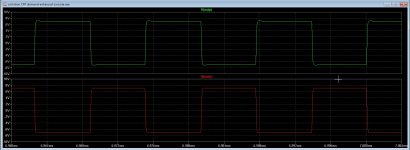

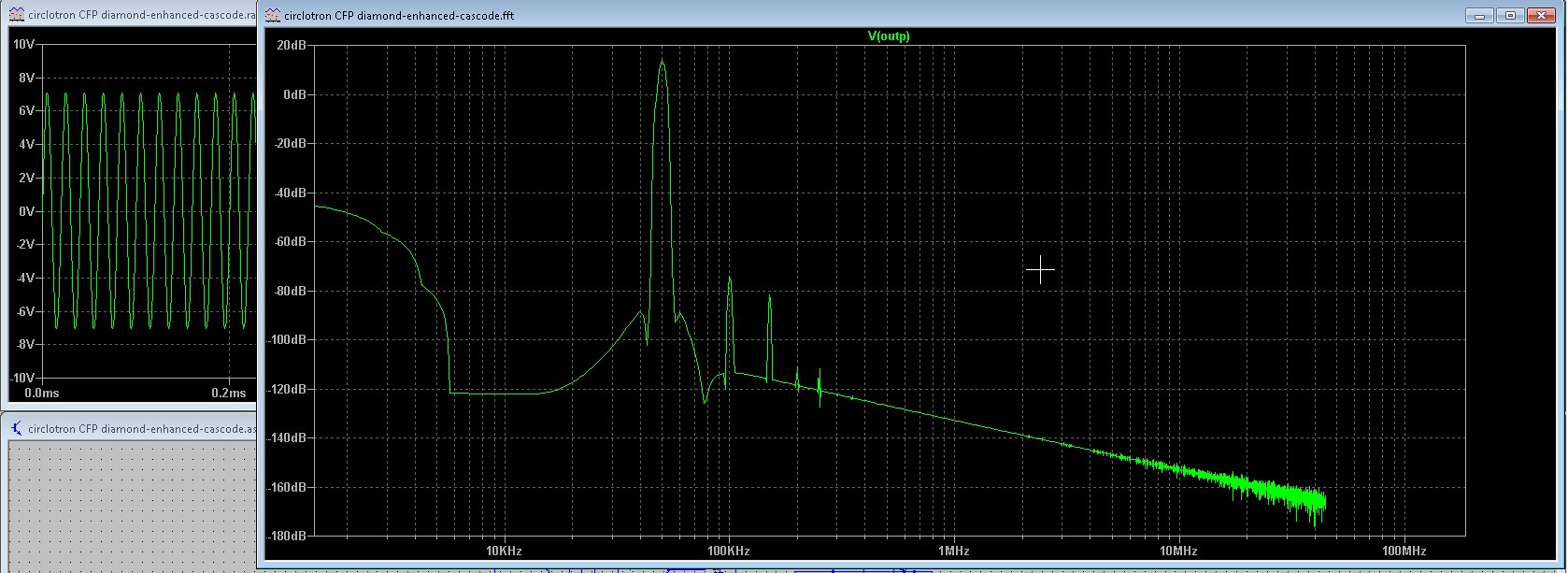

Here I have used a diamond buffer from a old amplifier for current feedback, did need adjustments and such, I have experience with this feedback topology in positive manner. It has a friendly harmonic content. here are the plots of it.
For X it has a friendly respons.
regards

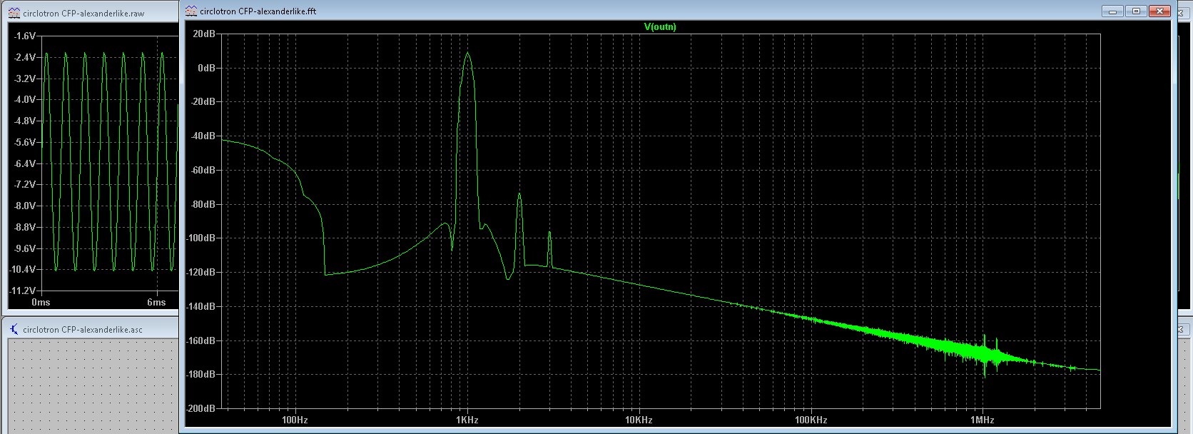

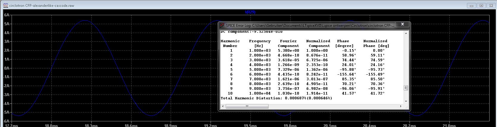

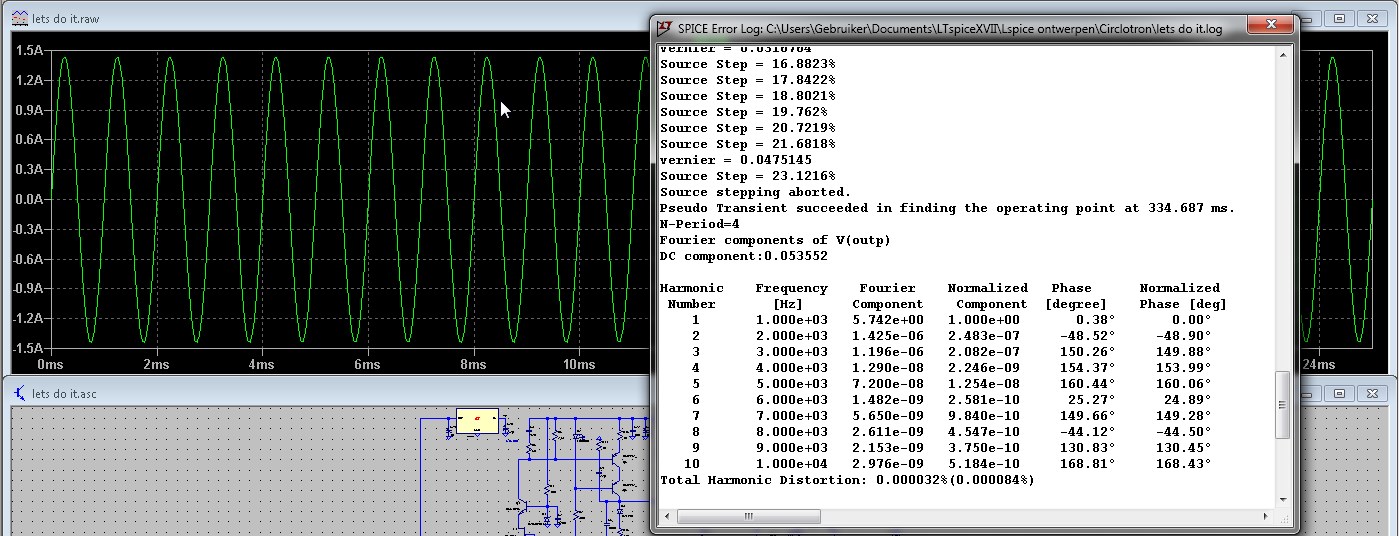

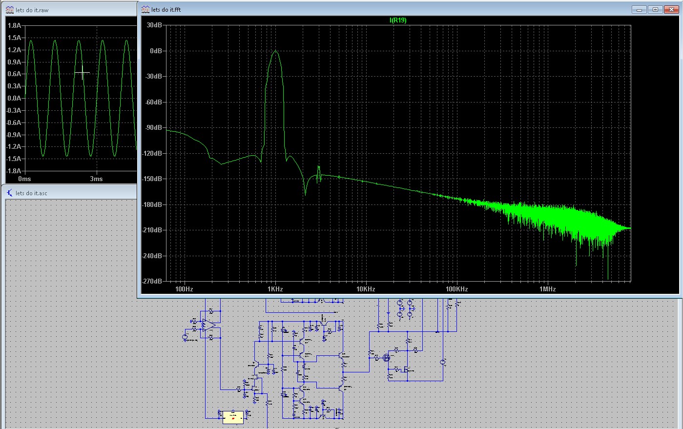

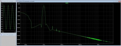

The simulation has a error, is solved now, the output transistors did clip long before the drivers did. cause was a bad model in irf library.
now it is a lot better.
full power alexander current feedback version sim. feedback can also set local.
regards

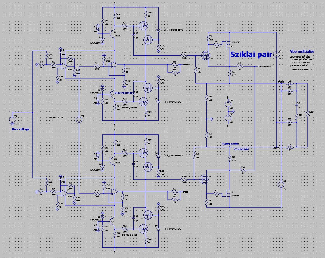

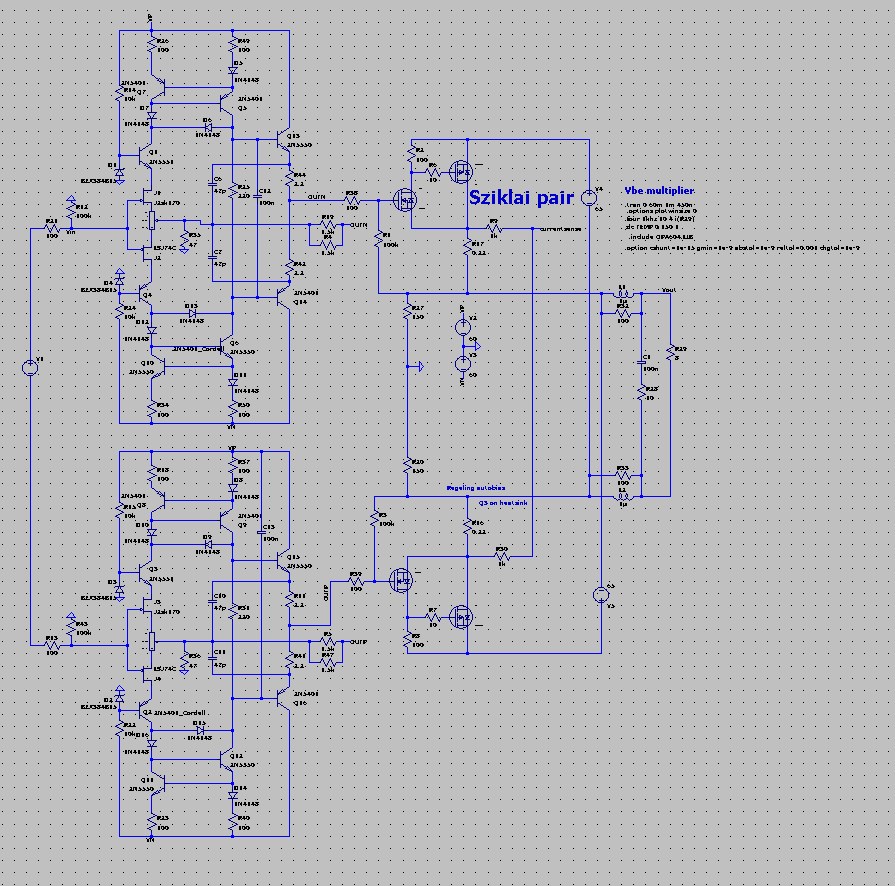

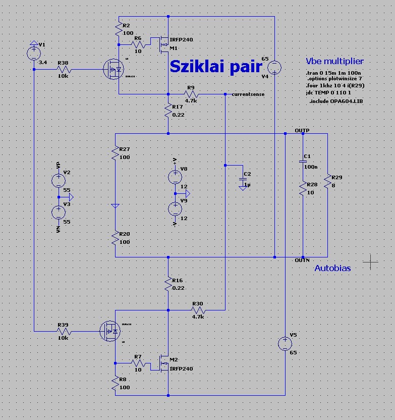

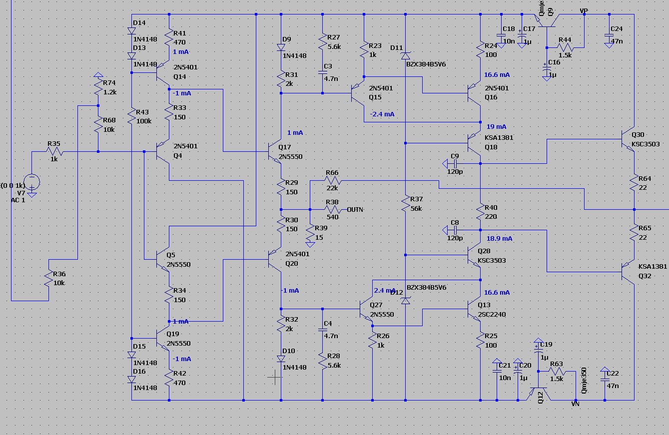

I have some questions, people here can answer, I am not that good in the caqlculating part or what it does.
I have need a idea to set up the bias, I do this by put a voltage on the input transistors, however it is very sensitive, 20 mV is enough to flipdriver section to one of the rails.
Also two resistors are quite of have influence on the setup, these two resistors are on the driver transistors of the sziklai pairs, R1 100k if I do lower it sensitivity get lower and better, when put the resistor on the outputs of the circlotron it get even better but have then some offset on the outputs who cancel out in fact so not a problem but autobias gets confused.
I let see one half of the amp, R1 is one of these resistors.
I need a idea of setup the idle bias here, it can also be done on the feedback part, but there it is current feedback so it needs adjusted the right way. Because the circlotron is floating and have only ground reference resistors can be make problems?
Idea,s are welcome and thanks in advance.
I did use symetric driver sections because of this does a lot better then half end drivers.
regards

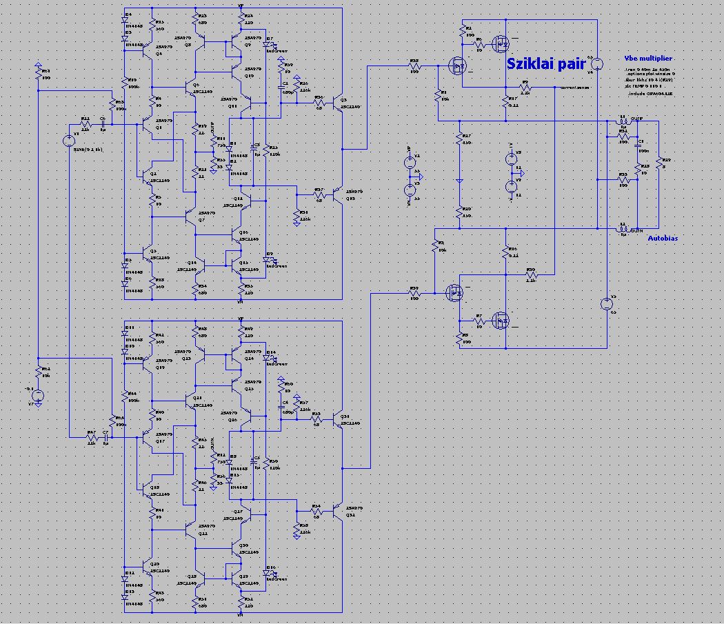

Hi Ultimate
Thanks for respons.
I have some other kind of drivers, using balanced drivers the normal way, and it is current feedback, so, now I have done using voltage to the input, or the feedback input for that mather.
I go use a autobias, so need one point of input, to get the circlotron idled I do need some positive volts, like yours also do, when I use a pnp version sziklai I need opposite voltages to get it in idle.
The amplifiers who use this in normal amps do use voltage on the input also.
I only did see that it quite sensitive when approach the middel voltages, 10 mv is already enough to swing big in amps, so i need a divider here.
First what I go do is test the compound in real and make a driver board, these can behave nice with thermal runout troubles. Simulation is not always oke, I have everyday a other outcome, then low, then high distortion., maybe I have setup ltspice wrong.
Current feedback has some more distortion as voltage feedback, but I like the sound more.
Your idea of remove a resistor and use that as idle adjust point does not work, because the driver is from itself already balanced x 2. I just need to put it some out of balance getting a voltage for idle, as the designers did where driver came from.
regards

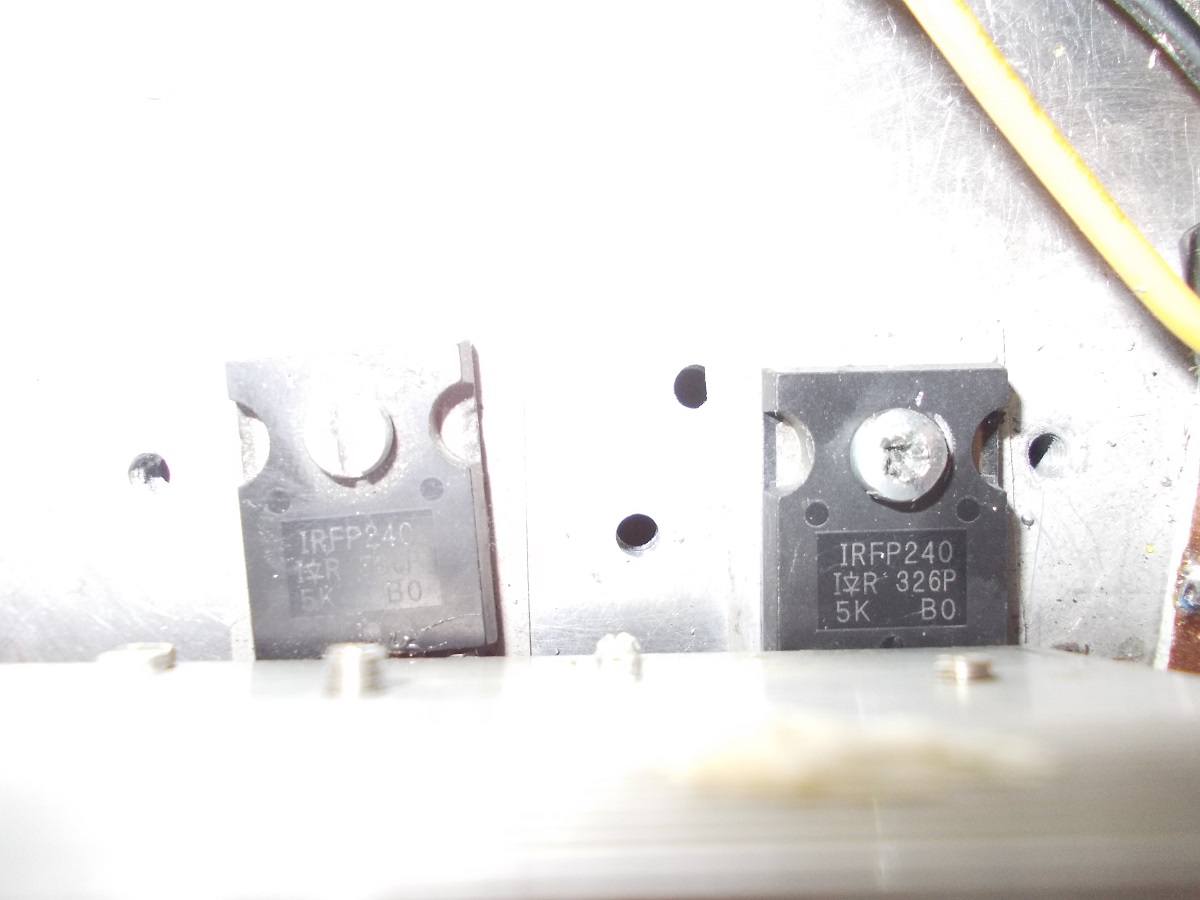

Hi Piersma
Maybe you can provide a answer here.
I did testing only the compound stage setting a bias to it.
Complete failure, it oscillates on a very low frequency giving pulses who are very fast, this do start when I start the bias flowing.
In simulation compound is rock solid stable. I have some idea, I have fake parts.Here some pic,s this is very strange, I get also different bias values, one side is 100 ma then the other side is 120 mA both get same voltage through 1 % resistors, quite possible the irfp240/irf9610 is fake being ibgt,s not first time.
See scope pic, these pulses are big voltage and very small. In sim it does fien see pic, also square signals looks very nice, no overshoot. But I now sim is not always trustable, models need to be fine.
regards

I am sooooooooo stupid guy, you will never gess what was wrong, as the saying is the simpler the problem the more complicated the solution.
I have forgotten to put washers between the small mosfet and the heatsink causing the drains connecting together. I have search, search and now found (after alcohol was evaporated😀).
The result, it act a little as a lateral I have now put bias on without any correction servo, it pendle bewteen350 and 500 Ma. the driver mosfet needs a own heatsink, together do work as a normal vertical mosfet it will run out of steam.
The bias you see on picture is cold, but after heatsink is 68 degree the bias is 620 mA reason is the small heatsink on the drivers who is working in class a and get hot (use a small heatsink from pc videocard), if you take care of a good cooling of the irf9610 or the irf610 for the other positief version with a pmosfet it will work quite good, just a small extra security can be used, I do that tomorrow, because it is now still 36 degree inside mie house, we have a severe heatwave and have still some days with 35/38 degree to go.
What do I feel stupid today, the compound is rockstable, I was the error..

Busy with the servo, temco needs to get good, the mosfet compound has very low temco, but still need it, looks like I need a special one, so I go look at transistor diode in cascode.
I do set bias by voltage on driver input or feedback to get it to -3.4 volts needed on the output, but ideas are welcome.
What I do see with the front end, it does flip to negative rail on it,s own, is this because of the models are not acting as paired transistors? I thing yes that is the cause, I need to inject 4 volts to get it at zero, I use that also for the bias, but do now find out or there are better ways, injecting on the feedback node do not much, it is low ohm there because that current feedback, maybe injecting a current from a current source will work, or afcourse other places in the circuit, enough places there but distortions need to stay low.

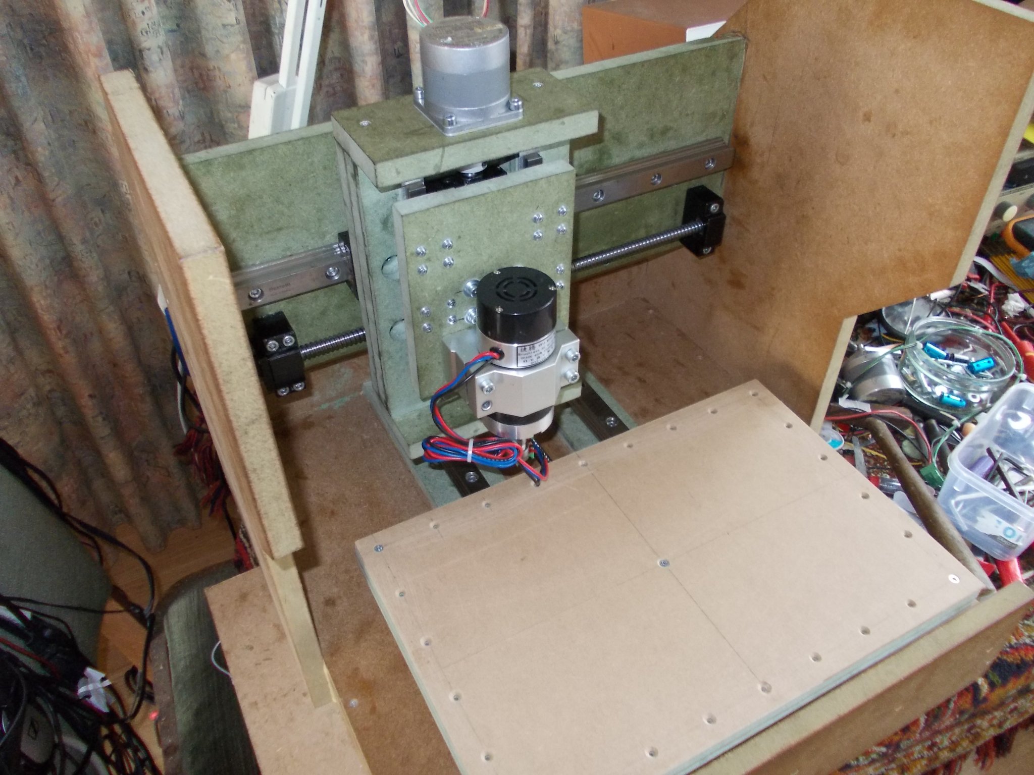

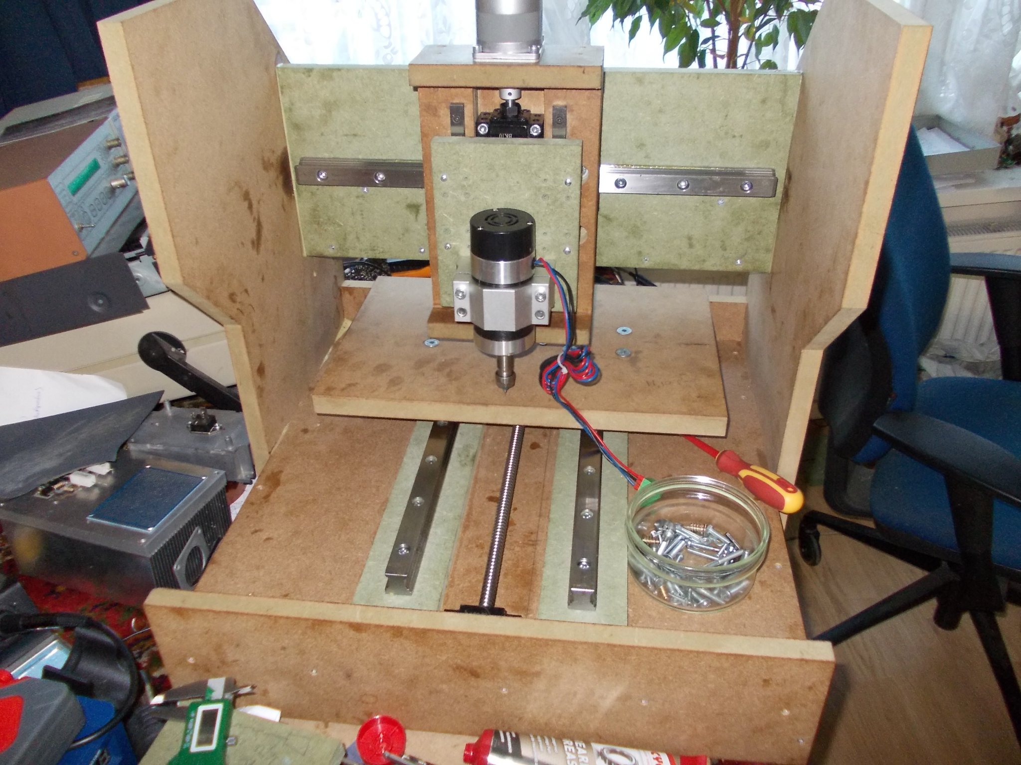

testing stepmotor for cnc, sorry for the singing microstep sound. - YouTube
Testing the Z axle.
testing the spindle 20.000 rpm.
chinese spindle start up. - YouTube
Reactions: huggygood
Be back here and go on from here about the circlotron designs. This version is
more simple. For the questions about the pcb, I have not design yet, just keep
following it.
Now I am busy with the pcb cnc build. Nice sound that mircostepping, Sound is a little bit loud
but that is because of the camera little to sensitive ,mic.
