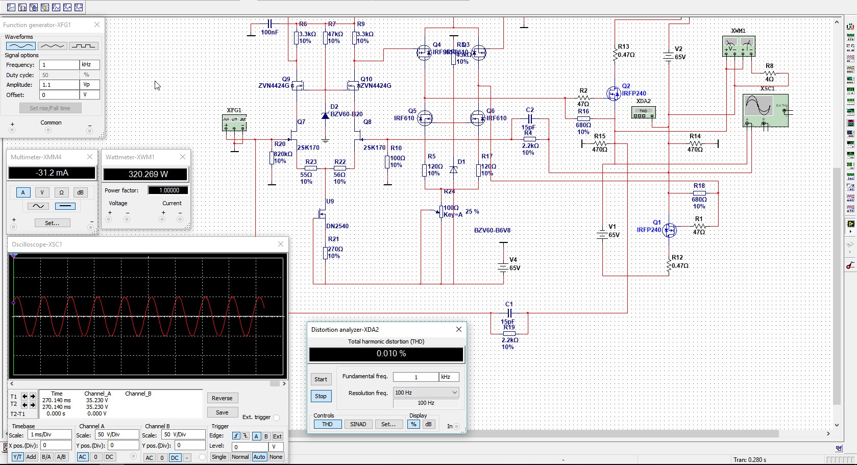

The diagram that I would like to try is very similar to this one, double differential and mosfet without driver, but with generators in the 2nd floor I can not polarize the mosfet, how did you do it here ?
I tried to add resistances like the 680 of your schema but it does not work

Here some changes
You need to set idle current drivers higher, use of a current source is needed then to tune voltage for output stage idle current.
if you plan using laterals then you can build this without the danger of temp runout.
regards
I have set it up for 100 mA idle in output, but when build, I think you have to experiment with the pot and the resistors.

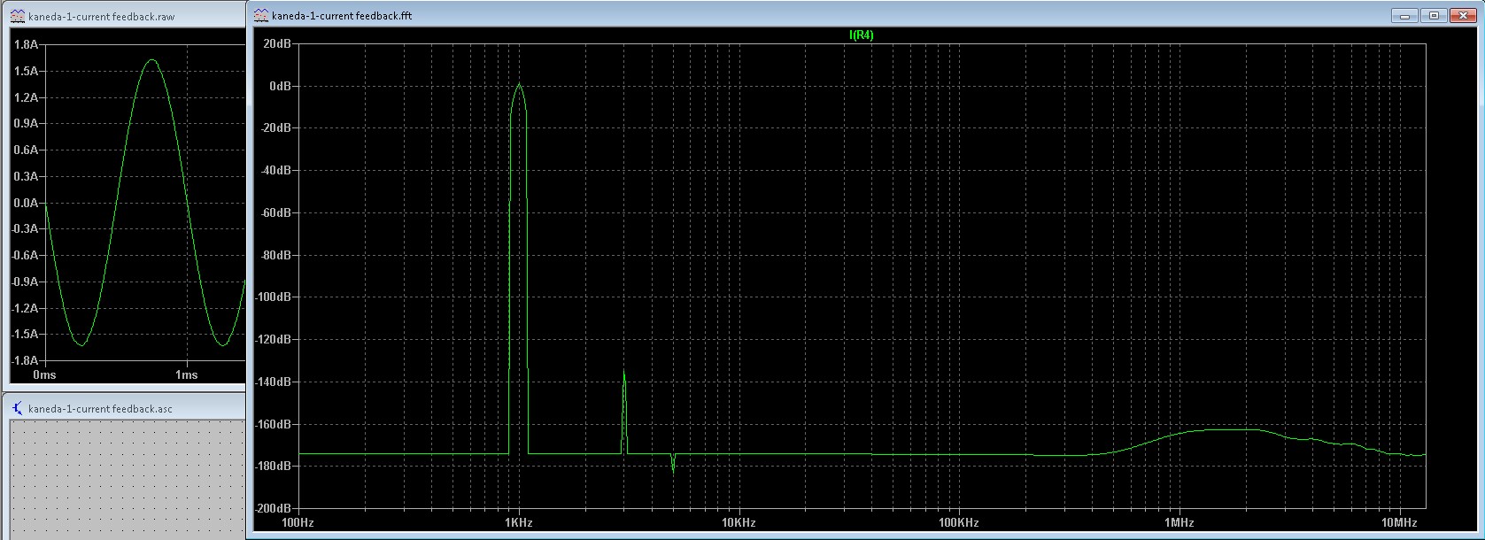

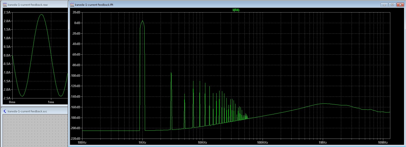

The driver mosfets are on 34 mA here you need class A because how more driver current hpw better the distortion specs, special for IRF240 type mosfet you need even 50/75 mA idle, and cool these drivers, mine are 80 mA with verticals, this because the gate capacitance is high, I have the driver also on the heatsink and that works fine, you have laterals, and I do not now what happens as the drivers are also on that heatsink, just try, otherwise a NTC is needed into the resistor network in idle pot. But try first, and go built it, you will see things are different from simulation, but a good start, the idle pot needs max resistance for start otherwise you get uge idle curent and destroy the fets, I have on sim setup resistors so this is limited and more save.
regards

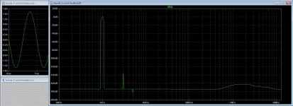

The versions with the current feedback you see clearly the differences with voltage feedback, youn have slightly more distortion but als have a uge bandwidth, current feedback is mine favorite for this, it has not the limitations of voltage feedback, your resisistor network on feedback I do like also, maybe this give a result on the current sources.
The cascode in the Jfet stage is needed as the voltage is higher then max Jfet drain source, so this is always a good idea.

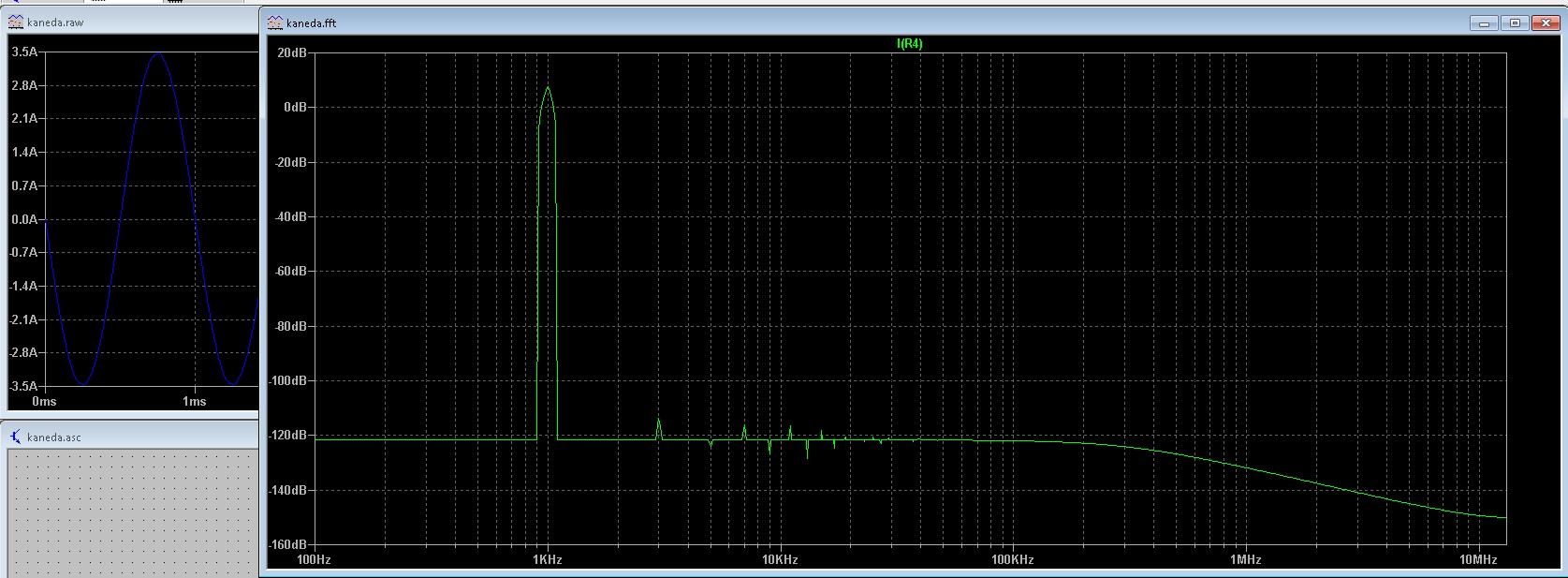

Here the lateral mosfets have 200 mA idle, distortion with almost max swing is -100dB, but because of the current feedback you see down the -100dB more
harmonics, but that is not important as it is so low down the scale.
Idle current has uge impact, see the other -120dB version plot.
regards
