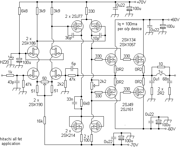

Guys, I would like to build this amp, have the components. Can I ask where or who might have pcb's or gerber files available and what schematic was used for the particular pcb. I see many different circuits throughout this thread, many thanks.

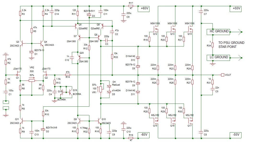

The last build done here by lganymis apparently use Alex s PCB wich lack a late update that can be easily
implemented in the board since that s just a 220pF cap that can be soldered in parralel with the relevant resistance,

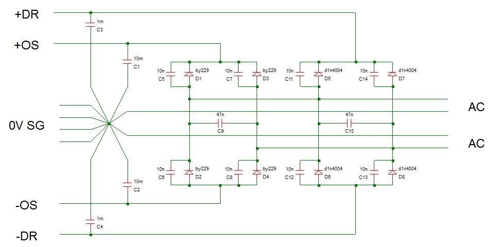

Here the updated schematic that include this cap with the reference C14 as well as the PSU with dual rails
for the driver and output stage, a single pair of rails can be used but then the driver supply voltage will sag
along with the OS supply voltage, the dual rails allow the driver to benefit from the peak voltage of the PSU
permanently wich increase the output power capability.

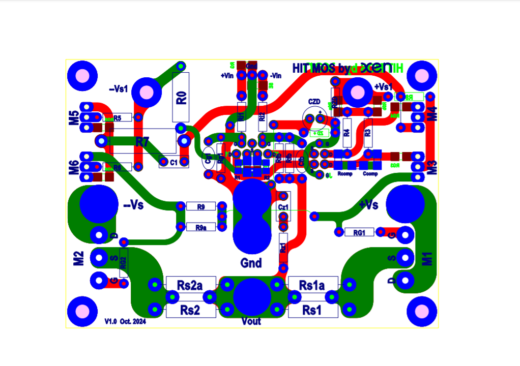

We have the PCB design for the circuit in post #1, i.e. the titled circuit.
We also have both the original devices, as well as proposed substitutes.
But as usual, we shall not publish until it is built, fully tested, and auditioned.
We shall be using double -die Exicon lateral MOSFETs for the output stage.
Simply because we have them for other projects (incl. The F5XL).
BTW, only interested in the original topology using JFETs and lateral MOSFETs.

Of course you don't need to wait for us.
The thread owner already posted a PCB design.
www.diyaudio.com/community/threads/all-hitachi-lateral-fet-amplifier-for-diy-described-by-paul-kemble.220923/post-3197833
Ours looks different :
Remember of course that this is Class AB with 200 mA bias at the output stage.
Patrick

Revision of the amp was made long ago but unfortunately after the PCBs were designed, so none include this cap,
wich is not that important since it can be soldered below the PCB at the resistance ends.
I didnt post it because the amp went out of scope quite a long time until i realised that a user
did a build in 2023 and eventualy got a slight issue when using different transistors, wich prompted me to point
what is perhaps the cause of his issue, hope that he ll see the mod although he said that it worked well ultimately.

Thanks for the reply, I agree the cap C14 can easily be added across R4. Did you build the amp as per your post #462 and was happy the way it performed and tested?
Actually i didnt build this amp, i engaged in this design after i simulated the one on post 1 and found that it was trash to say the least, and much inferior to the ubiquitous and basic schematic that originate from their most known application note.

What caught my attention of the circuit in post #1 was the quote in the original webpage :
https://www.angelfire.com/sd/paulkemble/sound7g.html
Alister notes that
"For whatever reason, the thing worked very well. I was doing an MSc in the Audio engineering lab under Malcolm Hawksford at Essex University at the time. We knocked some up and were quite taken aback by how good they were - especially as we were in a 'mode' with our designs to see just how complex we could make them. The Hitachi Mosfet datasheet (and thinking back, it must have been early '80s) generated a host of copies. The Maplin Mosfet amp kit was well known. The current BK Electronics modules look as though they're based on it and there were innumerable commercial clones. It's one of those very simple circuits (like JLH's 10W class A) that somehow just seem to get it right. Particularly, as we found in Hawksford's lab, if you use two of them as a "Balanced" amp - a finding which set some of us off on a search for the "Earth effect" on the assumption that the improvement was largely down to balanced connection keeping high currents out of the earth connections. Malcolm actually published a number of AES papers (the "Pontoon" amplifiers) triggered by our investigations of these Balanced Mosfet amps."
So apparently, someone from the Hawksford research group did build and was notably impressed.
But the only way to find out is to build and listen, exactly what we plan to do.

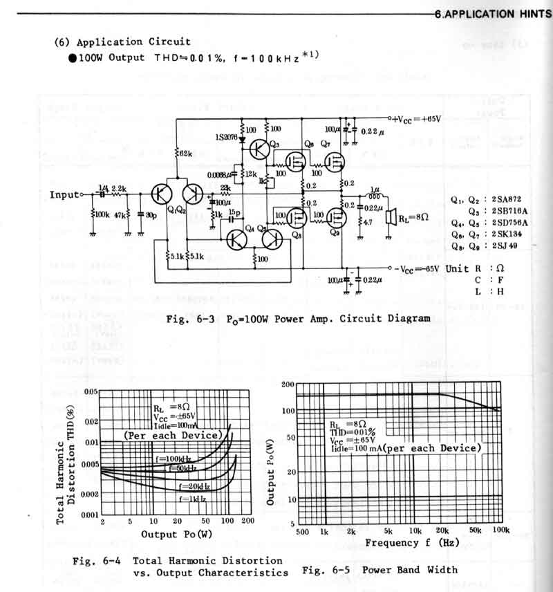

The guy is talking of the bipolar driver version not of the amp in post 1.
Beside he reproduced the text from Hitachi application note word by word without even giving any credit to the original authors,
i have the full AN, the graphs are also extracted from this AN, so you re using the numbers of an amp and are attibuting them
to another one.
Anyway i have no PCB or componenets to sell and no vested interests contrary to some people who are promoting whatever
can be used as $ printing press, if i did read it right you are on the occasion doing some business by here, so i can understand that you re promoting whatever can eventualy yield some profits no matter the real technical qualities of the designs.

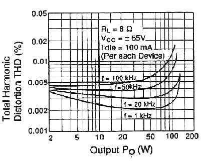

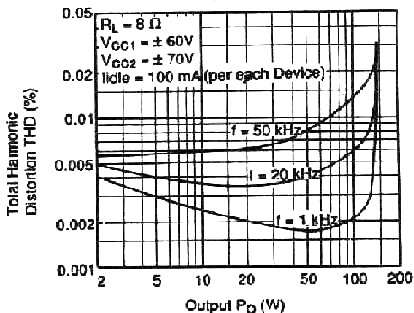

This is how I read the Paul Kemble webpage :
"A second more complex version using FETs throughout was also described. This was a DC design with low-impedance offsetting applied to the input pair, with stabilisation of their feeds and a separate supply for the input and driver stages."
followed by the schematics with all FET, then by the THD plot as shown in post #474 above, then :
"Alister note that, for whatever reason ....."
I don't think I can conclude he was referring to the BJT version.
This plot below is from the one with BJT VAS and only lateral MOSFET OPS.
Everyone can draw his own conclusions.
In any case, I prefer all FET designs, my personal taste.
Patrick
