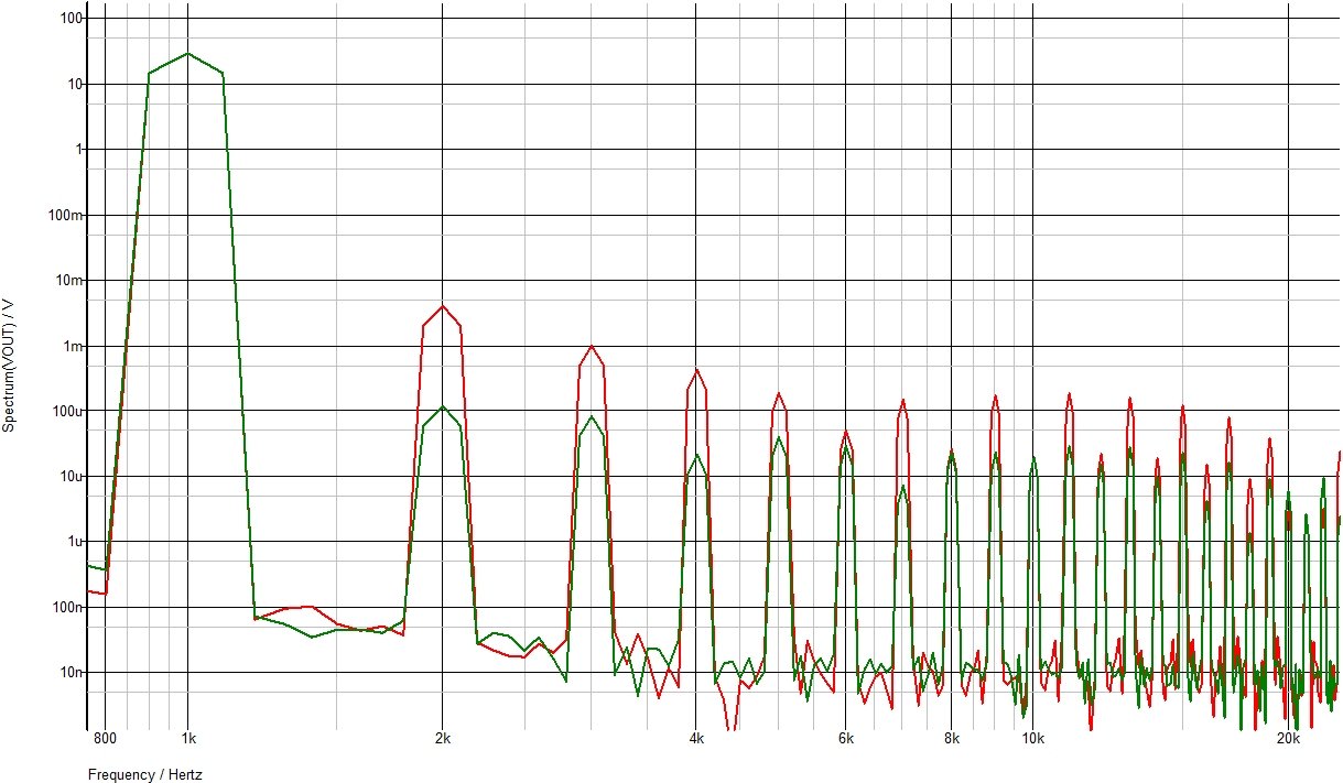

I must admit that I could never manage to use Ltspice. Multisim is not as successful as Ltspice. Discrete designs are a high-level job for me and I have a lot to learn. That's why I definitely need help from those who know this job. I love the sound of jfet and mosfet. The best thing I have done my jfe2140+tda7293 composite feedback amplifier and I think it's one of the best chip amplifier applications I've ever heard. My goal is to do something with fets that can be purchased from mouser and dikikey. Of course, k214/j77 can be supplied from members. I don't want to give up on this amplifier 😊
Thing is that the full fet original schematic has way higher THD and IMD than the version using bipolars
for the VAS, fets simply do not well for this stage, here a simulated comparison at 50W/8R.

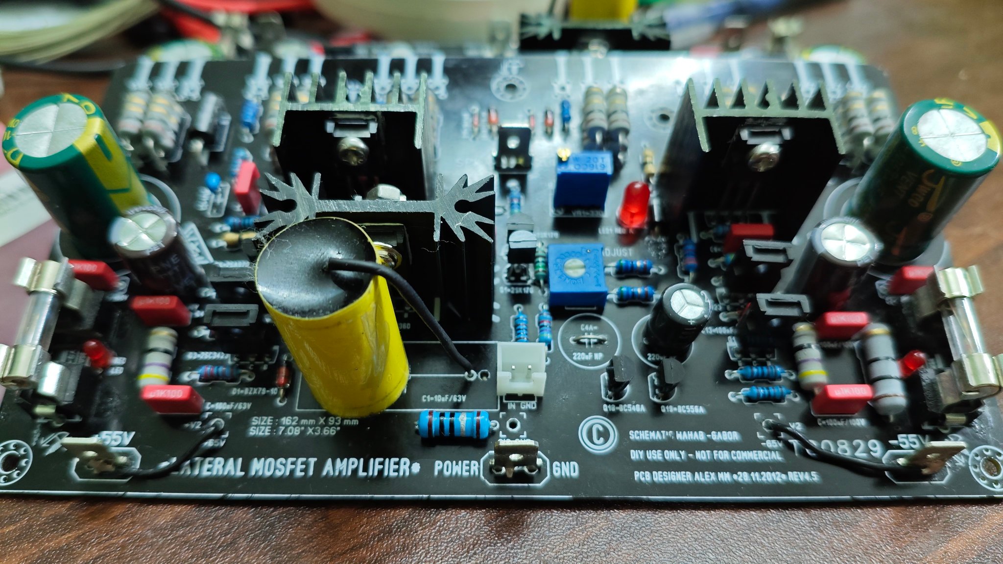

Just stubled over this amp yesterday, this is definitely going to be my next build. I have 2SK214/2SJ77 , 2SK134/2SJ49 and 2SK1057/2SJ161 in stock . So the only ones im missing is the 2SK190 and 2SK186. So i can build almost all of the original circuit, i also have 2sk117 and 2sk170 in stock.

Hi
Finally I have found some time to assemble the amplifier board.
If Wahab, Gabor, Alex or any one listening, I have one question.
I would be using three pairs of Mosfets in the output stage and single power supply of 55V to VAS and the output stage. Now what should be the value of the preset that is used to set the Bias for the output transistors? Right now I am using 200Ohms.
Also what should be the maximum value at the preset (before the bias setup) so that current would not damage the output stage. I am planning to set 100ma per Mosfet as bias current.
Kindly suggest.
Ganesh
Kindly suggest.
Ganesh
Wich schematic within this thread did you use exactly.?
With three pairs there s no need to bias them at 100mA each, 30mA/pair is way enough for good linearity,
and also reasonable idle power draw given your +-55V rails, i have a lateral fet amp using 3 pairs/channel
and it s biaised even lower at about 20mA/pair.
That should be good as long as it allow to set the curent easily, anyway the two diodes in parralel will limit any wrong doing,
also you could add the 330pf capacitor i mentioned in parralel with R4, 220pF is enough actualy, eventualy the amp
can work without it but it s more cautious to add it as this render the circuit less dependant of the transistors parameters
when it comes to stability.
If you test with +-55V on the first try then put 3-5W 20-50R resistances in serial with the +- supply lines,
or a 40-50W incandescent light bulb in serial with the transformer primary.
Sure. Thankyou Wahab. I shall test the boards in a days' time and come back with the results.
