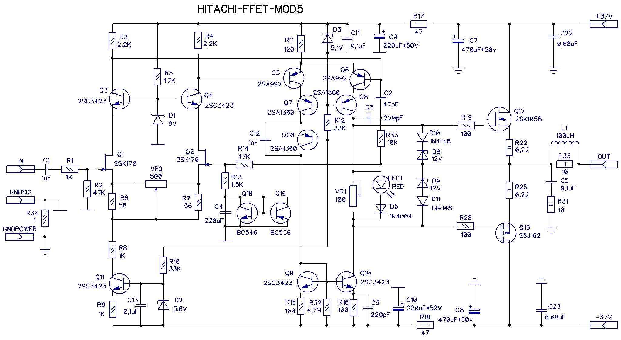

I know Alex. This circuit design and PCB design is mind blowing. It does perfect justice to these mosfets from Toshiba.
Now the problem for me is 2sk170 is not available anywhere in India. I know that replacing 2sk170 will change the dimensions of sound.
The guy in this below link has it. He says it would take 5 weeks to deliver to India.
AUTHELECTRONIC.COM
Also can I use 2SC3421 and 2SA1358 instead of 2SC3423 and 2SA1360? Because again these are not available.

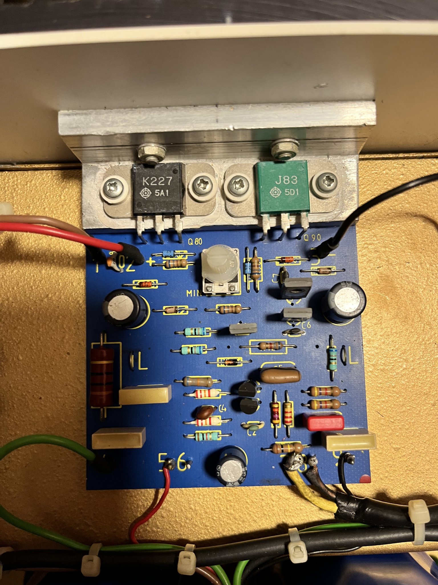

Hi, look here, I even, layout a PCB few years ago for this amplifier !

Good hunting Ganesh. I'm assuming there's some sort of minimum quantity. Did they indicate pricing?
Do note that the Gm variation in the LSK parts is quite extreme and there is a limited range of parts that DIY'ers can use for most amps. Also that like all other JFETs matching between parts is very poor and they need to be matched by hand. So even if you need say 4 devices, you may need to buy 10-12 just to arrive at somewhat close matches.
The circuit shown here does not seem to require such close matching and has an adjustment to fix errors caused by poor matching between the halves of the diff pair, but running equal currents through both arms is always a better idea. Thus will also benefit from some balance between parts.

I was able to procure some 2SK30 (25 numbers). Can this circuit be modified for 2SK30 instead of 2SK170?
I also have 2SK105 and 2SK330.

Today I put together a HITACHI-FFET-MOD5-5-SCH mockup. The result is excellent. The sound is very clear. At a load of 8.5 Ohm /+ _36V, the amplitude is 40V. However, above this span, there is an excitation at the positive vertex. Attempts to increase the corrective capacities did not solve the problem, unfortunately. Perhaps the reason is the poor quality of components.
