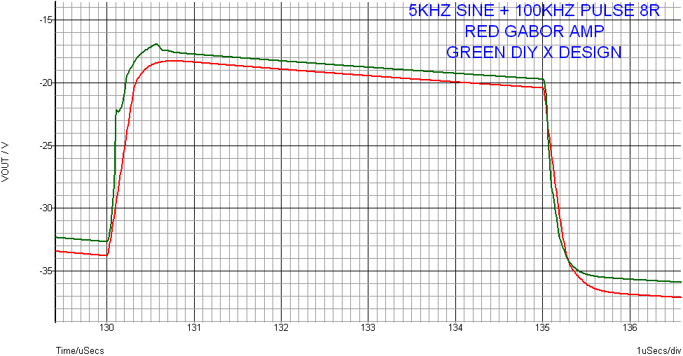

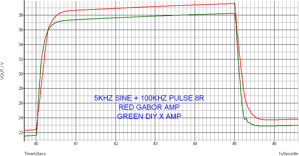

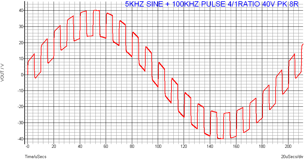

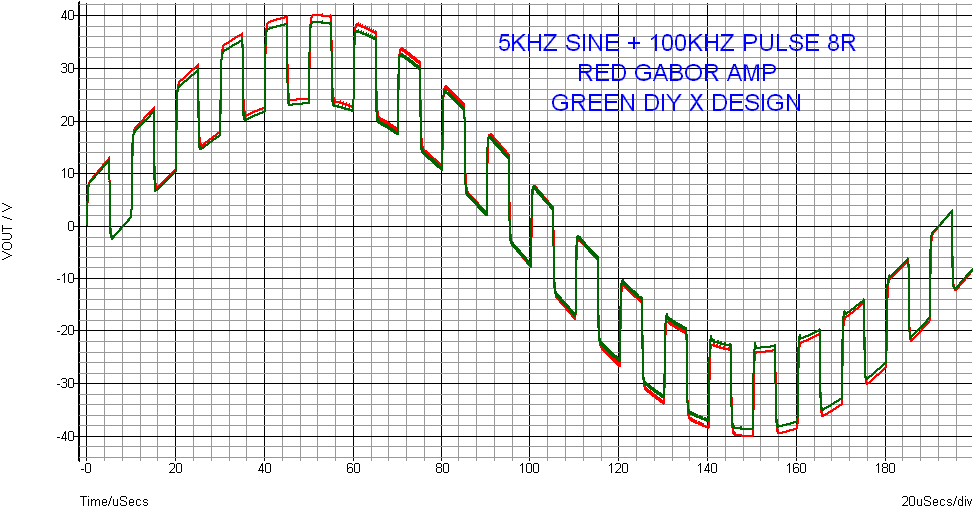

Large signal mode sim using a 5Khz sine surimposed with a 100KHZ square
signal at 4/1 ratio, quite a stressfull test to check unstabilities that can occur
at some specifics output levels.
The imperfection in the curve are due to the conversion from EMF to GIF ,
otherwise everything is straight...🙂

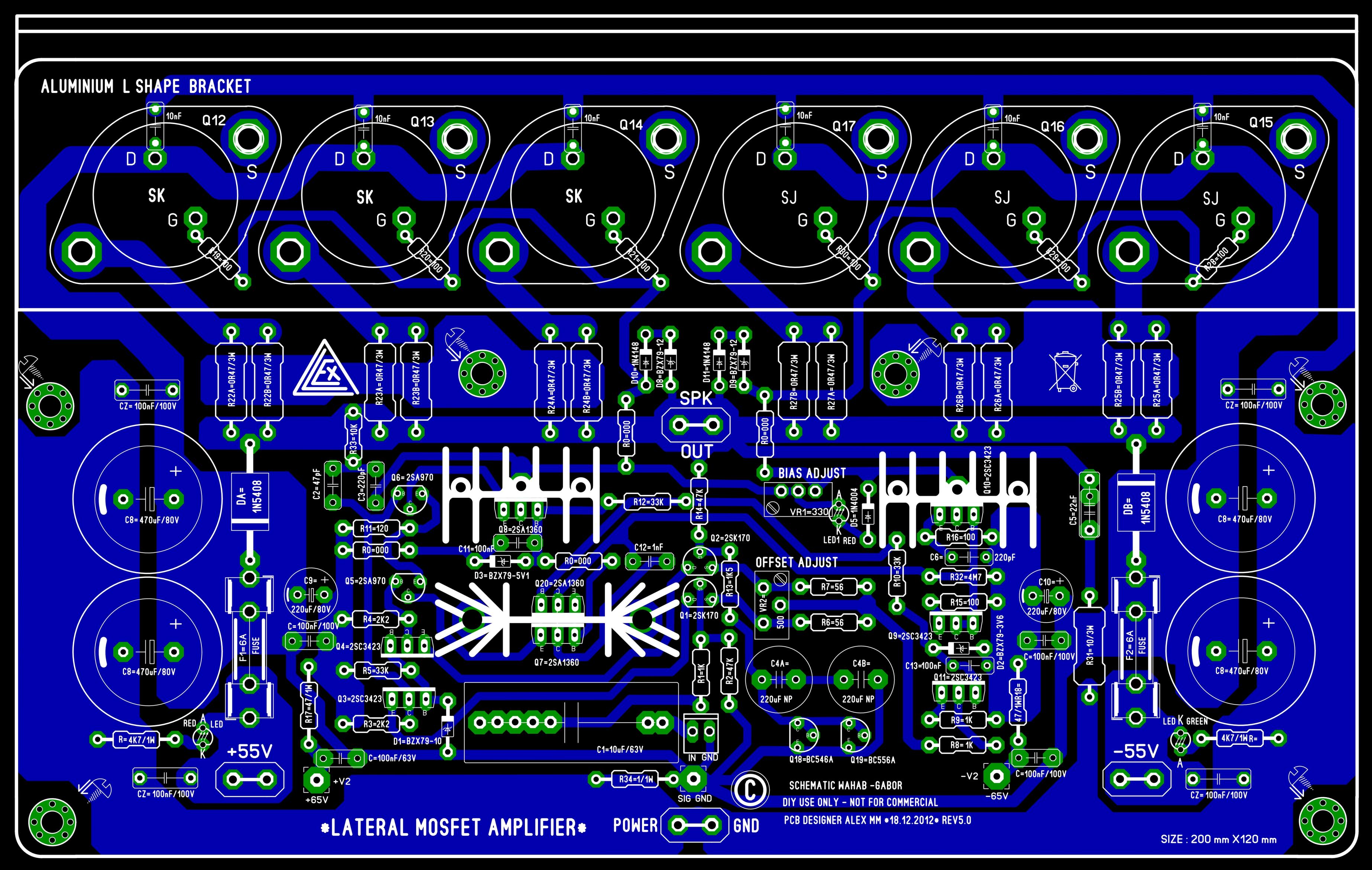

Hi Vitalica ,
For the input stage it s better to stick with the 2SK170 , the 2N is not as good,
it suit better the GM since its limited transconductance is part of the design stability ,
but for this amp that is stabilized for a higher feedback it would just degrade the perfs.
Other models are possible , though , i ll check and post my findings soon.
In contrast , the 2SJ56/K176 suit perfectly this amp , of course , it is likely
that they are even better than the 2SJ162/K1058 but as you can see , Gabors
PCB suit the latter so you ll have to either mod it or mod Alex s PCB wich is more
complex to implement if home made.

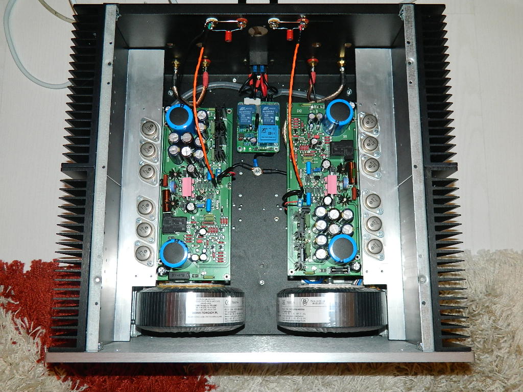

Btw , your amp is nicely built...🙂

An exemple of the test above with a comparison between this amp
and another one that i took randomly from the forum.
First picture show the two curves , with Gabor amp s having
slightly higher power output so we can differentiate them clearly when
zooming , first a part of the positive side and then the negative
side of the signal.
The test clearly show little glitches with the amp X that are due
to a compensation that is not accurate although i improved it slightly ,
otherwise the curve would really look ugly.
Thoses glitches would be likely not observable with a single pulse
that swing the same total amplitude.

I think that open loop gain is changing with output swing voltage ( decreasing ). It may to originate that glitches. You can to see it happens only near the peak output.
Quite possible , i still didnt investigate the thing since i discovered
this behaviour only when performing this sim recently.
That said , dont pay too much attention to the full amplitude graph
as the image converter EMF/GIF distort the picture hugely.
