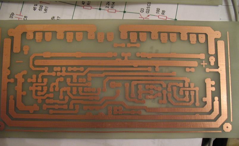

Here is the promised picture from my PC boards.
Also I made several other PC board for different amps like my Darlington which include the latest mode of wahab
I want to test also from ESP the P3A amplifier, Sakis praised so much he made me curious about that amp.
Unfortunately I used up all my clad boards and now at the store cost 4X as much than last time!!🙄 Otherwise I would make a pair PC board after Alex layout to.
Any way I will order for these amplifier at least PRP or Dale resistors. Also for the other amps to.
So it will take a while (few weeks) until I test it.
I hate to desolder the cheap parts and use the same board again and again.
Specially I use silver solder, very hard to work with, need high temperature for melting.
The boards need to be stained, drilled, cut into size etc.. Was made with hot iron transfer method.

Great work , Gabor , this is very net.
The compact components placement and subsequent routing
is instrumental in a high NFB amp and in this respect this PCB should
be optimal , the only influence it will have on the caracteristics
goes in the right direction by the way..
Simulations show very promising perfs and (without wanting to boast around
this design, i simulated almost all the amplifiers that are running in this forum
as well as scores of commercial offerings) as a result only a few commercial designs or Edmond s PGP are as good or better on a global estimation , the latter thanks to its use of Bob Cordell s error correction circuitry , wich if applied to this amp would bring it very close.
Given how much energy and means you did spend to build numerous amplifiers
i really hope that this one will be good enough to supersede your previous tries and provide you with a high performing unit up to current audio standards.😉

Hi Gabor ,
Set apart the transistors , all the rest has no specifical requirements , standard quality
resistors and caps will be enough and expensive parts will bring nothing , so just use
whatever you have already at hand...😉
As for solder , i doubt that silver solder is of great advantage ,rather the contrary
given that it stress the components while the soldered point contact
can even be less good due to eventual uncomplete melting.
The points with high current rating , only the mosfet drains , sources
and sources resistors can have the components tails bended horizontaly
to stick with the copper tracks and then soldered , this will provide a contact
good enough even with standard solder , the only drawback is more difficulty
to unsolder such points although not using silver render the thing easier.

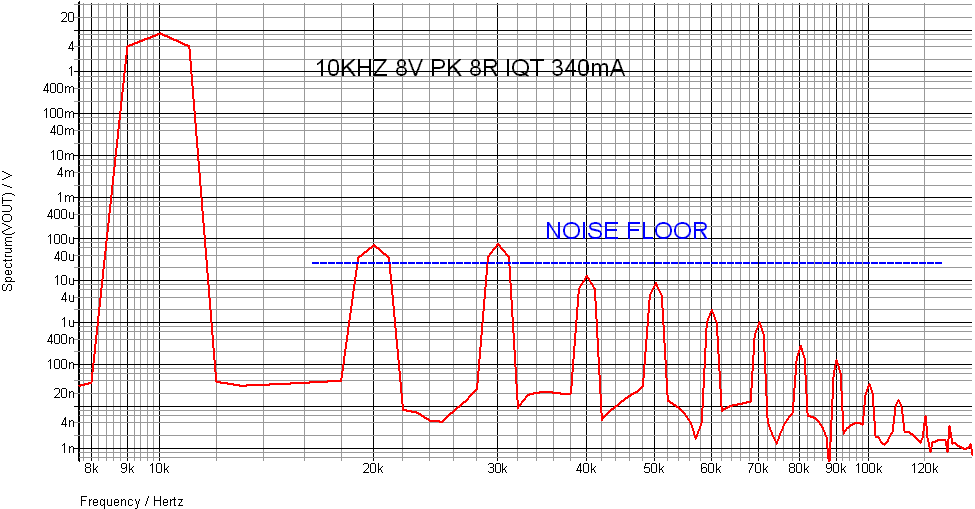

The problem with this amp is it doesnt have THD. Its highish THD and the spectrum of that THD that makes people like or dislike an amp. 😀
Let s say that it has not enough of it , but this can be easily "cured"
by driving it with a unity gain SET stage whose distorsion will be reproduced
quasi undistorted....😀

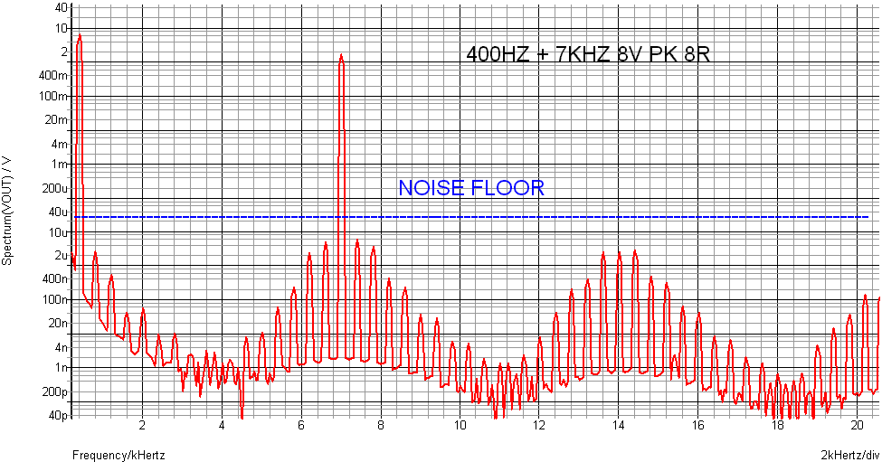

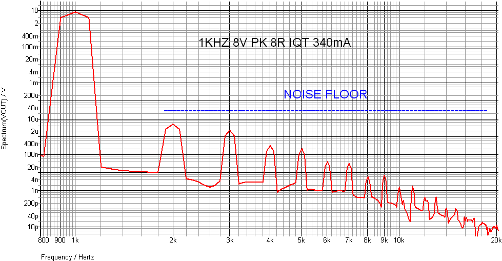

While we are it , THD plots at 4W RMS/8R for 1 and 10Khz as well
as IMD 400HZ + 7KHZ ..🙂
The noise floor is traced as reference.
Contrary to simulations at high frequencies , low power sims
wont exhibit high frequencies residuals.
Actually , the simed THD at high power is likely higher than
in real world for higher order harmonics.

Why you don't use "db" scale ?
Well , the conversion in db is straightforward but true that most people
are used to dB , so next time i ll use this reference....😉
