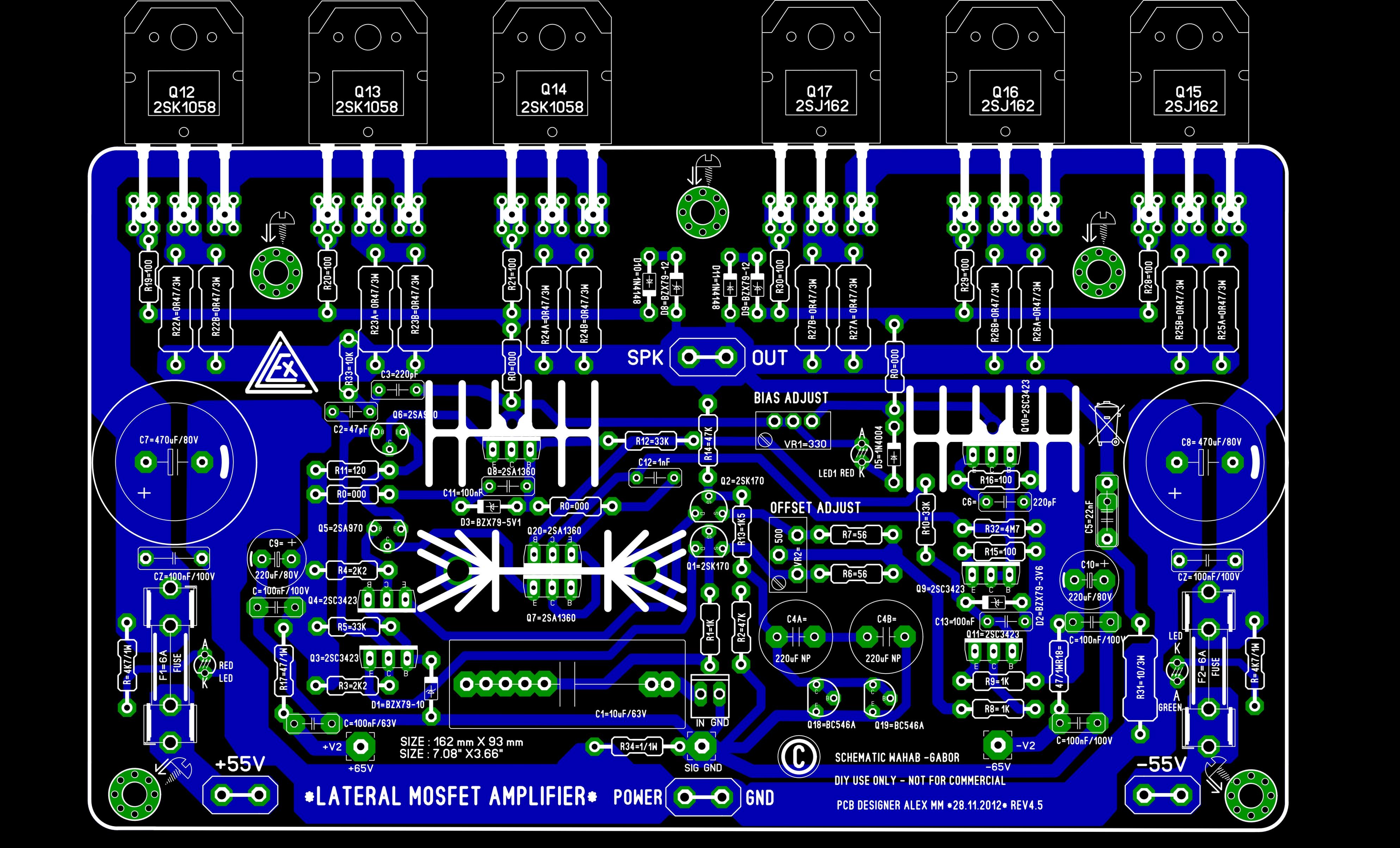

All Hitachi Lateral Fet amplifier for DIY described by Paul Kemble
Last rev 4.5
....... It's the last PCB layout here on this forum , I will not layout anymore ....:mad: sorry for that , but for me was enought .....all I done was , layout in wrong way , so I let experts to do this job .

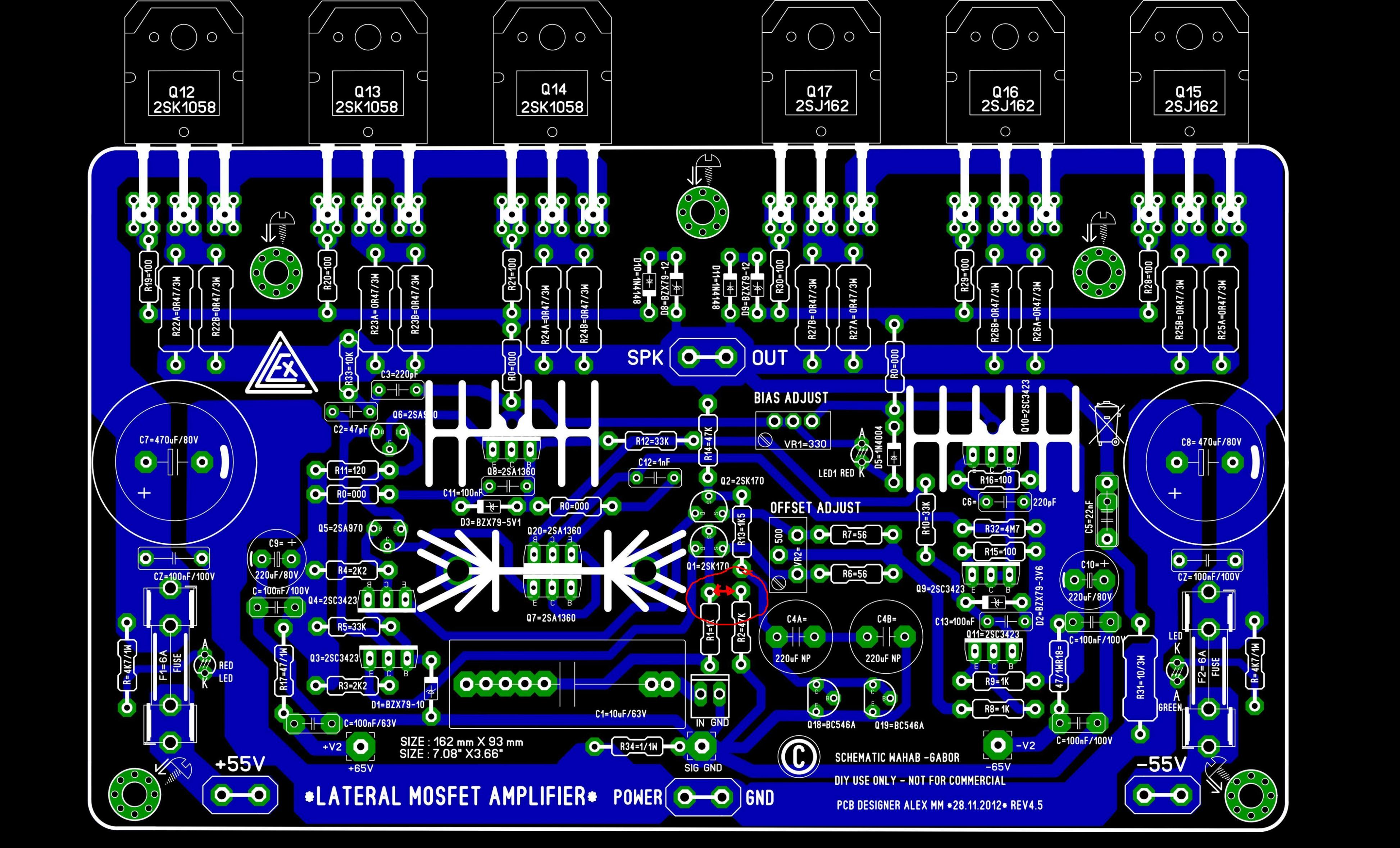

I repost this PCB as there s a missing track for eventual builders.
Here is my test board so called "art work"
I upgrade it up to the last mod, I ad the Q20 and the two C12/13 caps.:)
Since all hand drawn on my computer paint program I do not have silkscreen like Alex who is great and talented with software design.
I did tried one time to use some free software, I didn't succeed so I keep draw my layout by hand.
These is hot iron transfer friendly at least...
Alex design is so beautiful I would pay to get it on a professional made PC board.:)
Great board as well , Gabor...:)
I like the compacity of this PCB, yet with all options..
That said , since the laterals have no source resistors , if ever
you want to check the devices individual iddle currents you ll have
to solder only gate and drain on the PCB and solder the sources
from tip of the pins to PCB using 0.22R resistors.

Hello
I did listen to your advise and I modded my layout. Now I have Source resisters to.
The PC board got bigger about 8mm but I think it is good to have those resisters
All do I read it degrade the sound a bit but there is a lot of advantage to to have them
Help a bit when not 100% matched the power mosfets. I can measure the bias on each mosfet etc.
So Monday I will go to laser printing to do the PC board to these amp and the Darlington also.
All the components remain the same place accept those now marked on the PC board..
Greetings Gabor

I just printed out the modified layout.
I implemented to the layout Q20 and 2PC capacitor which was added last week or before by wahab.
Also I added Source resisters so I can measure the bias on each mosfet.
Because these mode the PC board size changed a bit.
The right size 176 x 76mm.
Open the last posted layout with the paint program, use page set up 86% and print.
The mean time please get read of all the colored marks on the layout.
I'm more than happy how these layout came out.
Also the Alex layout is more excellent if someone want professional PC boards I advise please use that. If we would org. a GB I would use that to, but I can't wait, I would like to test these amp ASAP.

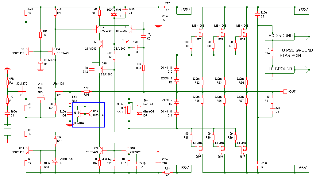

Also , i replaced the two diodes connected in parralel with C4
by two random transistors wich are used as diodes , each one
having its base connected to its collector , no need to update
your PCB since theses pins can be connected together directly.
Please excuse my ignorant question - but what is the purpose of the two diodes here ? I tried reading the previous posts but may have missed the explanation when the diodes were introduced.. Many thanks!
Actually they have no role if the amp work normaly , it s just in case
of failure , if ever the output goes to a rail voltage wether it s due
to a mosfet going short circuit or a rail that would be switched off ,
the consequence would be to have the gate being biaised with
a full rail voltage , hence the diodes to limit the eventual high DC
gate/source voltage.

I made some sims to check the influence of this PCB routing for the most critical tracks at least , and your layout is well done electricaly speaking , it has no negative influence for the amp stability.:)
I thought it will be more interest on these great amp but that will not hold back to go on and build it.
I had 80% the necessary parts for the amplifier.
The design looks quite complexe and whoever has not great experience in the domain will see it as a difficult to make work while in fact it is supposed to settle at first power on with no other thing to do that setting the bias and eventualy the DC offset.
Also , components prices and availability can be problematic.
Set apart the laterals , wich are not replaceable , the input stage cascodes can be replaced with 2N5551 or BF469/471 if 2SC3423 are not easy to source.
The VAS 2SA992s can be replaced by BC560C but when it comes to the rest of the VAS the 2SA1360/2SC3423 are among the components of choice although BF469/470 or 471/472 would work as well.
