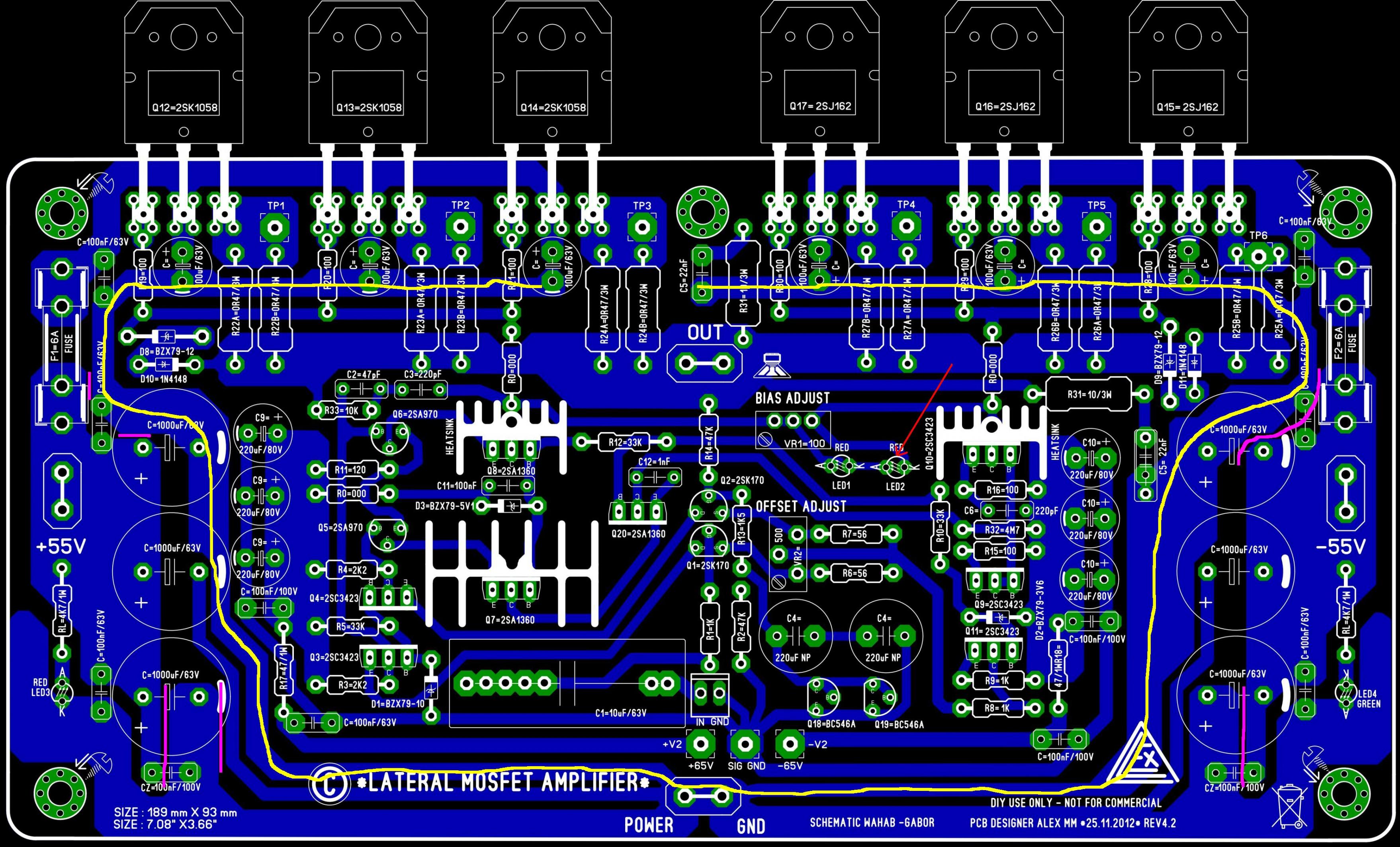

New PCB rev4.2 layout acording to last posted schematic 🙂
Regards Alex.
Hi Alex , Q20 also need a heatsink...😱
In fact Q7 1.2W dissipation is now shared 50/50 with Q20 ,
for 0.6W each , so it s either two small heatspreaders or a bigger
common one.
Also , in parralel with the bias trimmer you did implement two Leds
in serial while it is a led and a normal diode , although one can simply
put a standed up diode instead.
Anyway , thank you for the design , no doubt it will be much helpfull
for people willing to give this amp a try.

board lines does look somehow neater now, absolutely
is there a special reason why you split the ground lines for supply caps into multiple thin lines ?
any board measurements ?
(to see how it fits the heatsink)

About the layout
1)If we use the 6PC 100uF caps at the power mosfet the ground trace almost close the whole circuit like a circle...
2)At the bias trimmer one is a LED one is diode Red Arrow
Do we need 3PC 1000uF caps on the PC board each side? Or 3PC 100uF for the higher voltage..
I think 2PC more than enough.
As power supp capacitance not enough and for coupling caps overkill
If we use only 2PC we can leave a bit more room (purple)between the HC voltage and Ground..
Yellow line almost a circle???
I learned the ground has to be like a glows or a tree.🙂 If I'm wrong please forget it!
I know how hard to lay out a good PC board and thanks to Alex he is very patient, helpful, gifted and talented!!!
Just a few thoughts..
Greetings Gabor

I would quit the big onboard supply caps
better to place seperate big high current supply caps close to board
and instead have bigger supply caps for the higher voltage frontend
but I guess it could be argued

These is the best design Alex came up.🙂
That is the reason I ad some marks because these is very close.😎
If I remember well the R17/R18 has to be 2W type if not please forgive me.
We could spread a bit the leads of the mosfets, that I say because we mount the mosfets from the bottom (copper side).
If the trace to small very easy to damage the PC board in case if we need to desolder etc the mosfets.

The PC boards size is there 189X93mm
wahab do we need those 6PC 100uF caps at each mosfet?
That ground trace bugging me a lot!
I agree with you!
2X470uF is more than enough for high power on the board
2X100uF for the higher voltage
Even one each would be good but let s leave room who likes higher uF.. 2x470 or 1x1000uF etc but no under circumstances 3X1000uF..
That over kill for coupling caps and for PS is not enough..
Greetings Gabor
R17/18 dissipate at most 0.05W each so 0.5W resistors could be enough
but they have to withstand the power on charging current wich can be
quite high if capacitors values are about 1000uF.
With 220uF they should be enough.
As for the 6 mosfets caps , well , they do no bad but perhaps 0.22uF MKP
would be more relevant given that there is already electrolytics filtering caps
in the PCB for theses rails.

Alex the Zobel N is repeated, U added twice to the circuit..
