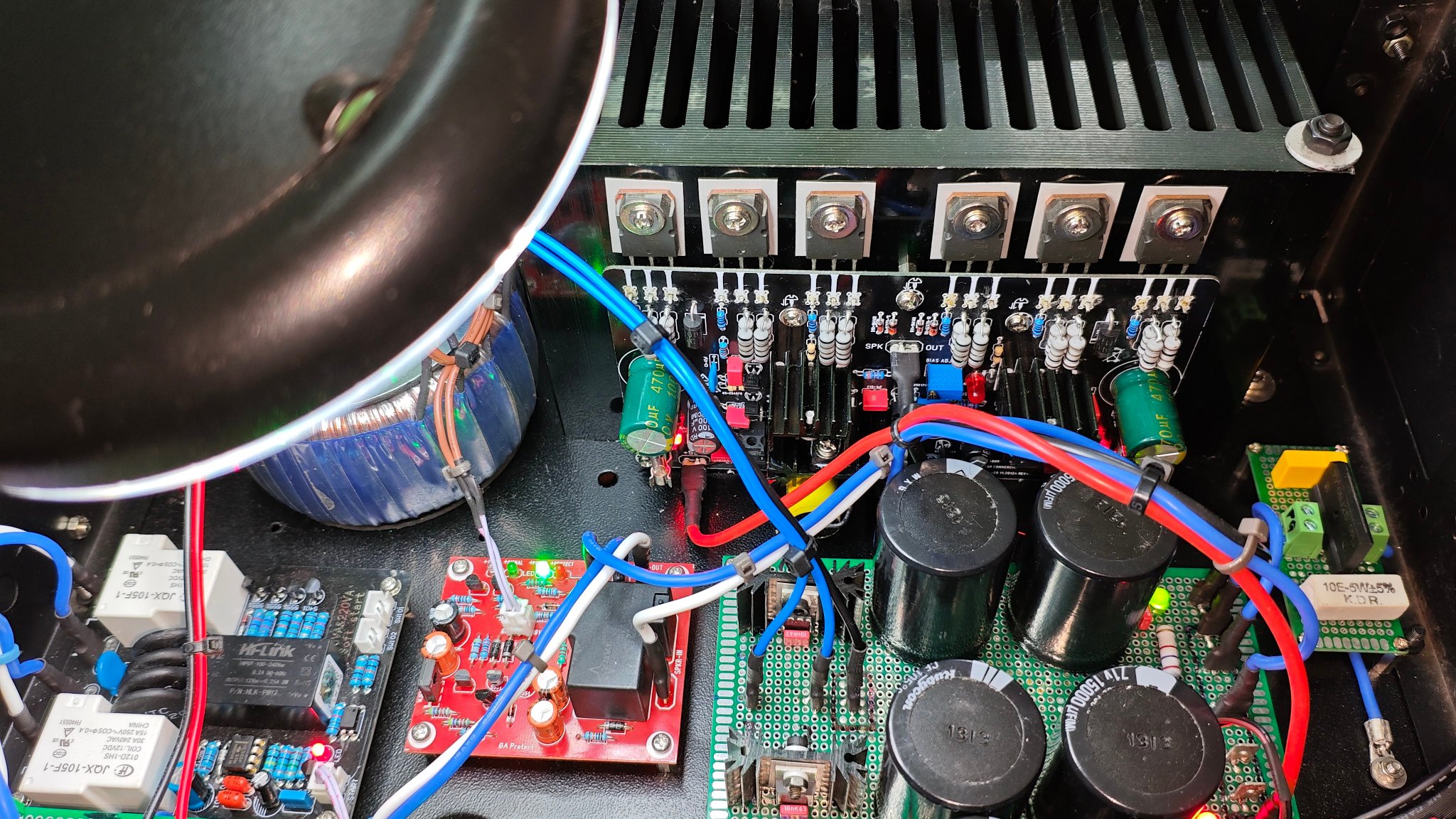

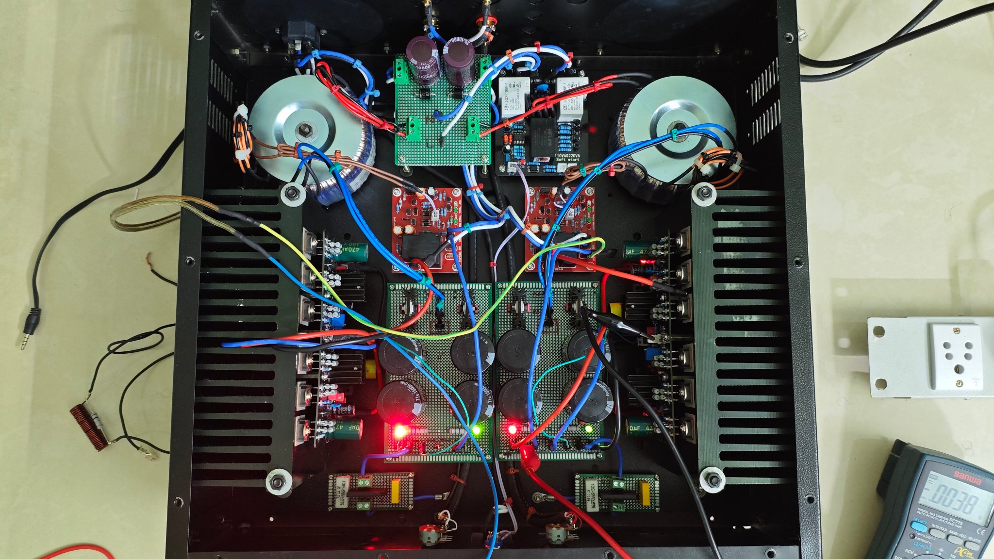

I assembled the boards inside the cabinet as in the enclosed picture.
As I had stated, everything worked just perfect outside. But now I have problems.
I think it is oscillating again. When the volume control is suddenly increased or increased, it is drawing high current.
There is another peculiar problem. If I quickly change the volume (low to high or high to low) upto 35v DC is appearing at the speaker terminals for a second. And then it is back to zero.
Kindly suggest what to do.
Please don't mind for the wire jumble. I shall clean it up later.
Ganesh Laxmanmurthy

First thing to check is that the speaker ground on the output connector goes directly to the power supply
star ground, it shouldnt be taken on the amp s board.
Since you have two PSUs each speaker ground is taken at its relevant star ground.
Other than this you can try a 100-220pF cap connected from amp input and ground, eventualy it can be connected
directly on the potentiometer if the potentiomer to amp cables are not long.
Also what is the source you are using and what is the value of he potentiometer.?.
Hi Wahab:
I think I solved the issue. Bu mistake, I had connected the signal ground to the star ground. Once I disconnected it, it is working perfectly.
Below is how I have built it.
I have tried to keep both the channels discrete.
Power Supply:
Mains Supply -> RFI-EMI Filter -> DC Scraper -> Soft Starter -> Power Transformer -> PSU -> Amplifier
Amplifier Output -> Speaker protection -> Speaker Terminals
Chassis is Earth and I have added Ground-Loop-Breaker.
Volume control is high quality 47K LOG potentiometer.
Kindly suggest if any changes are required.
I shall cleanup the mess and update with the pictures.
Sound quality is impeccable. Absolutely no hiss, hum or noise being picked up from any source.
Ganesh Laxmanmurthy

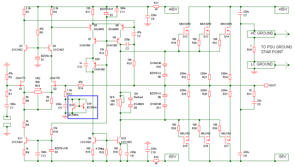

@lganimys, for home use that s indeed perfect, let us see what the final build look like, and also, do you mean that you tested back the original schematic with the 47pF + 220pF previous compensation.?
And for what gain did you settle as definitive value.?.
@mlloyd1 @gary s , we ll have to wait that lganimys give us more precisions about his final values, i ll update the schematic accordingly, lately the compensation was increased from the mentioned values to 68pF + 330pF, that s actually the only real change, also after he got it stable on his second test once cased he eventualy increased the gain.

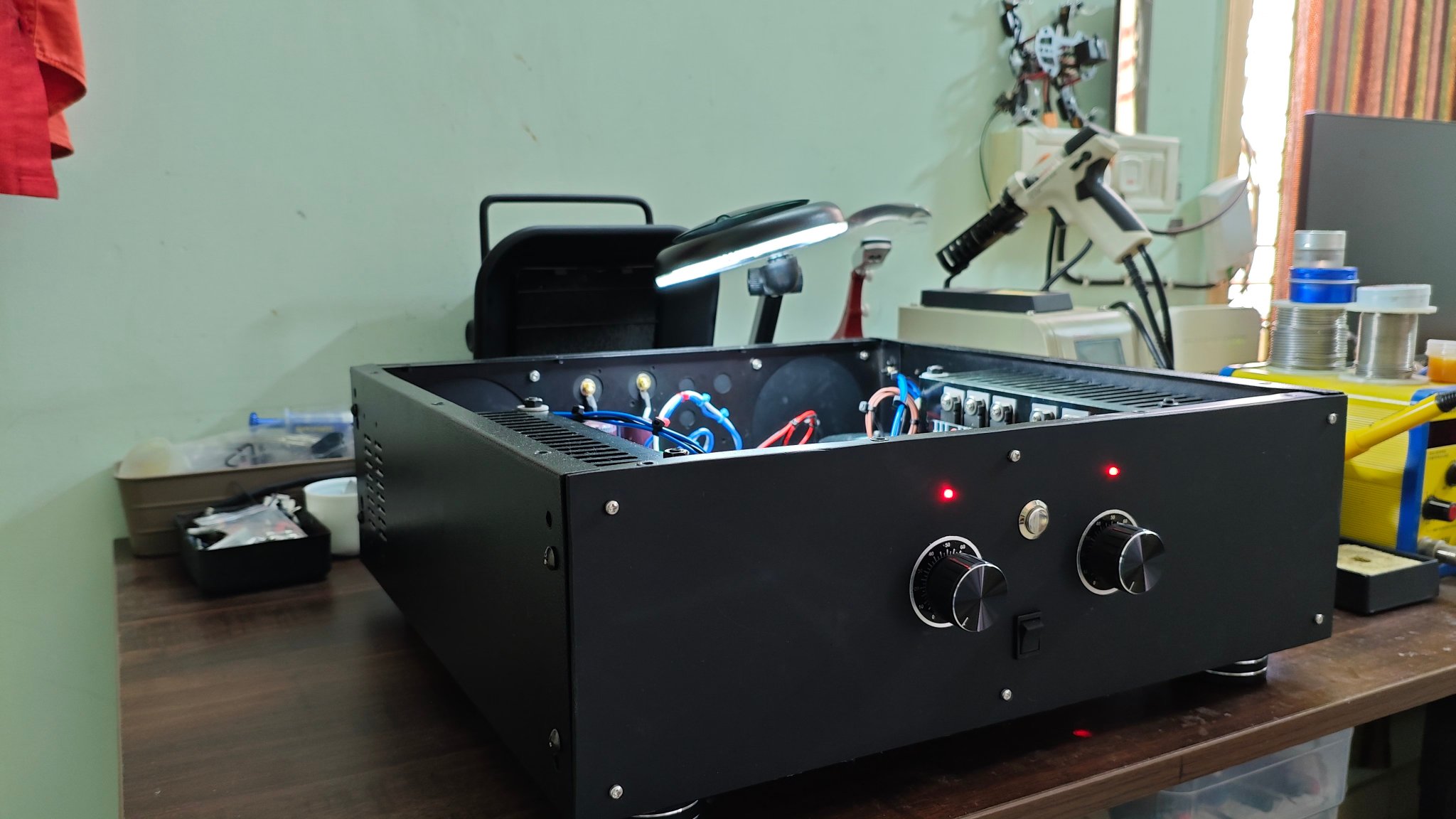

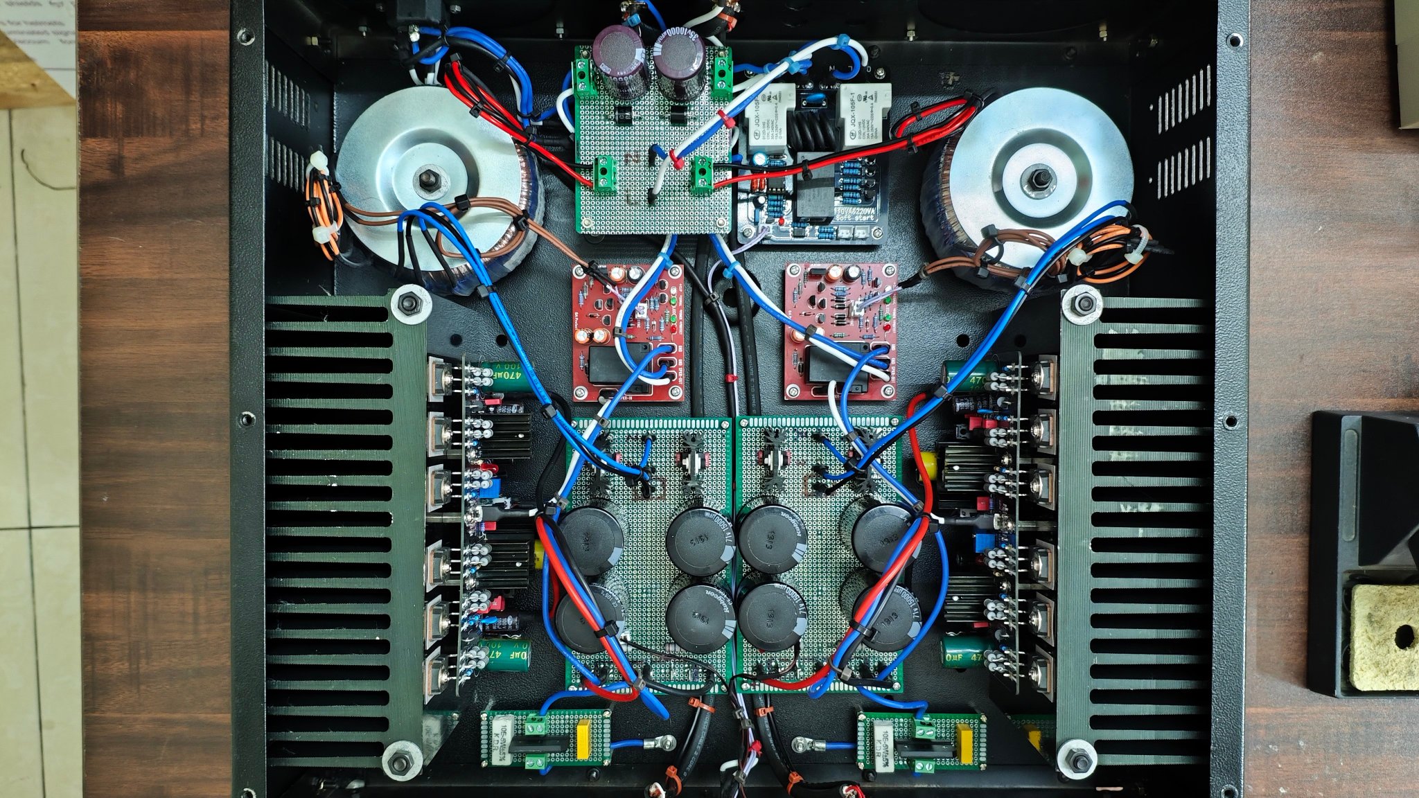

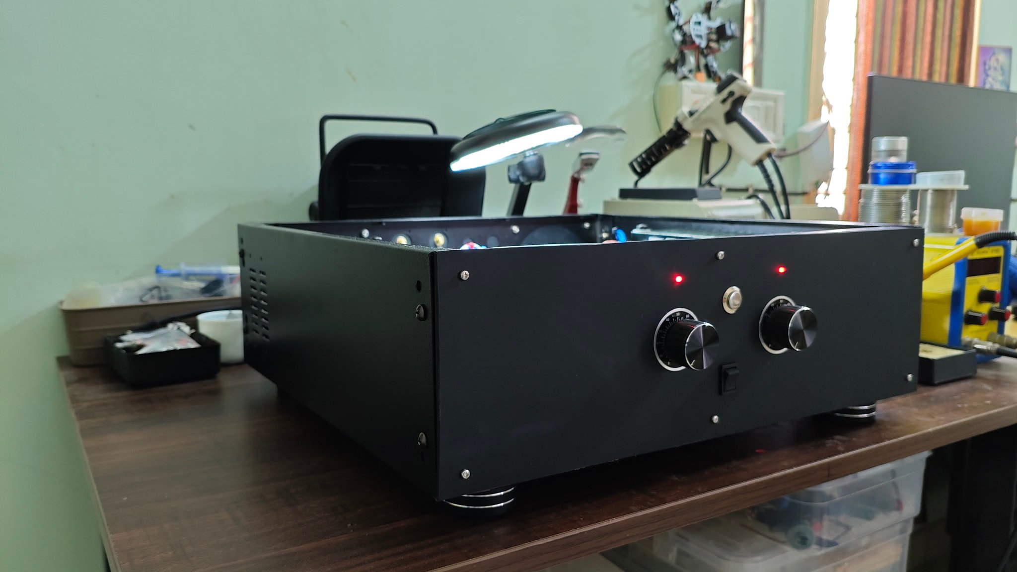

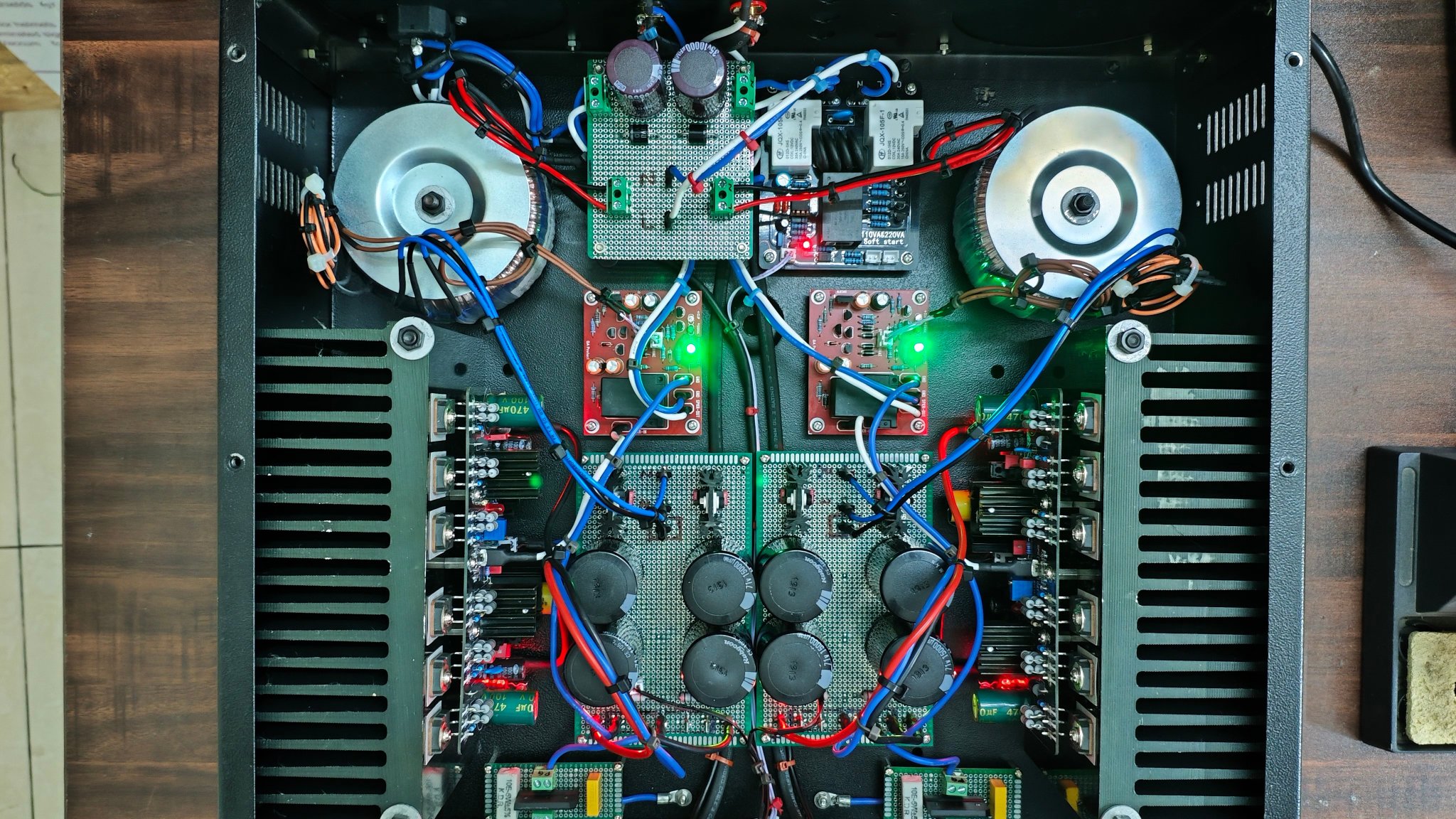

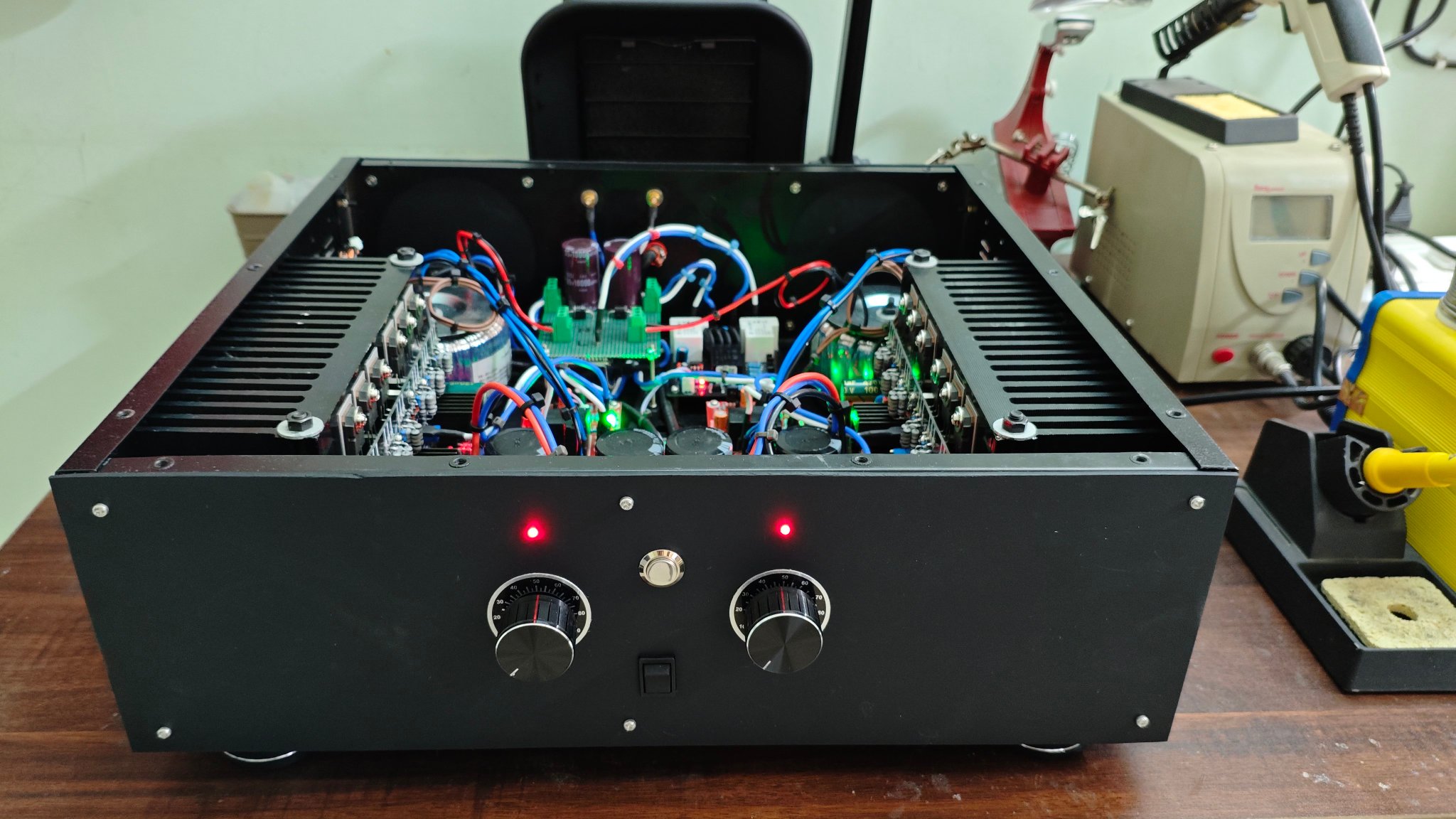

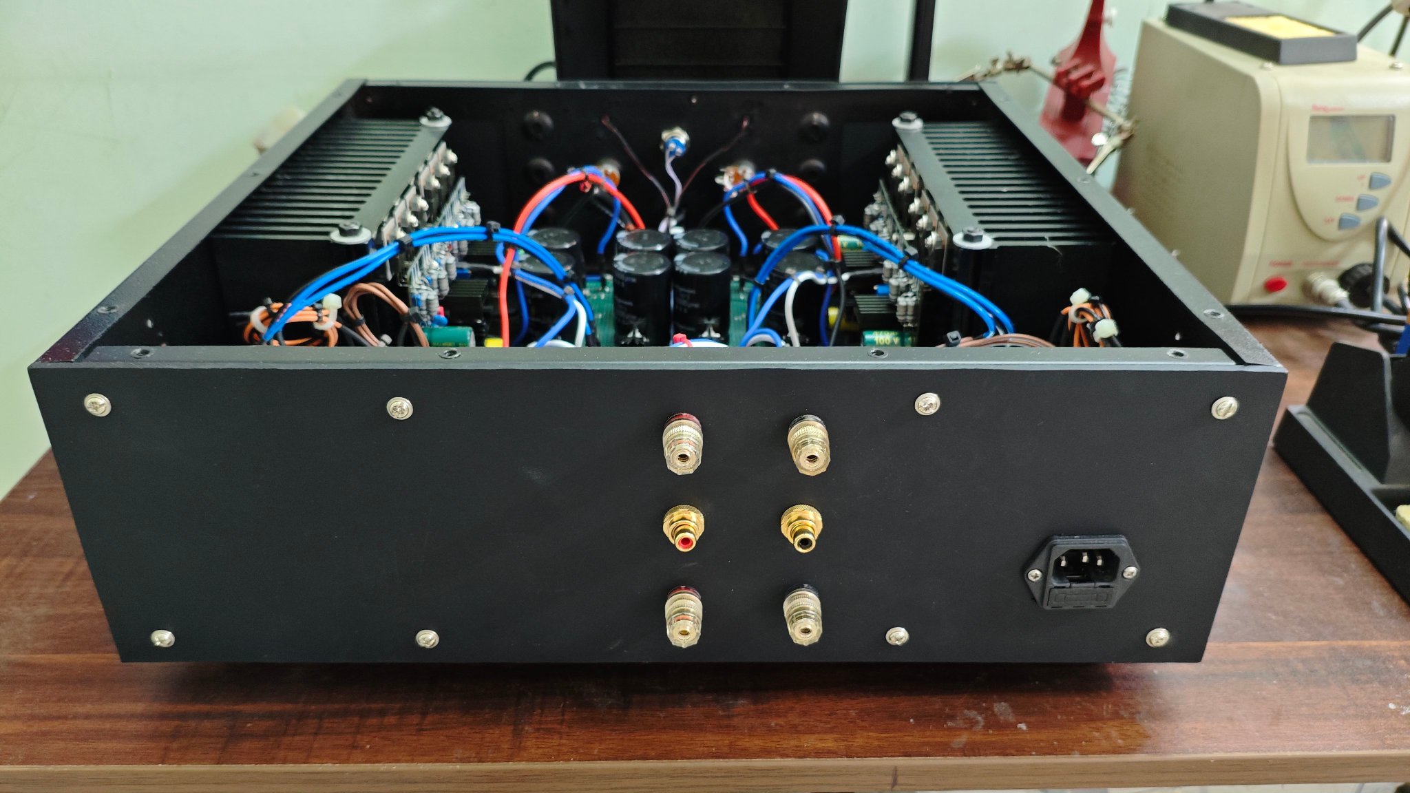

Hi
I have attached a few pictures of the amplifier. From the top view except the RFI-EMI filter, all the other modules are visible. RFI-EMI filter sits below the DC scraper module.
Stereo separation is on par with any audiophile amplifier.
The sound from both the channels are identical. To achieve this, every component has been measured for precision. Components with exact measured values are sitting in both the channels.
All transistors in the input, VAS and driver stages have been measured for near identical Vbe in respective channels. I fact I have kept the lengths of all the wires in both the channels equal.(a bit too much)
The input sockets are of RCA type and medium quality but gold plated. The co-axial signal wire from the back panel to the front volume control is triple shielded to repel any stray noise.
I considered balanced input, but due to lack of time, I settled with RCA.
The volume controls are of Alpha make and of reasonable quality. I considered Alps, but procuring it would take time.
The cabinet is boring but had to settle with it because of non-availability of good ones'. Else I had to make one which is time-consuming.
If anyone has any questions, they can ask me.
Ganesh

@wahab
Yes. The compensation as per the original schematic just works fine. I settled with 68pF + 330pF to be on the safer side.
I think there was ground loop problem in the initial stages of testing.
Regarding the possibility of overheating, the soft-start module that I have installed has a built-in high-temperature power cut-off. I can connect the sensors to the heatsink and enable it.
