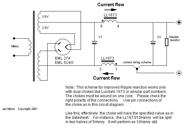

The aim is smoothing, it started as a simple LCLC filter. The Lundahl data sheet (and the jacmusic web page below) discusses using the 2 coils on the Lundahl chokes in CMR mode to reduce hum...
Lundahl Transformers - Tube amplifier transformers
in Common Mode Rejection configuration. Schematics will follow in the text, down here. In this configuration, one coil is in the positive lead to the second capacitor, and one on the ground lead to the second capacitor. This will give lowest field radiation coming from the choke. Such good results can not be achieved with lower cost E-Core chokes, and the Lundahl double coil chokes are a major step into the direction of a really hum-free amplifier. Electrically this is calculated as a series connection.
I think I'm getting the forum equivalent of blank looks - has nobody here used Lundahl chokes in CMR mode ? Maybe I've misinterpreted ...

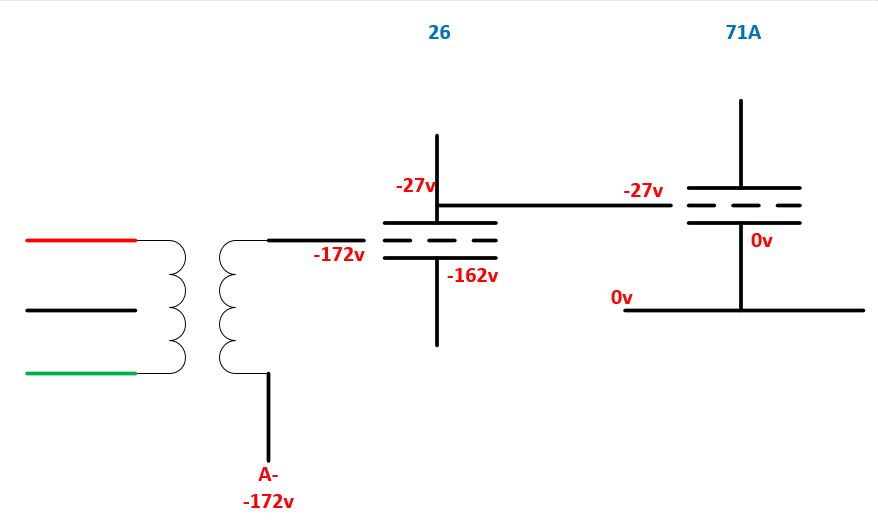

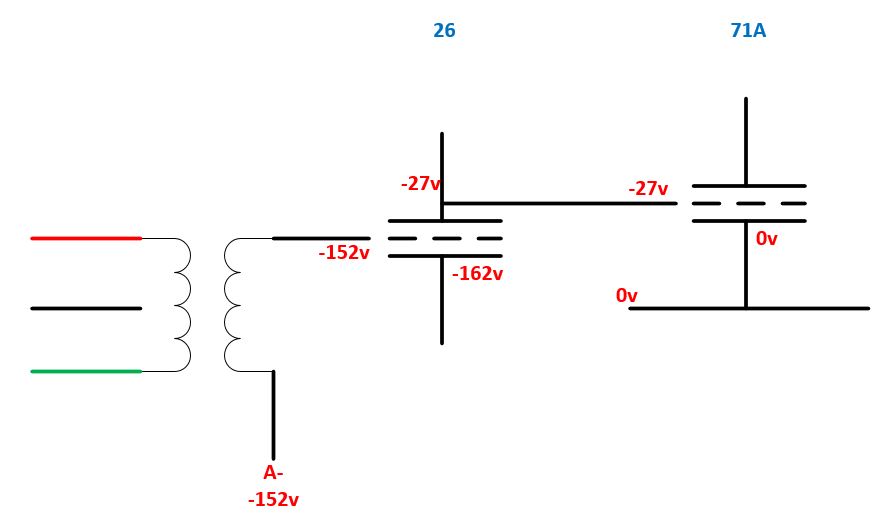

If you invert the voltages on grid and cathode at the 26 perhaps.
Sorry Mona I'm not following why the voltages need to be inverted ... the flow of my thinking was thus ...
- I want the 71A cathode to be at 0v
- With a 27V bias and DC coupled, the 26 Plate must be at -27v
- With 135V across the 26, the 26 Cathode must be at -162v
- With a 10v bias on the 26, the grid must be at -152v
My input is balanced into an input transformer, so I'd apply the -152v there.

The aim is smoothing, it started as a simple LCLC filter. <snip> Maybe I've misinterpreted ...
That's not what you showed... look at where the ground is connected vs. the one shown on jacmusic.
The explanation is, I'm a clumsy idiot. Thanks Mona.
... and the penny drops ... the ground is before the return choke, I'd missed that.
Many thanks.
The so-called 'CMR' mode (i.e. series aiding) for a dual winding choke makes no difference to ripple/hum suppression. You get the same ripple current going through the same coils in the same direction as for the conventional wiring method. I would expect the same external magnetic field too. The only difference is that you get a little high frequency common-mode rejection too.
To get a lower external field you need to use the common-mode choke wiring. In this case you get good noise rejection but almost no ripple rejection. I fear that someone in Lundahl has confused these two modes.
Again, just a thought off the top of my head at this point. Has this been tried before ?
Apart from the mistake already highlighted by Mona, the problem with that supply is that the 26 will have a plate resistor and so on the other end of the resistor the voltage is going to be likely positive or at least less negative than -27V. If the 26 is at regime a bit later than the 71a when you turn on the amplifier it will be really bad for the 71a because its cathode will be grounded, will get its anode voltage and the grid will see a less negative, or even, worse positive voltage. You will have to make the supplies such that the 26 gets going first otherwise....boom!!

I'll draw the schematic and ask for input in a different thread. Too many different questions being addressed though. My original question was ONLY about how to structure the cathode resistance under a DC coupled valve, and whether all or part of that resistance needed to be bypassed. I'm thinking through the signal section before I put too much work into the PSU.
Good point - thanks
I guess it's the seller at Jacmusic that has confused things....
Hmmm. I think I'm back to trying it to see if what Lundahl and jacmusic claim is correct.

So I did an LCLC version of the Lundahl CMR diagram. Pic 1.
Ive also sketched my current thinking of the amp, without the 45 (pic 2) and with (pic 3).
I think I get it without the 45. As soon as the 45 choke return comes into play surely there's a loop and the 45 psu return current could flow across the 71A choke and vice versa. All sorts of nasties I foresee there.
I'll redo it using both coils in series for the 45.
