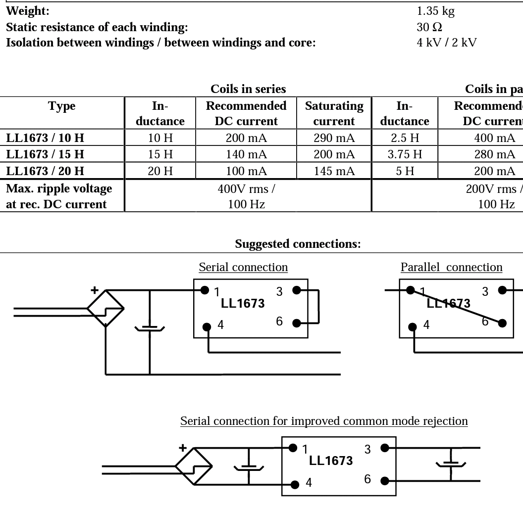

So this from the Lundahl datasheet for the LL1673-20H.
Planning on using the CMR mode, at the bottom labelled "serial mode for improved common mode rejection". I believe this will give me the full 20H for smoothing, even though 1 of the coils is in the ground leg. Is that correct? So 20H with a 200uF cap will have a cutoff - 3db at 2.5Hz for example.
I also believe that the + rail will see a Vdrop of 30R x 66mA = 2V, while the local ground (before the return coil) will be lifted to 2V. Is that correct?
Yes, that 'CMR' connection gives you the full inductance for smoothing and just a little inductance for common-mode rejection. For the sake of clarity, this is the connection which some people call 'common-mode' but it does not use the choke as a common-mode choke.

Many thanks for confirming
