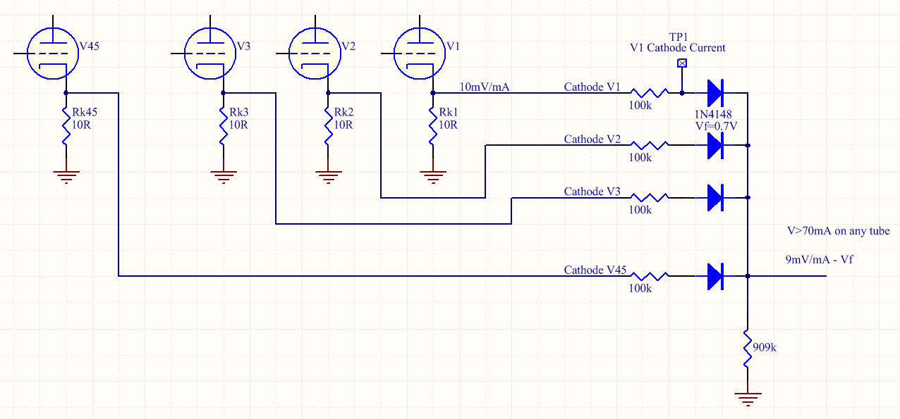

I think OP has 45 tubes, so if one loses bias or H-K shorts it would be good to know, very hard to notice until things are melting with so many.
Here's a sch of what I am suggesting. Basically a summation network with diodes to make an OR function. It would lead into a comparator or meter.
With a tube-only solution , you could use passive summation (no diodes) to get the total cathode current of all 45 tubes as one voltage. Not as useful, I would rather know if one tube is cooking. Given the dollars at stake, I would have a dedicated circuit.
It's not in the signal path, just "looking" at the cathodes, so I would be ok with SS.

I should have been a little clearer. This is a monoblock design. Each monoblock only has 1 x 5842 and 1 x 45 (plus three rectifiers).
I agree about the fuse and don't want it in the signal. However, this project is as much about learning and proving for myself what makes a real difference to the sound. I'm starting with the cathode fuse in while I test and stabilise the circuit but will bypass it in short order and listen to the difference for myself.
I plan to adopt the excellent suggestion made in an earlier post of placing a high value resistor across the trim pot. I need to draw that up and prove for myself how that will produce a high bias to close down the valve on trim pot failure.
I'm happy to use SS comparators, except that I know ZERO about using them. I'll come back to that. Just as long as they aren't in the signal path.
