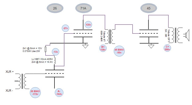

I'm looking to build an all-DHT power amp. 26 input, dc coupled to 71A, interstage coupled to 45. I'm thinking of using a negative power rail to supply the 26 and drop the anode voltage at just the right level to bias the 71A, per the attached schematic.
I'm aware of the startup order complications and failure scenarios, I'll come back to thinking about those separately, same with the power supply design. I'm looking for advice on feasibility of the signal circuit (which is cap free) and in particular whether applying the -ve voltage for the 26 grid (modulated through the input transformer by the signal) is OK. I've written separately to Audio Note to ask.
All constructive comments welcome

Nice tube combination. You already mentioned the potential start up issues yourself also keep in mind if the 26 fails for some reason the 71A will loose bias.
What makes you think the circuit is cap free? several of the circuit loops will go through power supplies and I assume you will have some caps there which will then be in the signal path. Not that this is a bad thing, just sayin'

Thanks Thomas - yes I should have been clear I meant no caps in the signal path.
The PSU design will come later but will use mostly separate rectifiers and rails and be LCLC filtered and smoothed. I like to use high inductance and minimise capacitance, using only good quality film caps, no electrolytics. I'll have to make an exception for the 26 heaters, I haven't used this valve before but have seen several comments that it works well with filament bias, so I'll use high-value electrolytics there. I also haven't used anything other than purely passive components before, but I've ordered a pair of Rod Colemans regulator boards and will try those. I really don't like hum (my wife really doesn't like hum).
I will want to both control startup AND protect the valves against loss of bias. I've done that successfully in my current amp (45, fixed bias) using a relay to trigger the primary rectifier heaters. I'll look into all that later but don't want to distract from my initial question, which is about applying a large -ve voltage through the input transformer to bias the 26.

What Thomas was saying was that whilst you're eliminating two coupling caps you still have the caps in the PS which are in the signal path. So you're balancing additional complication against the removal of the first coupling cap, not all of them. Anyone that builds a 3 stage DHT amp is not trying to build the most sensible engineering compromise though so try it 😀.
I started with chokes in all 6 filament supplies but struggled to control the voltage well enough for my liking, and in the end tried Rod's boards. They work very well and it's easy to set the voltage exactly. They removed a level of complication that worked for me. (Other filament supplies are available!)
I also have an IT between the driver (10Y) and output stage (300BXLS), but originally used an anode choke on the 26. I tried Ale Moglia's gyrator boards instead and liked what they did. They're more complicated than a choke but provide a voltage reference as well as the CCS. I won't be going back, and I'm tempted to try them instead of the ITs too.

If you want to eliminate caps, think of the cathode bypass caps - they're just as important. Using filament bias all through eliminates these caps without the need for negative supplies. But forget 45 or 71A for filament bias.

The caps from the B+ side to ground of the primaries of the interstage and OPT will be in the signal path. Make sure to use good quality caps there as they contribute to the sonics

The only thing I wonder about is that if you're going to the trouble of doing 2 plate current capable supplies, would it not make sense to go with stacked B+ supplies (one for input and driver, one for output) and direct couple in both interstage connections ?
Yes I could do that, but at the moment I'm just looking at the input (26) and driver (71A) valves. The typical DC-couple design would see the anode of the 26 around 135V, with the cathode of the 71A at 162V giving the -27V bias and the 71A plate at around 297V (135 Vak).
My specific question, because I haven't seen a design do it before, was around the idea of using a NEGATIVE rail for the 26, grounding the 71A cathode and thus avoiding a resistor/bypass cap there.
Has this been done before ? What's the best way of applying the -172V to the grid of the 26 - across the input transformer secondary as I've shown ?

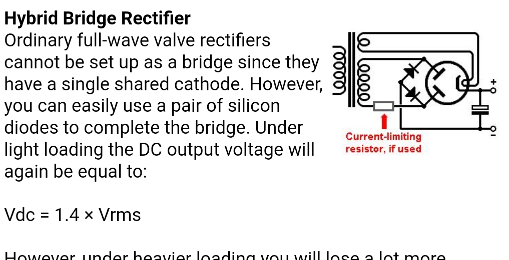

Hybrid rectifier with different current draw
I'm doing a psu design and need a positive and negative rail, but with different current draws. I could implement a second rail but the current draw on the negative rail will only be around 15 to 20mA, about 40 to 50 on the positive.
I was considering a hybrid rectifier design like the attached (from the Valve Wizard site). Would the imbalance in the current draw cause a problem (or sound crap)?
