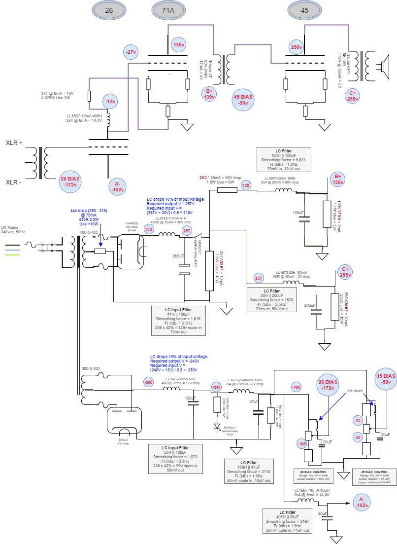

So I finally got around to turning my pencil sketch ideas into something resembling a usable circuit diagram, which I've attached seeking comments and inputs. Brief description of the design choices and reasons.
What started out with the objective of simplifying the signal circuit has overcomplicated the PSU - perhaps that's an inevitable consequence. I may also be overdoing the smoothing.
- as far as possible use tube regulation and LCLC filtering
- all DHT valves in signal circuit
- 26 DC coupled to 71A, IT coupled to 45
- Avoid the large cathode resistor and bypass cap on the 71A by grounding the cathode
- Set the 26 anode to -27V to correctly bias the 71A
- Fixed bias for both 26 and 45
- Negative voltage rail serving both the bias trimmers
- -ve rail also sets the 26 cathode voltage, isolated by a further LC filter from the bias trimmers
- Protect valves from loss of bias (just realised I haven't yet protected the 71A)

I am counting 6 capacitors in the signal path. That could be reduced further and even without negative voltage supplies.
You did not show the filament PSUs which will also be very relevant. There are cathode resistors shown for the 71A and 45 but without value. What is their purpose? Measurement of current?

Thanks Thomas - the DHT cathodes are 22R pairs to a 10R sensing resistor and you're right I forgot to label them.
I don't know if it's terminology or my misunderstanding. There are caps in the PSU, but not what I call the signal path ? Those caps are there as part of LC smoothing filters - I don't think I can remove them without reducing the ripple filtering ?
I am beginning to think though that in trying to avoid the 71A cathode bypass cap I've overcomplicated the design. Is it worth pursuing this path or should I simplify ?

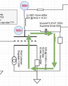

It is a common misunderstanding that a transformer coupled stage does not have any capacitors in the signal path. The signal travels in loops. For example at the output stage: plate of 45 to primary of OPT, from there through the last cap in the PSU to ground and from there through the sensing and equalisation resistors to the the 45. This last cap is fully in the signal path and is sonically very relevant as it transfers power.
Similar situation at the input side: interstage secondary transformer to grid from cathode through the dame resistor5s and the last cap in the bias supply back to the secondary of IT. This cap hardly transfers any power and is sonically less relevant IME but still in the signal path

You are right they are needed, not only for smoothing but also to close the signal loopThose caps are there as part of LC smoothing filters - I don't think I can remove them without reducing the ripple filtering ?
If your objective was to reduce the caps in the signal path, you can achieve the same result with conventional methods which eases the power supply and avoids the negative railI am beginning to think though that in trying to avoid the 71A cathode bypass cap I've overcomplicated the design. Is it worth pursuing this path or should I simplify ?

Thanks Thomas. I know my understanding is at an early stage, I've only recently moved to thinking more about current flows than voltage differences. Every bit of advice I get helps, so thanks.
I've been trying to avoid using constant current sources and voltage regulators, trying to keep the design purely passive and iron-based (because in my experience that's what sounds best). However I'm open to suggestions and in fact have ordered Rod Coleman filament regulators, for the 26 to begin with.
I recently built a pair of amps (which now live at my brothers and are giving the best sound I've ever heard) which were very simple 5842 IT coupled to 45. Tribute IT and OPT, fixed bias on the 45. Based on an SJS design (thanks). 2 positive PSU rails and 1 negative for the fixed bias, all LCLC filtered. I was going to simply build a set of those for myself, but decided to explore the "all-DHT" sound for myself first.
Let's go back to the primary question first - is the concept of using the negative rail for the 26 PSU, to land the DC coupling to the 71A at -27V, valid ? Is it valid to then apply the 26 bias of -172V via the secondary of the input transformer ?

This is a lot of hassle for a #45 amp. Use your low source impedance to drive a SUT (maybe one of the common 600:15K transformers available). Assuming you have an active preamp, you'll get about half the driver voltage gain you need there and you can just do a #26 directly coupled to a 45 with no interstage transformer.

I'm glad you've come around on where the signal path actually goes, as making expensive design choices on false assumptions is no way to start your build.

Yes it is valid given you take care of potential bias loss issues for the 71A, also the input transformer should be isolated for that voltage. 170V should not be an issue but check.
What I wanted to point out that you will have the same number of caps in the signal path (and I understand that is one of your concerns) by going conventional, LC couple the 26 and use cathode bias on each stage. You can even reduce the number of caps by applying ultrapath caps.
So you plan too use AC on the 71A? Might bet tricky to null out residual hum with AC on the driver filaments

LC coupling 26 to 71A might be a good idea thanks. All getting a bit complex - maybe this design is something to try later.
I haven't used any filament regulators before so was planning to start with the 26, but yes I plan to use them for the 71A too, possibly even the 45.

This might help re. current loops?

If I were to built a 26-71-45 amp, I would use Ale's gyrator for the 26 , 26 in filament bias using Coleman regulator, cap coupled to the 71, 71 self-biased with ultrapath and IT coupled to the 45. 45 self biased and ultrapath. You need to use a RC or shunt regulator to drop voltage for the 26-71.
I've played with this setup in the past, and for a 3 stage, all DHT amp it sounds very good.
You can also DC couple 26-gyrator mu out to the 71, and you might find the operating points so you don't need to drop the B+.
Anyway, as Thomas said, there is no free lunch in trying to minimize the number of capacitors in the signal loops/path.

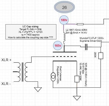

Thomas or others, could you help me get my head around how to calculate the capacitor value for the LC coupling ? I've attached the start of a diagram for a simplified amp : 26 LC coupled to 71A.
Rather than find a formula, I want to try and understand it from first principles. The second picture shows how I think the amplified signal flows to the grid of the 71A - again do I have this basic grasp right ?
The Choke reactance formula I know : XL = 2*pi*F*L, so at (say) 5Hz its 12723
Capacitor reactance formula is : XC = 1/(2*pi*F*C). If I set these equal and solve for C = 12723 / (2*pi*5*12723) this gives 2.5uF?
Perhaps the capacitor reactance should be set equal to the choke reactance in parallel with the 26 rp (estimated at 7400 at 165 plate).
I feel like I'm getting close to understanding parts, but putting the whole together wrongly. Someone put me on the right path please ?

This formula doesn't take the 200k (chosen arbitrarily) 71A grid resistor. This link
https://www.tubecad.com/2014/09/blog0308.htm
gives a formula of 159155/(F*(rp + Rload), which gives 0.15uF for 5Hz. The formula is for a different circuit so may not be relevant.

Am I overcomplicating this ? Is it as simple as...
1/2*pi*R*F
where R is (in this example) the 200K grid load ? This gives a cap requirement of 0.16uF for 5Hz

Sorry for the multiple posts ... I think I'm getting there. Would appreciate a quick confirmation if I now have this right.
This article is nice and clear ...
http://circuitcellar.com/wp-content/uploads/2012/04/Honeycutt-AXapril2012.pdf
C = 1/2*pi*f*(Rs + Rg)
where...
Rg is the grid resistor
Rs is the source impedance = rp*Rp / (rp + Rp)
rp is the source valve plate resistance
Rp is the source valve plate load.
With a choke, Rp is presumably the choke inductive reactance, ie 2*pi*f*L. So I can plug that into the above formula or more usefully perhaps into a spreadsheet.
Using
rp = 7400
Rg = 200000
L = 405
I calculate the following cap requirements to set the -3db corner at these frequencies ...
F C
1 0.79uF
2 0.39uF
3 0.26uF
4 0.19uF
5 0.16uF
