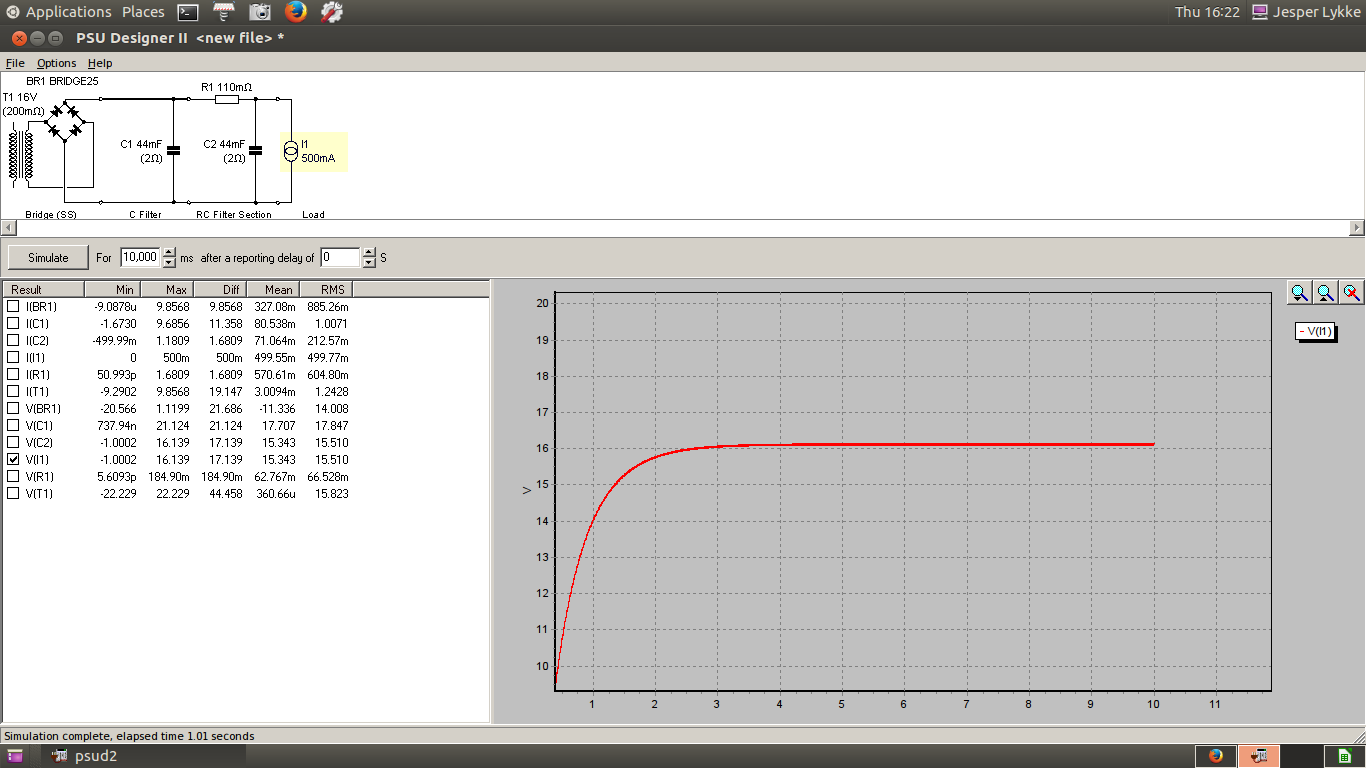

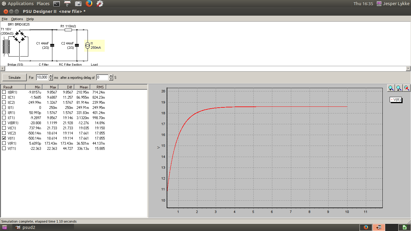

Duncans psu
So trying to simulate, the psu i got now.
If i set load for current 250mA then output voltage is very near the real life setup.
But i guess 250mA is far from, what one channel AlephJ mini draws ?
EDIT :: Also attached with 500mA draw, then voltage drops way below real life setup.
Any explanation ?
Jesper.

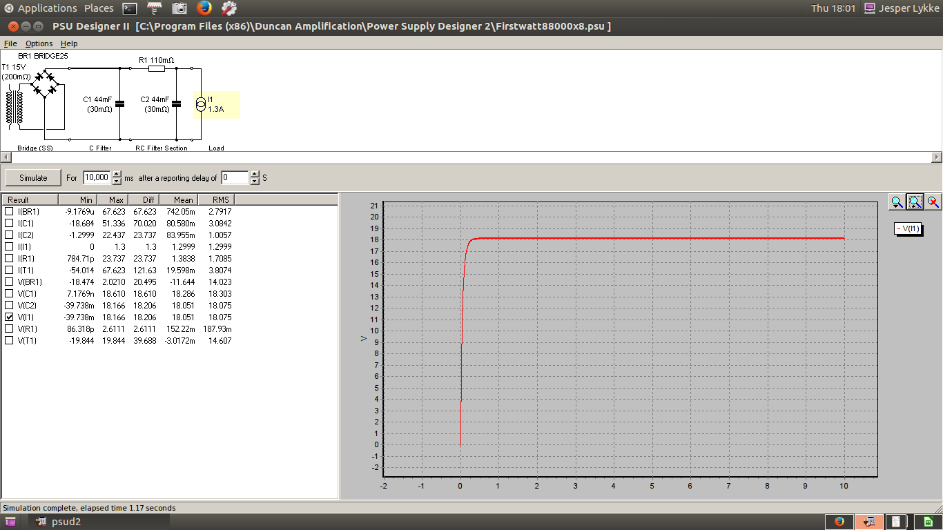

fiddle with xformer data
use F1 key to learn how to do that
also - caps impedance - read from datasheet ....... 2R is waaaaaay too much

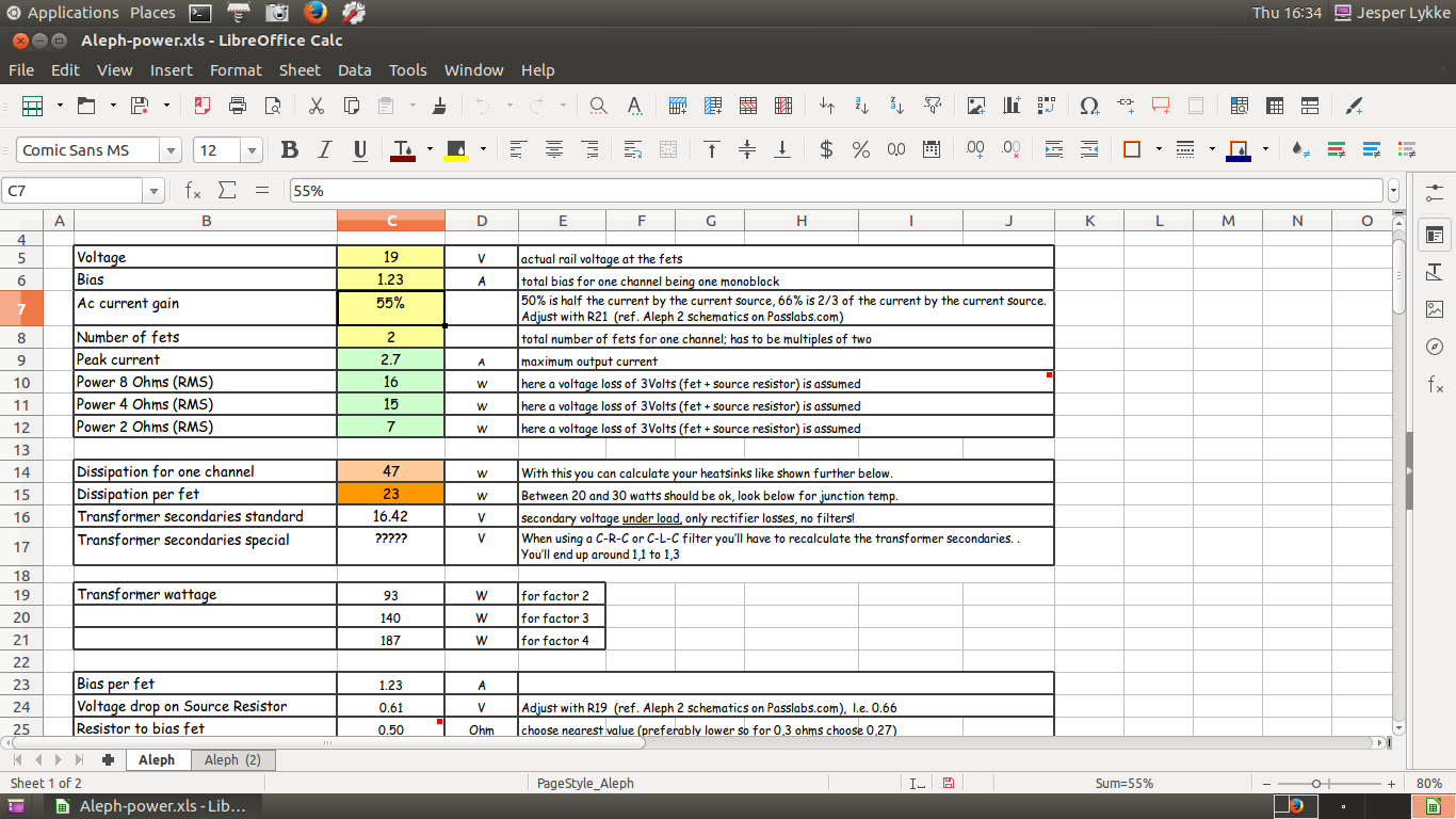

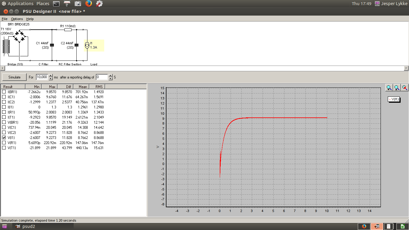

Btw. : I just meassured with serial true-rms dmm = 1,3A (one channel)
Jesper.
and question is ?
None ... Got them answered in Jumas thread...
Any comments on that psu!
Jesper.
