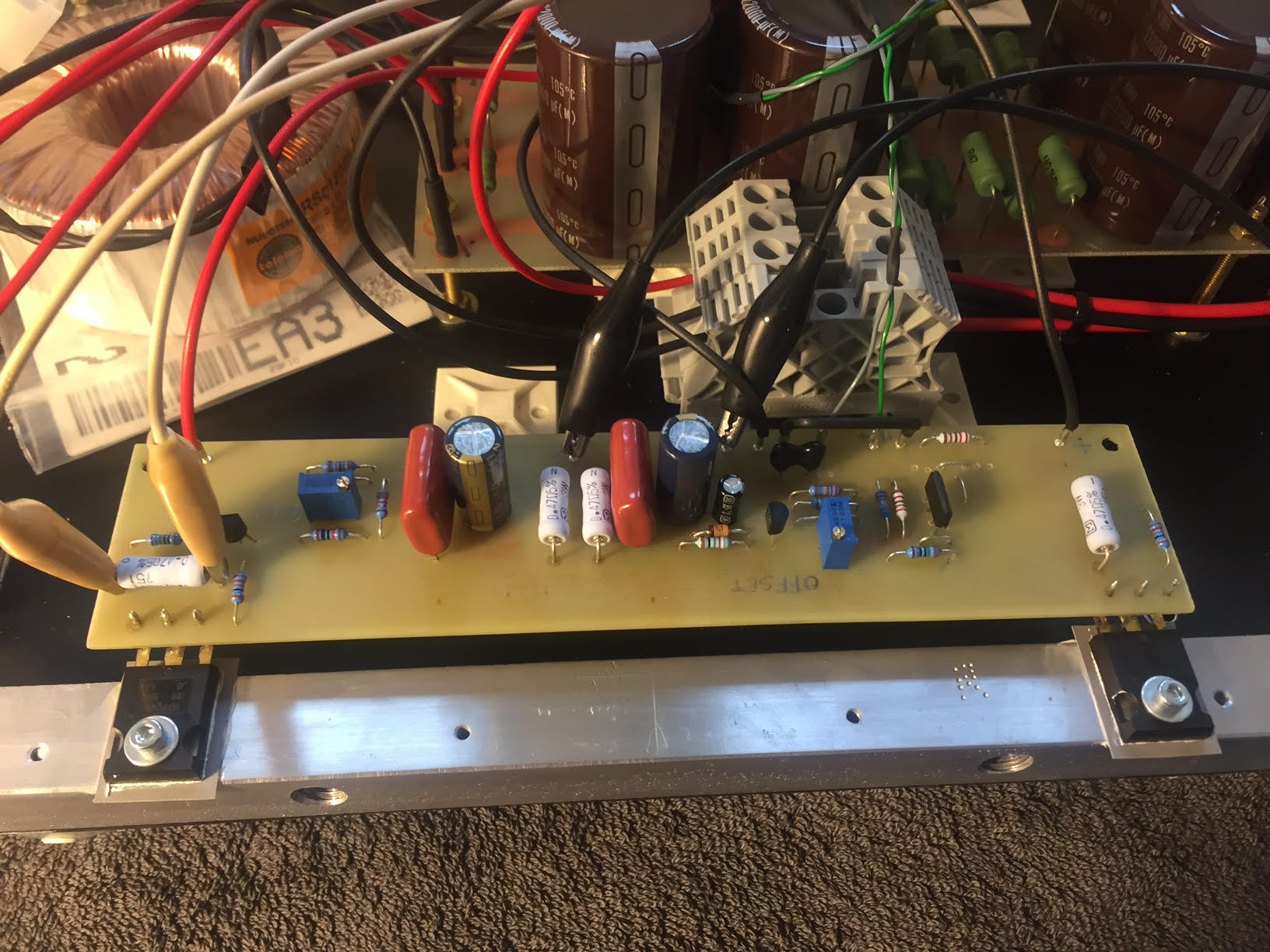

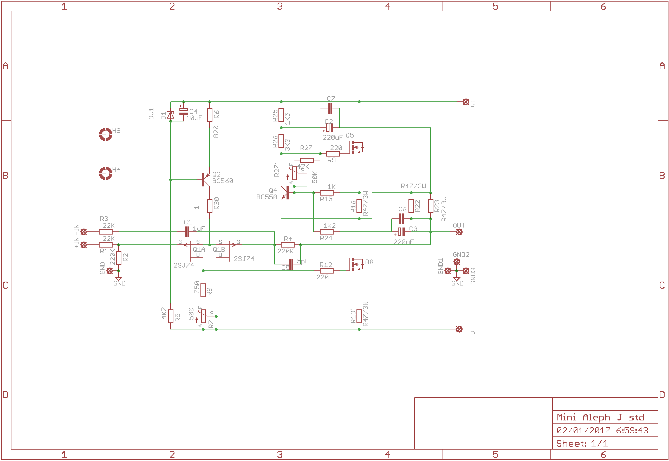

I assume that this is the right procedure, when testing/powering up ::
Short -IN and +IN to GND
Plug in mains (Variac, lightbulb is only for Sissy 😀)
PSU is +18 - "0" -18 VDC
Meassure voltagedrop across R16 (Source resistor Q5)
This is BIAS, but howto calculate this ???
I expect this voltage to be around 0.5V for Bias >1A ???
Bias is adjusted with R27 trimmer.
When everything is good, also adjust DC-offset with R7 trimmer.
Normal procedure after that, let amp. warm up and settle, then readjust and see if everything is stable and temperature is not to hot (>55C)
Jesper.
pretty much - yes

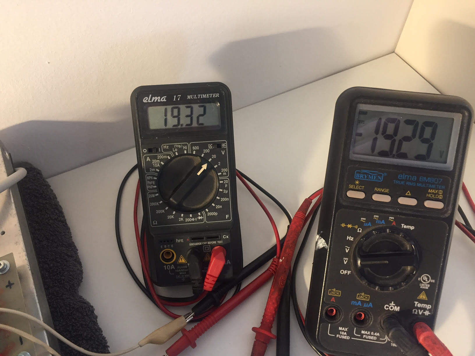

I powered up our little AlephJ (Renamed to Alepj_Mimi!)
Accecdentily i renamed some pictures to _Mimi!, so hereby a new name... tadaa : AlephJ_Mimi! ... Cool yes ? 😛
Some of the parts are slightly different from schematic, but not much; i will ofcause post that later on, when prober testing is done.
Bias is easily adjusted, up/down around 0.6V (1,27A Bias)... I figured out that voltage divided by sourceresistor (eg. 0.6/0.47 = 1.2A)... Silly me i should have know that before i asked that yesterday Sry...
After a short while, without prober heatsinking devices are heating up. DC-offset was a little jumpy for a start, but after 30sec. it was also good enough to adjust... So i guess circuit is working.
Next week i will try mounting heatsinks, and ofcause adjust the thing for good.
Thanks everybody for helping me, get this far by now.
Good sunday!
Jesper.

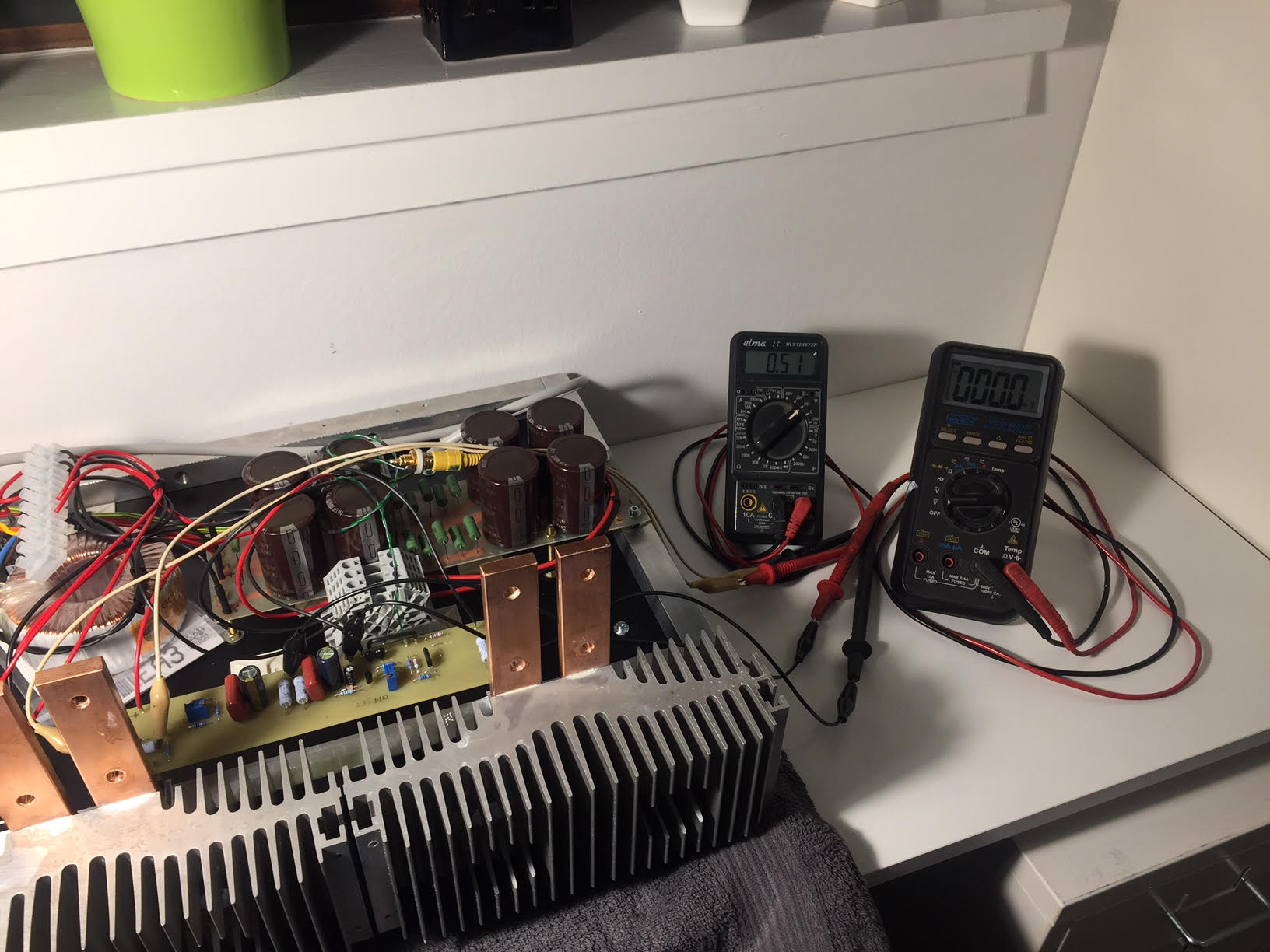

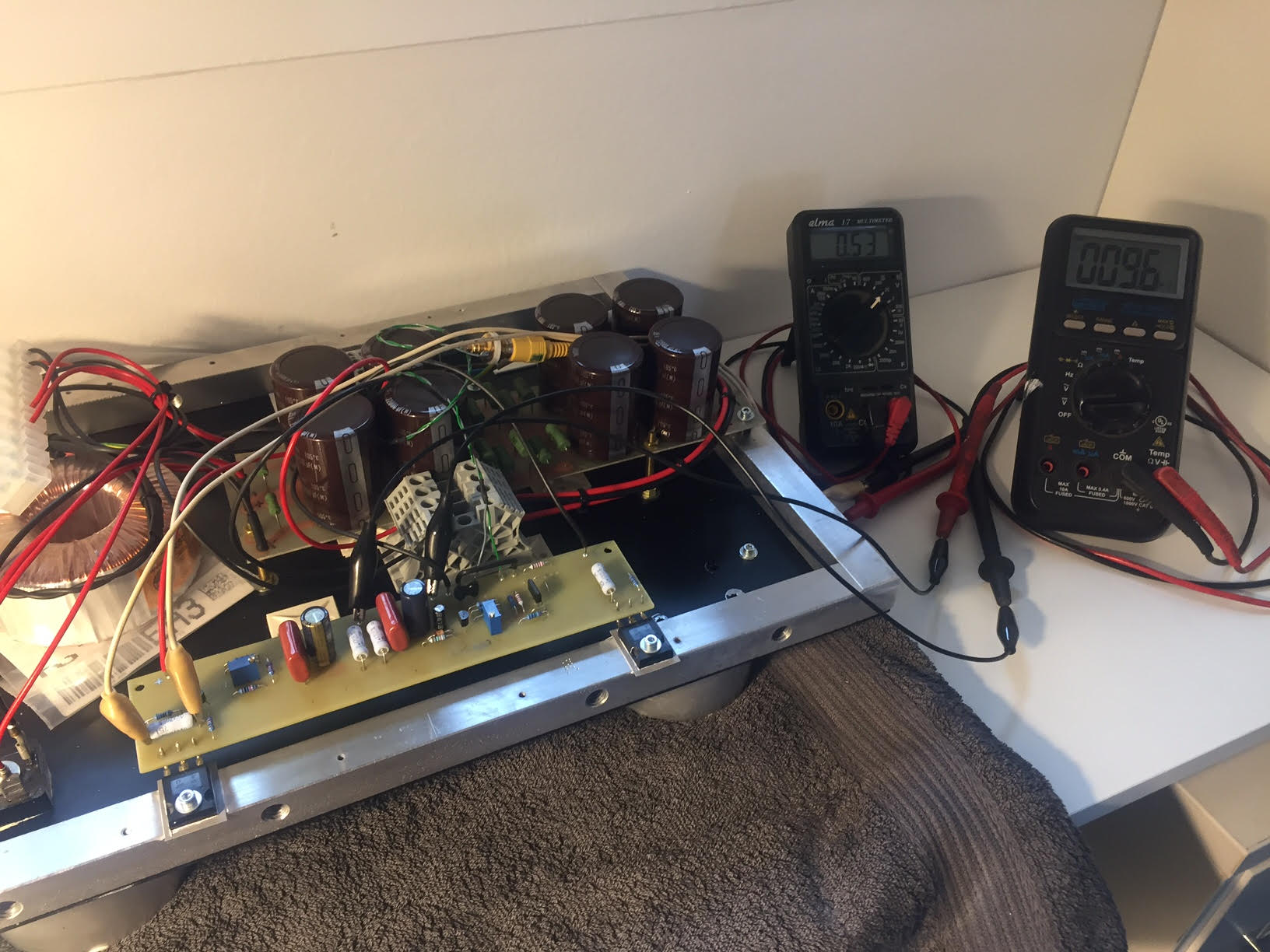

Morning.
I have mounted some heatsinks, which size should match the dissipation (i hope), for our MiniAmp. here.
Rail is with this PSU ~ -19 "0" +19 vdc.
I tried setting bias at 0.61 (~1.3A), but source resistors/mosfets are getting hot to the touch. Setting Bias around 0.51 (~1A) is much better.
I just remember, that i read somewhere Bias should be set to no less than 1.2A ? -Can't remember where i read this? -And why?
Can someone comment on this ?
- I mean, what is pros and cons ?
- Later today i will try listning to some recordings, to hear if Amp. is swinging enough watts for my setup!

At 1.3 A, 0.47Ohm resistor is only dissipating 1.3 x 1.3 x 0.47 = 0.8Watts
Set at 1.3A and stop worrying about it.
This is a single ended amp (not push pull), you want as much bias current as the mosfets, and your heatsinks allow, so set at 1.3A and stop worrying about it.

Hi.
I see the point here.
Running at 1.3A will give near 25w pro mosfet, and 100w for stereo, which is i think perfect.
I will start it up again and cranck bias to 0.6 now...
Too be continuied 😛
Jesper.

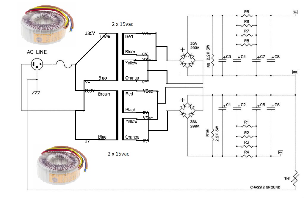

Hello.
For testing two channels, i need a bigger torrid than the one 120VA i got now.
I am planning to do dual PSU in one chassis.
I can still source a torid like the one i allready got, so two identical torrids.
But i am in doubt if it's possible to use two torrids on the same PSU, for testing.
It will be some time before i will make new psu boards, so testing with my old one, would be nice!
Anybody know that???

I would believe them (enough for paralleling of secondaries) only if they're wound bifilary
in any other case , each secondary get dedicated bridge , then do whatever you want
good thing is that you can use smaller bridges for that

So looking at datasheet of that torrid, say's parallel and seriel is possible.
I also once paralled a torid, without problems.
Quistion is more about, how psu is reacting on this?
