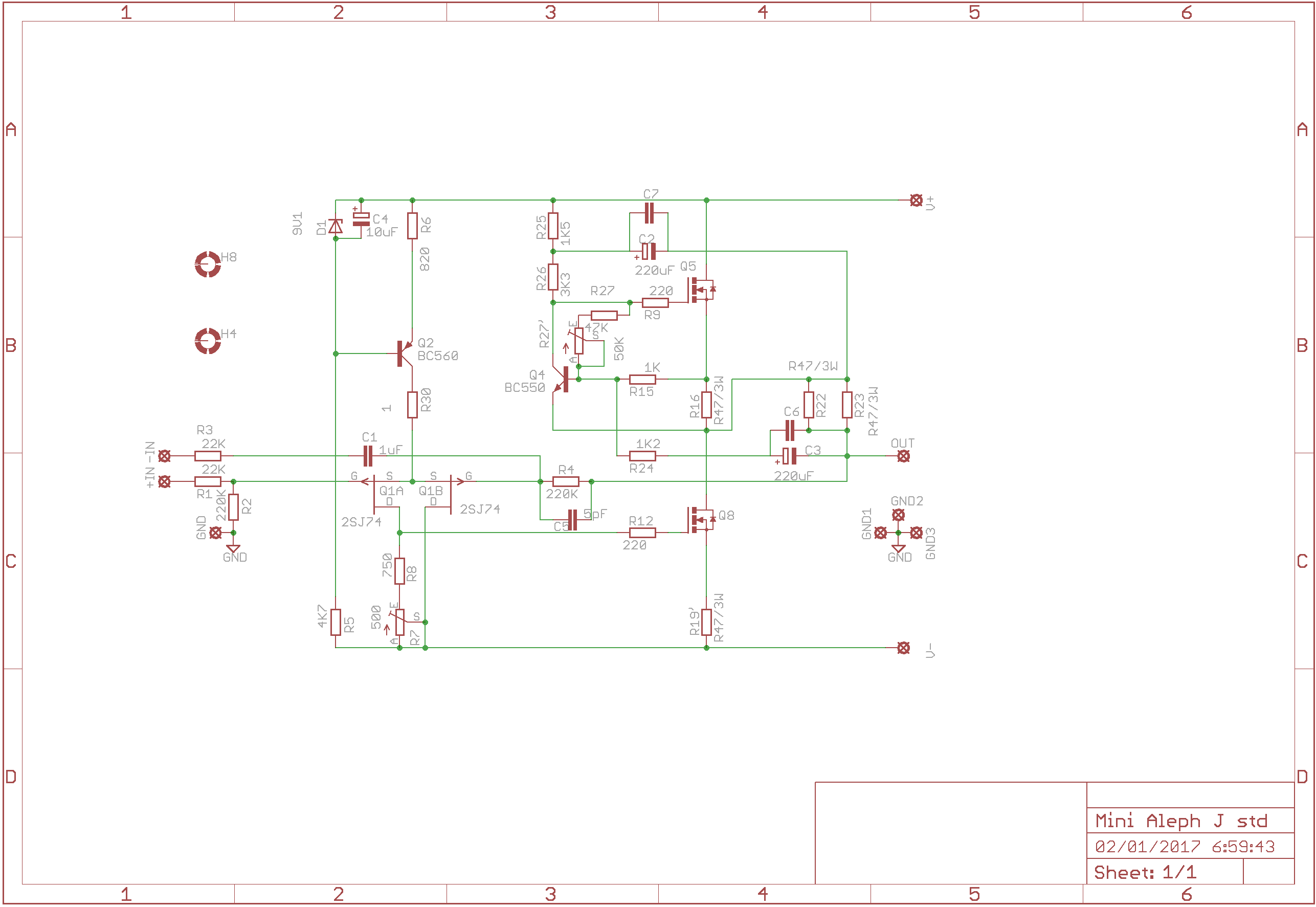

So i stuffed up my second channel, and gave it power.
Everything seems at first to be okay, so i set bias and offset to near the same as the other working channel. -No problem so far.
Then i tried to attach my cheap pc-speakers; and my source and gave it some music (excatly as i did on first channel).
What i noticed right away, when i powered it up, was some humming (no music) and right after that the source resister R19 at Q8 gave some "magic" smoke 😱
I ofcause powered it off imidiatly, and after that it cooled a little of, i shorted the input again and powered it on. -I think everything is okay at this point, i am not sure but maybee the Q8 heats up faster than it did before? Bias + offset is allright (allthrough offset is a bit jumpy)
So it looks as the amp. fails, only when a source is connected. If i connect speakers and still have input shorted, everything seems okay still.
Well, i can ofcause plugin the working channel and take some meassurements there. But before i do that i really would like to understand what is happening here? -Can anyone here help with some meassurement? -Or maybee explain how the circuit works, making me understand better what happens when source is connected and music applied! -I feel i could be better prepared for this fault clearance if i now better how circuit is working.
thanks in advance.
Jesper.

Is it possible that you write a little explanatio, what Q8 does in this circuit? I cant figure it all out...
Jesper

Oscillation burst when an input interconnect is present. At power on until the bias settles gives R19 a fast massage and then goes away.
If i just think, i would replace the two bjt's (bc550+bc560), and the Q8 mosfet + its source resistor (R19) .. I hope not the 2sj109 is gone (this one has been working in another circuit i know, but could have been damaged desoldering?)

recheck all solder joints , all connections , mosfets mounting (both tightness and non-connection with heatsink)
all resistor values
replace those jumpers at gates with 470R-1K resistors
that,as first step

Resistorvalues checked, mosfet connection checked

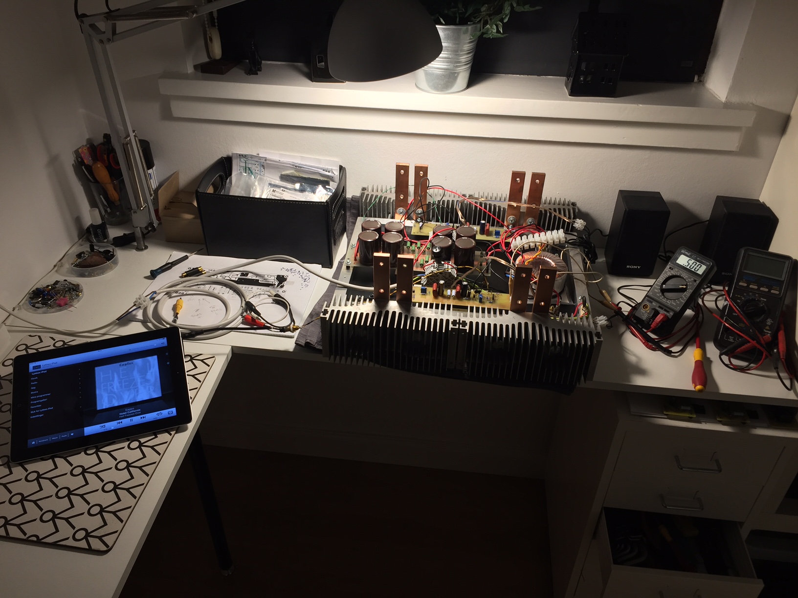

I unfortunately haven't much time this evening, but i tried firing it up again, and set the bias at 0.5vdc. The Meassurement is the same on both R19 and R16. R19 and R16 are sourceresistors for Q8/Q5.
I then clipped on my DMM on sourceresistor R19(Q8), and plugged in my Ipad, which i use for source on testbench. Now i meassure 0,5vdc here. When powering up, the voltage imidiatly raised to 1,8-1,9vdc (3,8A/72watt :flame: call this burning amp.) -Voltage on R16(Q5) is still 0,5vdc(Bias)
When unplugging the source, the voltage goes back to 0,5vdc.
So long story short.
Q8 and R19 goes high as soon source is connected, and therefore i saw some smoke from that sourceresistor yesterday.
Jesper.

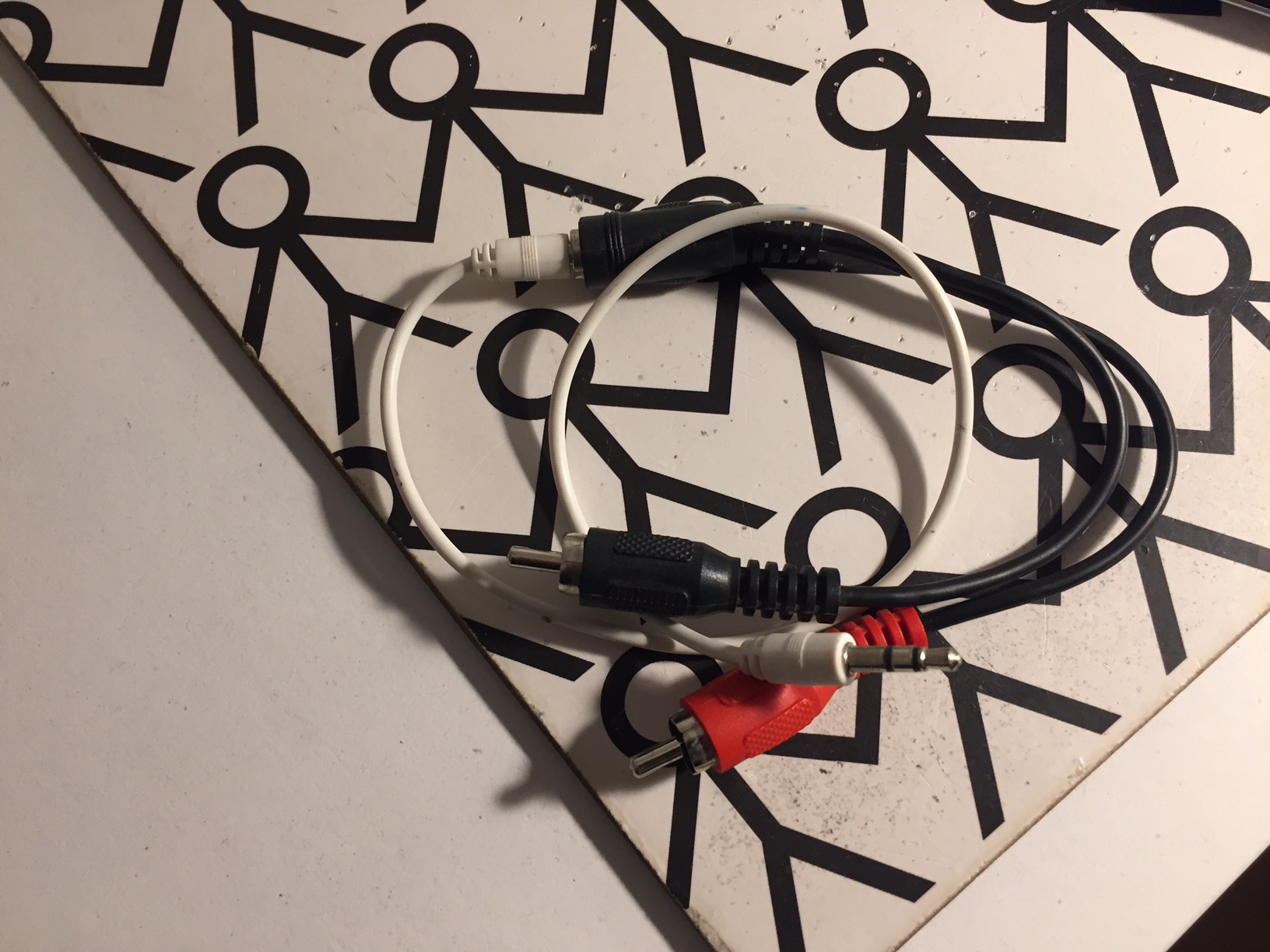

I solved it...
There was no fault at pcb, the fault was the cable connected from the ipad 🙂
The first channel, which worked right away, i used another cable for testing. So while i was scratching my head i throught it could be no harm trying the "old" cable.
Everything is working now, and it plays music like the first channel.
I take this cable to work friday, to figure out what the problem could be with this cable???
