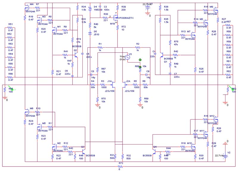

Here is the version I am going to build
Ok, to give this threat again some life and having played around now with Pspice for some time, here it is.
Ratings:
voltage 22,7 volts actual rail voltage at the fets
bias 6,4 amps total bias for one channel
ac current gain 50%
number of fets 12 total number of fets for one channel
Peak current 6,4 amps maximum output current
power 8 Ohms 107,1 watts
power 6 Ohms 122,9 watts
power 5 Ohms 102,4 watts
power 4 Ohms 81,9 watts
power 2 Ohms 41,0 watts
Dissipation 290,56 watts
Dissipation per fet 24,21333333 watts
Transformer secondaries 17,46 volts for 1.3
18,92 volts for 1.2
20,64 volts for 1.1
22,70 volts for 1
Transformer wattage 581,12 watts for factor 2
871,68 watts for factor 3
Source-Resistor 0,47
Frontend with jfets for better sound. I have simulate the frontend with the 9610 and with 2sj109 in comparison and if you get them to the same squarewave-response, the jfet has even a better high-frequency response. In reality the value of the small caps need to be varied, but it shows that the jfet-front-end should work nicely as well.
The change of the feedback-resistor gives as well better high-frequency-response and the change of Ian's resistors from 4,7k to 1k gives better squarewave-response.
Any comments on this (especially from someone who has built it), is highly appreciated.

Thanks, Blitz!
Your schematic drawing is beautiful.
Why do the wattage values drop when the speaker impedance is lowered below 6 ohms? I'm planning on building 4 LAB sub horns per channel and they are driven by two 4 ohm speakers each. Because of the acoustic loading on the driver the ohm value will be higher, but I'm still going to need an amp that can play into less than 1 ohm load.
Crazy huh?

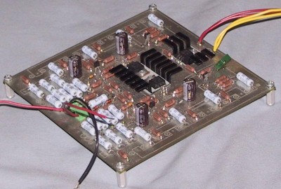

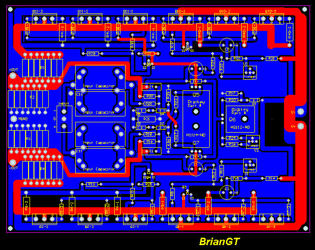

I started a version of the Aleph-X pcb a while back with 2 or 3 devices per bank, as shown in the above schematic. Here is my current board layout with the 12 total devices. If anyone wants my board layout files (I did it in Protel), I can post them. They are done with the schematic editor, and then routed by hand using their utilities, so they can easily be modified to accomidate other's needs.
I was going to make a high powered version, but since playing with lowered power designs, I found out that my speakers don't need more then 50W per channel to be happy.
Here is a picture of my last layout. I have more pictures in my gallery at:
http://brian.darg.net/aleph-x
I made some board for the 8 devices per channel, but never finished it.
Brian

Well, if rtirion does no have an issue with 1k and the simulator even prefers it, what is the problem then ?
Brian: It would be great to have a pcb. As it becomes a hot amp: Would you separate input and output-part like kristijan did it for the Aleph 2 ?
Best Regards
Brian,
The board looks good. Just a couple of comments, how about some local power supply decoupling capacitors and more space around the mounting holes.
I for one am ready to place my order when you are ready.

Your layout for the Aleph-X with 12 devices looks excellent! The only thing that I would suggest from looking at the photo of your 8 device board, would be to open up the spacing between the paralleled "output" resistors. Also, it would be great to have the pads for the IRFP044 output devices closer to the edge of the board for easier FET mounting. Otherwise I would be MOST interested in a group order of this layout, as would many of the people reading this thread, I suspect!!!:nod:
Andrew
