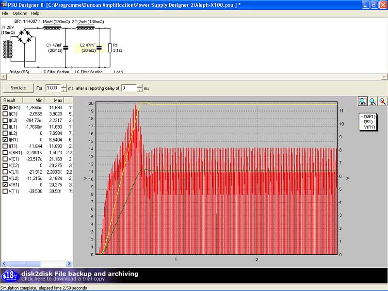

Ok, To give this threat some new life: Here you find a choke-input-configurationn for the previously posted 100W at 6 ohm comfiguration with 19,5V rail voltage and 6,3 A. Obviously you you lower the 26 V of the transformer to 24V-25 V if you would use Schottkys.
The configuration is by purpose a choke-input which in my experience sounds better and here you see as well why: The peak current for the transformer and the bridge rectifier is with 8A very low compared to a pi-filter. If you want to go with a pi-filter, tha simulate it your self with psu-designer from www.duncanamps.com.

With such a choke-input you are giving a way a lot of the initial voltage, aren't you?
Doesn't it mean that a lot of heat is dissipated by the first choke?
In what way does such an arrangement sound better?
Is the huge value of the input-choke neccesary?
Yes, but nothing is for free. In a pi-filter you "get" more voltage, but you increase the current rating of the transformer as well.
No, this is not lost energy as we transformer voltage and current only differently than a pi-filter. But the choke should be of good quality not to generate any vibrations.
Instead of up to 45A current peaks, you have only 8 A peak in normal operations, so much less stress and HF-garbage coming from the diodes and transformer. Less technical sounding, less harsh. Less solid-state-sounding.
Yes, maybe you can get a bit down, but I wanted to be on the safe side. Here are dozens of threats how to calculate the min. inductance. Search for choke-input.
Best Regards

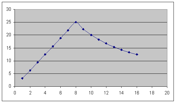

Warning about supply voltage and bias current calculations
One thing I want to add:
when you calculate the output power of your aleph-x, either using formulas or an excell file, for 2,4,6,8 ... ohms, you should better make a graph with the power function to the load impedance
I've seen many of you who have made calculations for their speakers, in example going from 6 to 8 ohms, telling:
so, with X volts and Y amps, i've got:
98W in 8 ohms
97.3W in 6 ohms
but what is between 8 and 6 ohms? certainly not a straigh line, but a peak!
I've made a graph, using berekening1.xls, and the power/impedance is shown at the bottom of my post.
You see that at first you have a current limited mode, then a peak, and after that, a voltage limited mode
Power limits
Interesting graph.
I would be interested in whether anyone has conducted any listening tests of this circuit under different limiting conditions. For example, does the amp sound different when current limted as opposed to voltage limited. I'm curious as simulations show some pretty bizzare behaviour when current limited.
BTW, I realise that no sane person would intentionally operate their amplifier in a severe limiting condition (not good for sound quality nor speaker life!) but even so, under some music conditions an amplifier may well approach or reach such limits. I guess the real question here is that if we have to run near one or other limit, which is to be preferred?
Ian.
I think that running it far from any kind of limitation is the best
Tell me if I'm wrong, but if you run it in non limited mode, you'll have a flat top for the curve I've shown
Am I right?
If I am, that's the way we should run our amps

You will not get a flat top to speak of. Pick your voltage and
bias to get the peak figure you want, and welcome to the
world of single-ended Class A.
