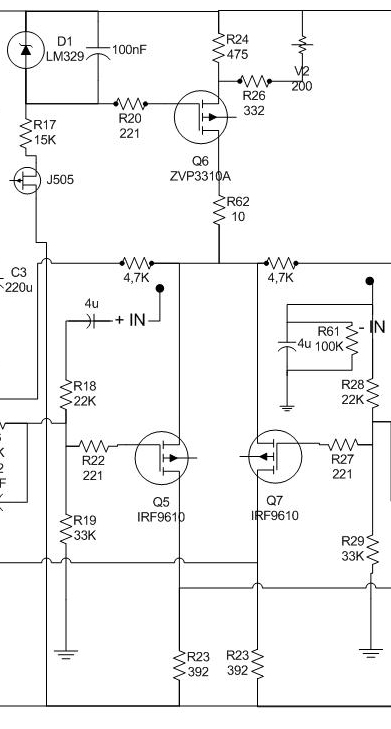

Current Source
OK, guys, I have just realized that the Version 1.0 has been downloaded about 100 times now, but no one has any comments ? Well than let's have a look together at least at the current source. I changed it now to the version hifizen is suggesting in his beta-version 0.9: So, It is basically Fred's version with connection to the negative rail. Clearly, this is nothing new, but should serve me / you as a wrap-up how the circuit would look like. I guess the resistor values need to be adjusted as we have changed the rail voltage quite a bit. Is there anyone out there with a simulator who give us the right values (wold be great to have it for 22,7V and 19,75V)?
THanks & Best REgards

Since there seem to be very few comments forthcoming on your high power circuit, I thought I would chip in with something. I suspect that the lack of opinions has more to do with the time of year than any lack of interest.
I've only had a quick look at your circuit but one thing strikes me as indeed it did for Grey's circuit, and that is the inclusion of V1, R11 and V3, R33. I appreciate the need for some form of differential current adjustment but these parts can easily cause more problems than they solve.
Others, including Grey, have mentioned that these parts are not strictly necessary, but I would go further and say they are best removed. If you model this current source in isolation, you will see that the current is not as constant as one would like with variations in voltage across the current source (as opposed to at the intended control point). This has to do with the variation in current in (and hence in the voltage drop across) V1, R11, etc. as the voltage across the entire current source varies. The net effect of this is to make the amplifier more sensitive to DC at the output and hence less easy to trim for zero voltage.
In my own prototype of Grey's circuit, I have also omitted the over current protection parts associated with Q4.
I haven't yet tried a high power version although it is my intention to do so. Hence I cannot yet comment on what really matters other than through simulation.
Ian.
Ian,
Great to have you here and thanks for your comments. Do you see any issues with the current source itself ? HAve you the possibility to simulate the right resistor values for it ?
