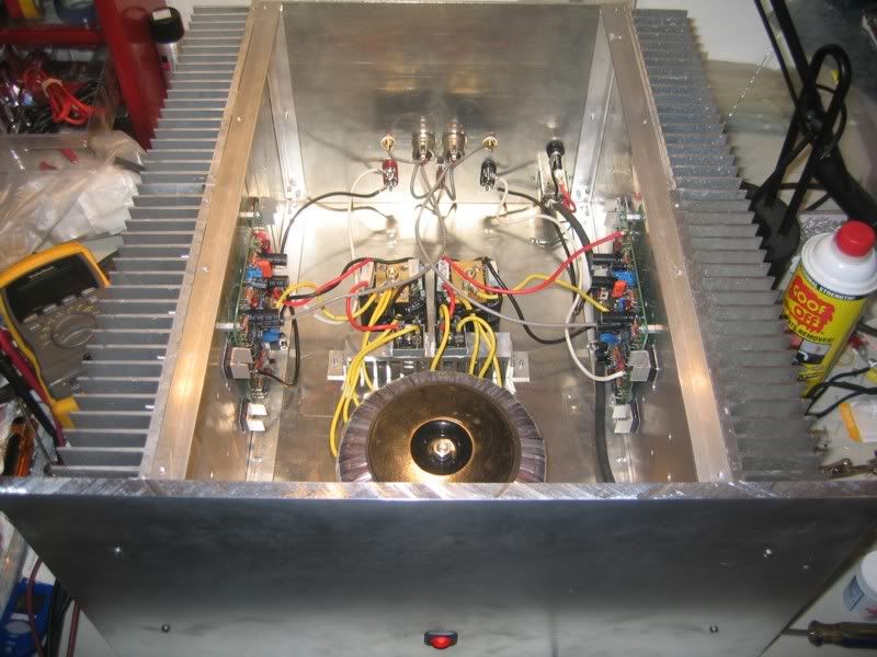

That is a hefty looking heat spreader between your transistors and heat sinks. How did you prepare the interface between the two? There should be grease there and preferably well flattened nearly polished surfaces. That interface resistance could be causing the temperature rise from the fins to the devices.

Hi Bob.
To be honest, I don't have clue what you are referring to.
The only thing between the transistor and heatsink is a piece of kapton tape. It hangs out a tad past the edge of the transistor on all sides to make sure I didn't have any chance of metal to metal contact. perhaps that is what you are referring to. The heatsinks are polished where the transistors mate to them.
There are two large heatsinks per side and they are held together by the 1" X 1" X 1/8" aluminum angle top and bottom. There is one thing I didn't do. The kapton tape I have is sticky on one side. I applied it directly to the face of the transistor and then greased the side that mates to the heatsink. Tonight I will pull it apart and apply grease to both sides of the tape and see how much difference it makes.
I'm thinking I may just need to back down the bias a little. So, I have a couple of questions. Right now, if I understand this correctly, at 0.5V across the 0R15 source resistors and 14.75V rails, I am running at 6.5A bias. If I'm right then if I reduce the source resistors to 0.45V I should have 6A bias. Is this right? Is there any difference between lowering the voltage vs using say, 0R17 resistors and 0.5V drop? Could I go as low as 4V if I need to?
I would like it if I don't have to change all the 0R15 resistors. I went to the trouble to match all of them and my relative offset if right at 20mV.
After I posted last night, I let the amp run for another 1/2 hour or so. The heat sinks got up to 60C and the mounting screw measured 105C. You guys have got me worried that this is too hot.

Hi Terry,
I´m probably repeating myself but why don´t you just lower the bias with VR1 and VR3? This is much, much simpler than changing source resistors or the R in the C-R-C!

Well, I don't think the fault is with the Kapton tape. Here's a list from Rod Elliot's site.
Material- Thermal- Electrical- Thermal Resistance -Other Properties
mica- Good- Excellent- ~ 0.75 - 1.0- Fragile
Kapton- Good- Excellent -~ 0.9 - 1.5 -Very robust
aluminium oxide- Excellent- Fair- ~ 0.4- Fragile - easily damaged
beryllia (beryllium oxide)- Excellent- Excellent- ~ 0.25- Toxic
Sil-Pads- Fair- Excellent- ~ 1.0 - 1.5- Convenient
I think I just need to lower the bias.
I will try to do it with V1 & V3. That is what I was asking about above when I said to drop the voltage across the source resistors.

Hi Terry,
1-1.5 for Rth means 1 to 1.5°C per watt so in your case 50-75°C over the heatsink temperature. (wich almost fits)
I would try to put the grease on both sides first,
If that doesn´t work maybe you can try the Kapton foils from Fischer wich come with grease applied. The are specifies as having 0,07°C/W Rth wich is almost 20 times less.
I´ve used them on my Aleph5 and Aleph-X and measure less than 10°C difference between the IRFP240 case and the heatsink at 30 watts dissipation meaning an Rth lower than 0,33.

Oops - early morning post - I mistook your angles on top for a plate of aluminum.
I stand by the part where I suggested moving your outputs closer to the center of each sink. I'll be that you find quite a temperature gradient across them
Hmm…you could be right about that Kapton, it’s probably just me who was suspicious about ‘sticky tape’, not really designed for that purpose.still4given said:Well, I don't think the fault is with the Kapton tape.

Hi William,
That's good to know about the case temp. If those figures are correct I guess I'm in the right range. I had 105C case temp and 60C heatsink 105-60=45C. I would guess that my Kapton tape is working then.
By the way, this tape is what I used. I will try grease on both sides and see what difference it makes. While I'm at it, I will try some mica insulators on a couple to see if there is any difference. I have plenty of mica insulators. I changed to Kapton because I thought it would be better since it's much thinner. I used it on my P101 per Rod Elliots recomendation.

Hi Guys,
OK, last night I greased both sides and adjusted the bias down as far as I could. Weird thing is that the voltage will stay pretty steady until you get below .425V across the source resistors. Lower than that and it gets all squirly and the voltage is all over the place. At .425V it runs about 75C at the mounting screws. I still don't have any 10uf caps for the input so I can't really test the sound. With nothing connected to the inputs, I now have about 2mV relative offset. If I connect the preamp it goes to 3V offset. I htink I had better wait until I get those caps installed. If I can't get the temp down to a reasonable level I mahy add some more FET's.
Blessings, Terry

so now you are at 5,7A instead of 6,6A.
Dissipation per device is now 14,75V x 2,83A = 41,8W instead of 49,2W (17% less)
If the screw now is 75V what do you have at the heatsink? You could calculate the new Rth with the grease applied to both sides.
(Tscrew-Tsink)/42 = Rth from case to heatsink.

Hi William,
OK, last night I got a chance to do a little more testing. I couldn't find any bipolar 10uF electros so I used polarized. Seems to work fine. Sounds good anyway and got rid of the DC offset when connected to the preamp.
Now as to the bias voltage, when I set this last I had .425V across the source resistors. Last night when I fired it up I read .485V. I checked the absolute offset and read 14.3V. Then it would swing to -9V, then back to 14V. After it all warmed up the absoute settled down to aroung 2V or less. It never really settles though. The relative offset started out around 60mV and dropped to 23mv after it warmed up. I've never had an amp with this much variance.
It runs more stable at about .450V so that is where I have it set right now. At this setting the heatsink stays around 54C and the mounting bolt for the output devices is at 90C. I think I will just leave it at that for a while and see how things go. It sounds very good right now. It is a lot less powerful than the Krell I built but it plays plenty loud with just a turn of the knob on the preamp.
I may think about adding more outputs if these fail. I would need to change the source resistors for that anyway.
