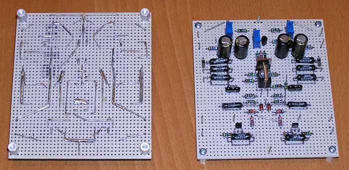

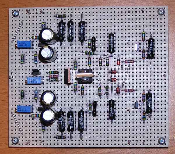

Finally finished building my Aleph-X boards. Wasn't able to find any spare pcb's leftover from a group buy, so I built them on perfboard. For a one-off build, I am hoping it will work just fine.
I am building them as monoblocks, aiming for +/-15V rails using PS boards from BrianGT's miniAleph PCB group buy, 94000uF-1.5mH-47000uF on each supply rail, which should give me about 8mV(peak-to-peak) ripple. Bias will be adjustable, but I am aiming for 0.55A total per channel. This should give about 50W into 8 or 4 ohms.
Here's a picture of my boards.

Re: We don't need no stinkin' PCB's!!!
Metalman,
Nice job on the perfboard! I have a question (as always):
Are the trace "spikes" (you've got ten of them , I believe (see! I can count!)) sticking up through the top of the perfboard all for ground connections?
Idiotically yours,
Kofi
metalman said:Finally finished building my Aleph-X boards. Wasn't able to find any spare pcb's leftover from a group buy, so I built them on perfboard.
Metalman,
Idiotically yours,
Kofi
Kofi,
Actually there are 17 in total (there are 7 that are really hard to see in the photo) as follows:
1 each (3 total) for +V / -V / GND
1 each (2 total) for +IN / -IN
1 for each output transistor gate (4 total)
1 for each output transistor source (4 total)
1 for each output transistor drain (4 total)
I will be taking the output +/- off of the power resistors (It just happens to be a convenient method for the chassis layout that is currently under construction). I am using 4 IRFP044's for the output transistors.
Cheers, Terry
