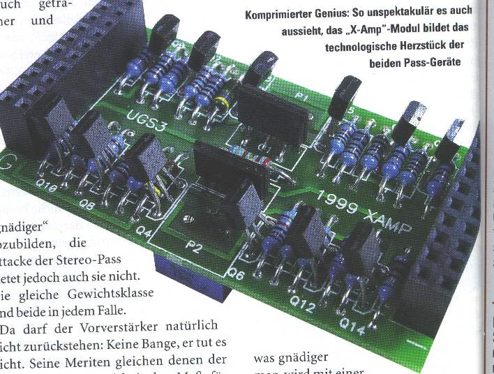

You can see the switch to surface mount in the later
board. The parts we wanted were only available surface
mount.
mount.
