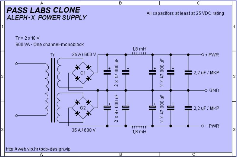

hi, I bought from ebay (Jims) pcb x Aleph X100w. X the psu that type I have to achieve; on the net I found this design, can be good, there are others, can you advise me? thank you
The nice part about the Aleph-X amps is that you can customize their output power to suit your requirements. Have a look at my Aleph-X page (linked in my signature). It contains a protracted start-to-finish resource for building this amp.
hi, I looked at your page .. great work, congratulations. X the PSU, I already own 16 capacitors 47000uf 63v and 2.2 mh inductors on an aleph 2, if I'm not mistaken I can reuse these without having to test on Aleph X, without having to buy those 1.8 mh, right? , already in my aleph 2 I have replaced the rectification bridges with rurg3060, I think it's okay, right? one last thing; in your aleph x have you had problems with DC output on the speakers? thank you🙂
Sounds like you have a great power supply already! The Rurg3060 looks good with ratings like 30A and 600v. I just used generic rectifier bridges with similar ratings and didn't worry too much about it.

on your page x Aleph X you talked about the losses of v due to loads of resistances, chap. , etc. ..so, with my power supply I have to use a 2x18v transformer like in the diagram or maybe a 2x19v or 2x20v. what can you advise me ?? thank you
One of my Aleph-X amps runs on a 750va transformer with dual 18v secondaries. The left and right amps run a 1000va transformer that provides 19v. There is very little difference between them in terms of overall rail voltage and how this translates into max output power. Personally, I wouldn't worry about 1 volt here or there. The bigger item to watch is the temp of your output devices and the size of your sinks. If your sinks are adequate in size, a little voltage here or there and changes in bias don't make much of a difference. If your sinks are running hot (bit too small), you might want to consider CRC with 0R1 or 0R2 or so to drop little rail voltage or decrease the bias setting with the pots. All of this need to balance...
