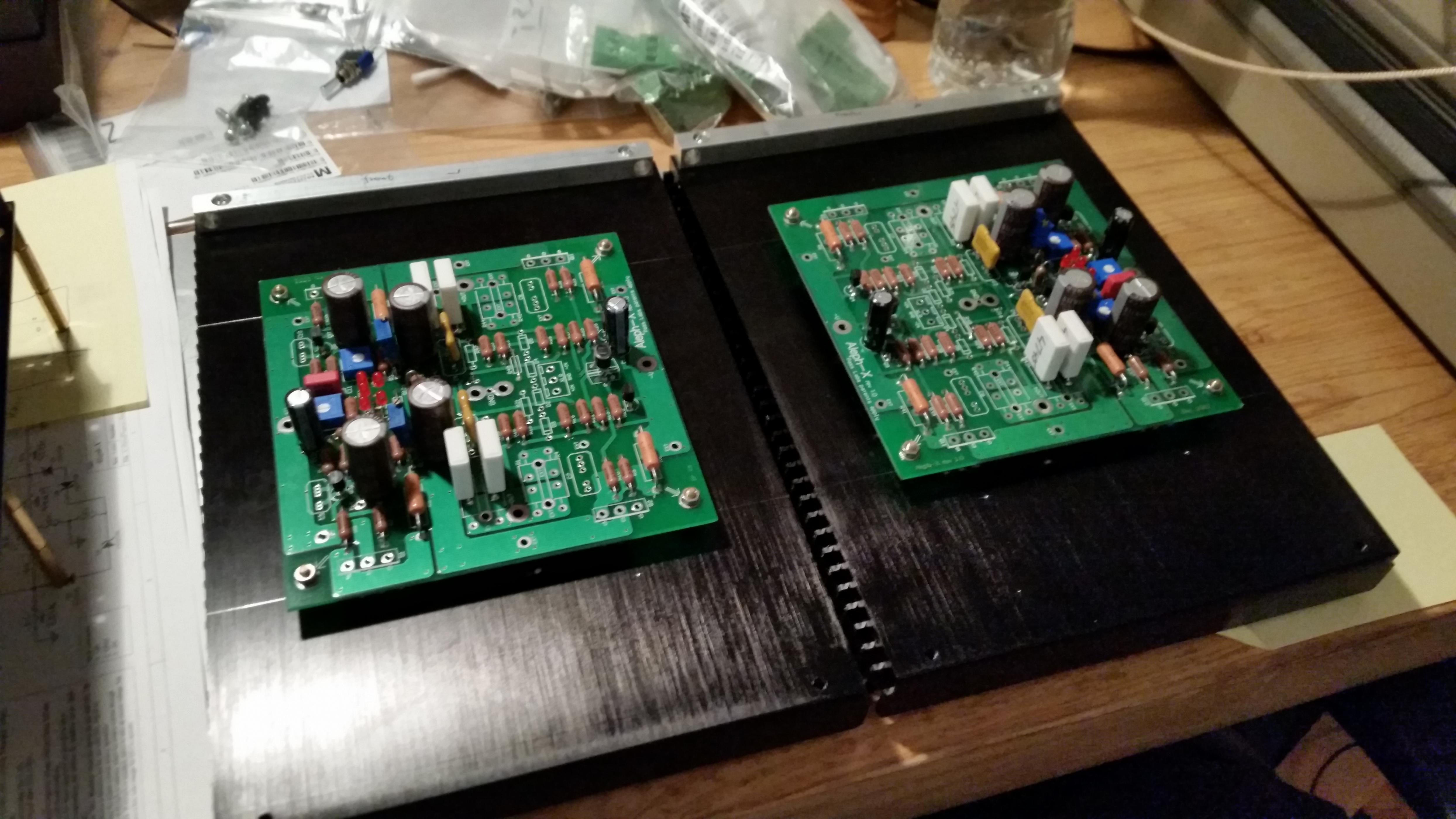

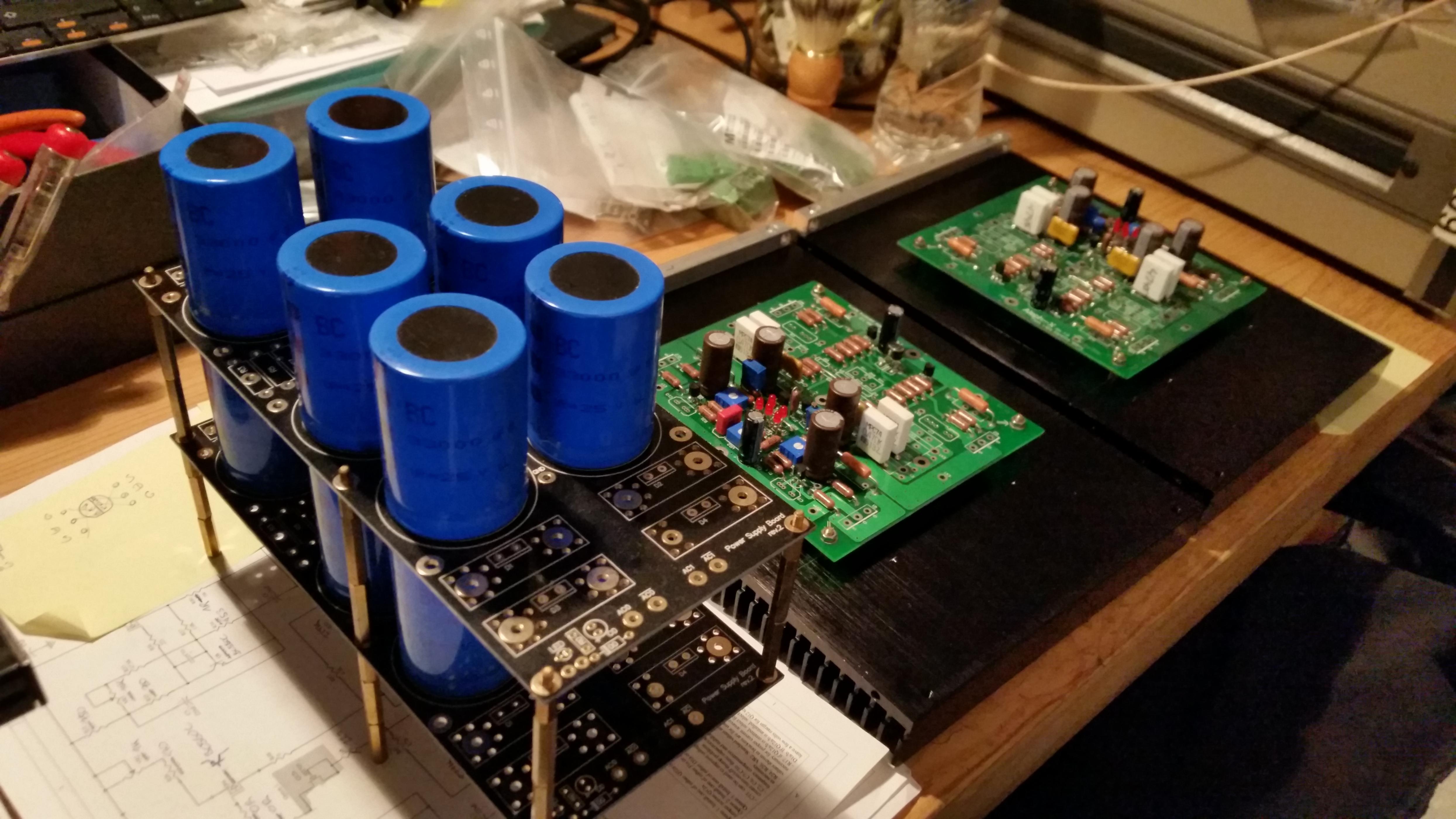

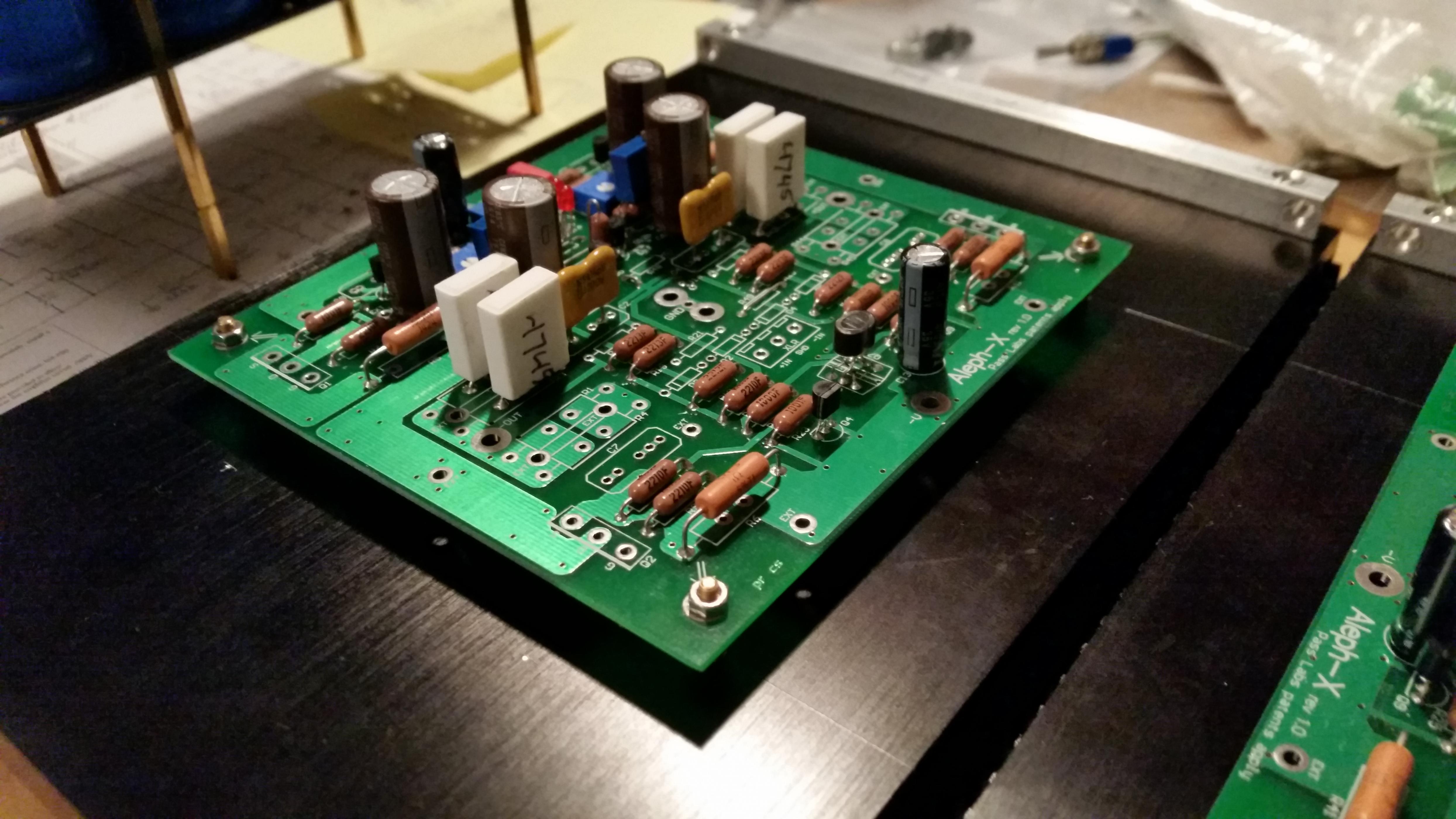

Sneak preview of my upcoming AJXH build...

Target rails are +/-15V DC from a Zen V3 style IRFP240/9240 capacitance multiplier. Raw DC is from a Toroidy 240VA 2*15VAC audio grade transformer hooked up to a single full wave bridge, 12*33000uF (that's like 0.4F) filter capacitance, one reg per rail per channel (four total, C-C-reg-C configuration). Output devices will be curve traced quads of FQP3N30 FETs, biased at 0.5A. It's obscenely overbuilt.
