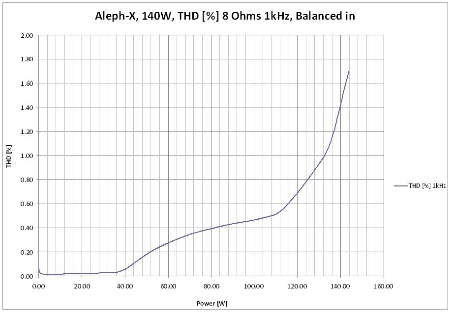

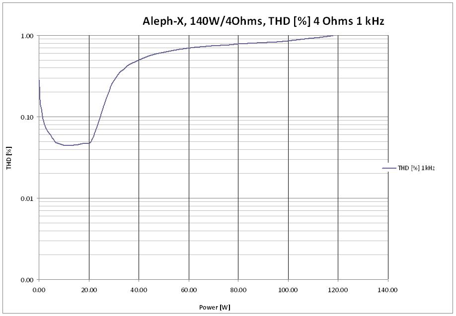

Thanks for the comparison! If you have the time, I'd be interested to see the 4ohm plots your XA160 (I assume this is your DIY version?).
Yes, my DIY version.
Here we go
Pass DIY Addict
Joined 2000
Thanks for the graph, JBL4435. I appreciate you taking the time to do this. Curious the dip and then the quick rise again as power increases... I've heard a number of people comment about lower distortion after changing the IRFP9610 front end to JFETs. I wonder if this makes a dramatic a visual difference...
Yes ... why such a sharp rise after 20W output ....

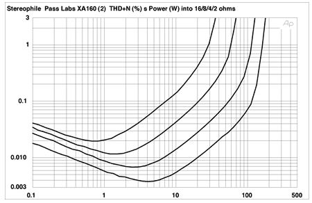

I'll change the graph to logarithmic X-Axis. Then it will look more familar with distortion plots from let's say stereophile.
I'll do this later
I'll do this later
Interesting, I didnt expect distortion to be so high.

It was merely an observation based on comparisons with other high end amp distortion measurements. It was not a judgement on the quality of these amps

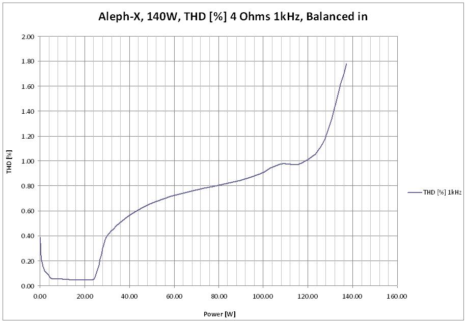

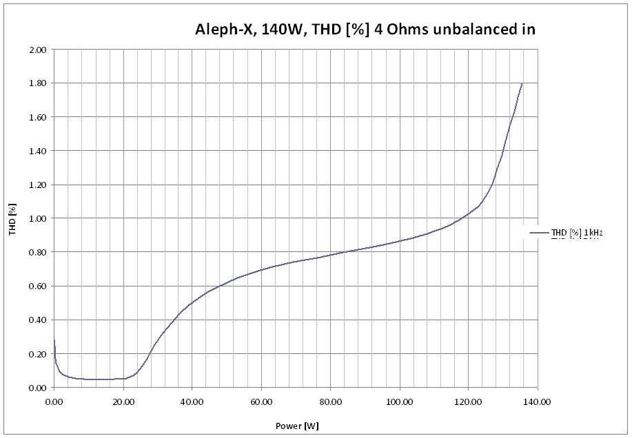

Distortion Balanced in
So, these will be the last THD Plots.
I finally finished my BNC-XLR input cable
THD seems not to change much with balanced or unbalanced in
1st: DIY XA160 8 Ohms load, Balanced in
2nd: DIY XA160 4 Ohms load, Balanced in
3rd: DIY XA160 4 Ohms load, Un-Balanced in

I am surprised there is any difference if your BNC-XLR cable doesn't include a transformer or other single ended to balanced converter. Sounds like you're still feeding your amp a single ended signal, the only difference is where the negative input gets grounded. Try feeding your amp from a balanced preamp. You should see some difference.
I know how to make an 2xBNC to XLR adapter. Would I be able to build an AX amp if not?
I feed my amp from the balanced output of a HP8903B audio analyzer.
Oops. Didn't realize it was a 2x BNC input.
