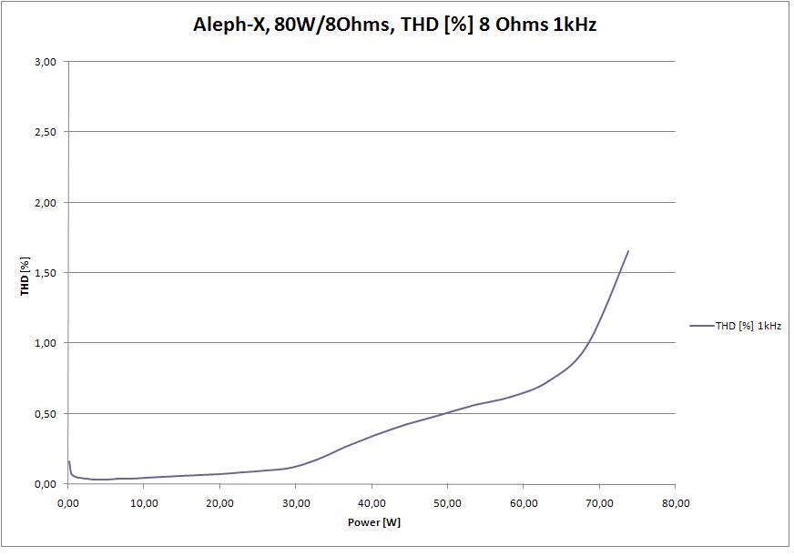

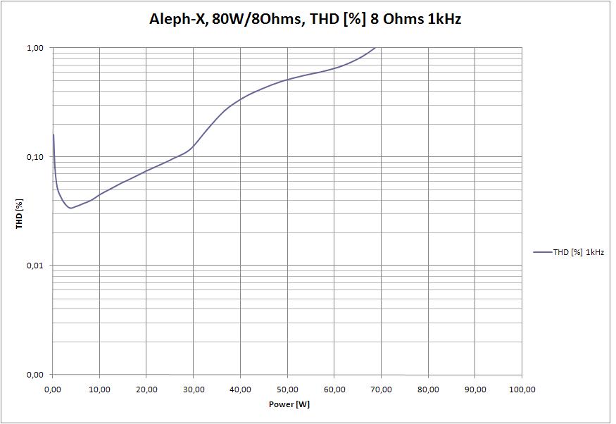

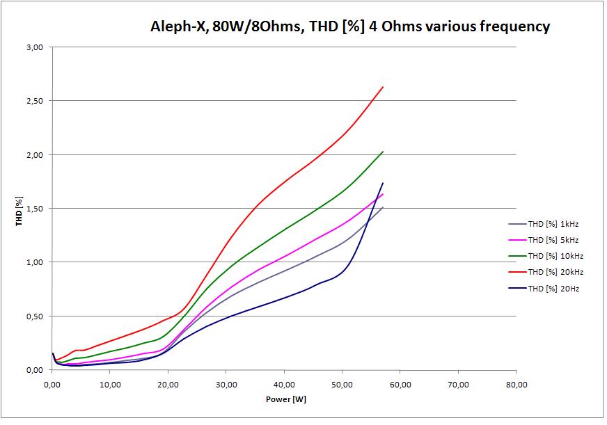

As a THANK YOU! I post some distortion plot's I did with my HP8903B Analyzer.
These are made with unbalanced input as I still have to make XLR Adapters.
It is my XA80 otimized for input into app. 8 Ohms.
I also have another XA160 for 4 Ohms and if there is Interest I'll make these plots also
If you need more, tell me 🙂

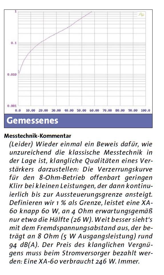

hi JBL4435,
To the untrained eye those distotion plots dont look right to me, any Gurus out there care to comment?
hi JBL4435,
Actually those plots look absolutely right for an AX Amp.
For the non-believers I added a distortion curve of an original XA-60 made by LP-Magazin April 2007

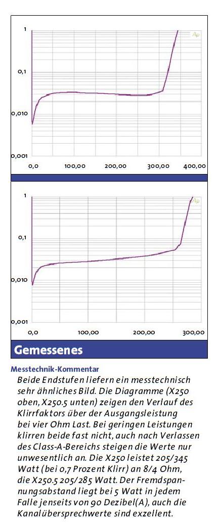

Just for Grins
X250 vs X250.5 from LP Mag 5.2005
Top 250
Bottom 250.5
Thanks for the comparison! If you have the time, I'd be interested to see the 4ohm plots your XA160 (I assume this is your DIY version?).
Its a shame that the plots look nicer for 8 ohms (not a surprise at all), because I've optimized my amps for a 4 ohm load 😀
