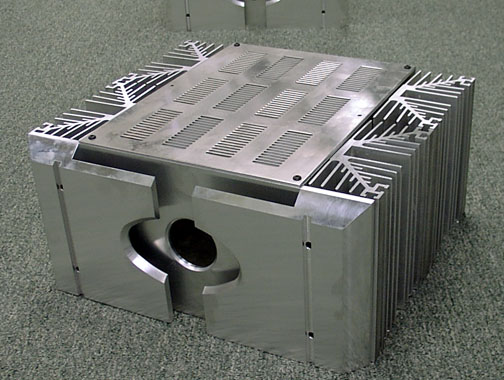

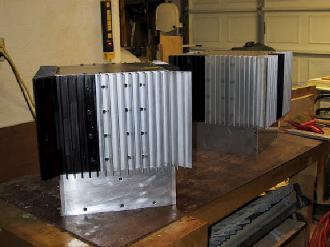

actually, as mentioned before, the heatsinks, top, bottom, and back panels will be black anodized. however, ive heard that a clear anodized will dull the finish. i would love to keep the finish EXACTLY as it is. maybe a kind of polish or something would be the ticket.
thanks for everyone's compliments 🙂 hopefully ill be working on this consistantly for the next month or so. i estimate maybe 2 months left, instead of the 4 as projected earlier.

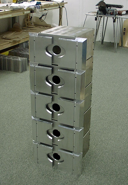

Wow, that's some seriously inspiring case work, great job!
I'd recommend you seek out a stove enameler to finish your faschia's. They will be able to give you a high quality laquered finish that is oven baked. The kind of finish you see on expensive car alloys.
scraggles said:Wow, that's some seriously inspiring case work, great job!
Personally I would not recommend it. The beauty of properly brushed aluminum is when it is in its natural form and not covered by some sort of laquer. You might as well do it out of wood, prime it, do the brushing and paint with laquer. Nobody would see a difference😉
Anodizing would be better. I dulls the finish a bit, but not much, it actually be more uniform and if your brushing is not that deep, it will be still a bit shiny. But of course, it's your choice.
Before doing any serious finishing, try both methods on a piece os scrap and see what suits you better.
most likely, it will be kept brushed, and a small metal rod will be kept close by for anyone who attempts to put fingerprints on it 🙂
Have you found a Meter that will do these cases justice yet?
When are you going to start stuffing these boxes? 🙂

...after seeing your cases... i'm not even going to post pics of
my Aleph 2's!

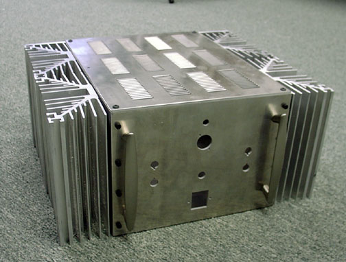

trigon,
i saw handles similar to that, but i decided against them. i liked the ones i put on there. i have a better picture of them, and they look really great.

The chassis really look great, and the stack is very impressive. I have been building some 1.2 Alephs and the machine work is quite a hassel. So how much did a machine shop charge you for the face plates or did you make them.
Also, who makes the Sinks your using, Very Nice Job. Hope the sound as good as they look.

the faceplates were around $100 each. this was a big favor by someone.
the heatsinks are originally from aavid, but we got them surplus from MECI. i forget the profile number, but i found the exact profile on aavid's website.
