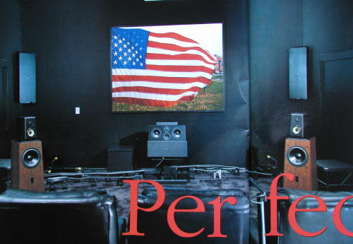

I've read about some serious installations where Grand Slamms were used for rear channels speakers. Don't let anybody take away your vision.😉

most people only do DIY just to get something cheap. im doing it to get the best possible i can afford. most people dont understand the system being upgraded (primare processor and 5 channel amp with sonus fabre speakers), is already like a $15K system... if i just wanted standard class a/b i would keep the stuff and not worry about it.

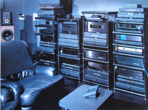

Dear cowarng
Does IQ stand for intelligence quality...?
It seems My IQ is very low.
I am very interested in your theater. I however can not figure it
out. Would you kindly make an easy map showing the theater
layout and post it? If the map also includes the amp and speaker
arrangement, it would be very nice. Thank you.
Please an easy map, not complicated please.
