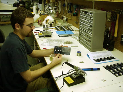

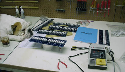

At first I thought that's not a real dog and then I read that it is. You're not worried that the dog might chew up some boards or swallow a couple of resistors? I dunno ... I never work on my bench with a dog around. More pictures of the dog please.
hehe, the dog isnt mine, it belongs to the guy im working with. its a nice dog. he was just whining that he couldnt see what we were doing. he actually stayed like that for 3 solid hours while we soldered. he didnt bother us a bit.
ill post another pic of him 🙂

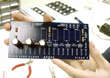

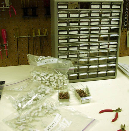

they are xicon 2% tolerance (tested and sorted within 0.1% tolerance). i did a little asking around, and they are used in some decent higher end designs. the head of design for edge electonics uses them exclusively in all their amps. they are 5-watt sand power resistors.
you might not approve peter, but ive heard good things about them from guys in the commercial industry, they really like them.
Peter Daniel said:What are those white power resistors you are using?

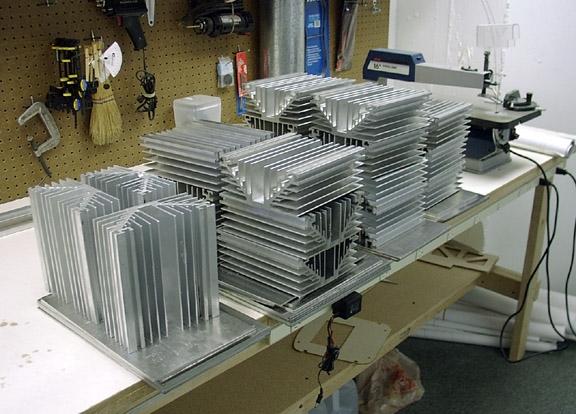

Looks like a good start. I would like to see how much heatsinking you are planning on using for all of the channels 😀
Brian
Brian
you and me both! im still trying to figure it out for the 3 2-channels...
BrianGT said:Looks like a good start. I would like to see how much heatsinking you are planning on using for all of the channels 😀
Brian

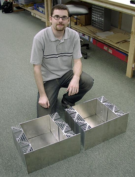

these are two of 5 cases.
there will be 2 mono channels (for me), and 3 stereo cases (for my friend and his theatre). looks as though each chassis will be around 60-70 pounds.
LOL, I can't get over all that aluminium. Makes me wish I had some stock in ALCOLA. Get a little chill in the winter time, just turn up the volume.
