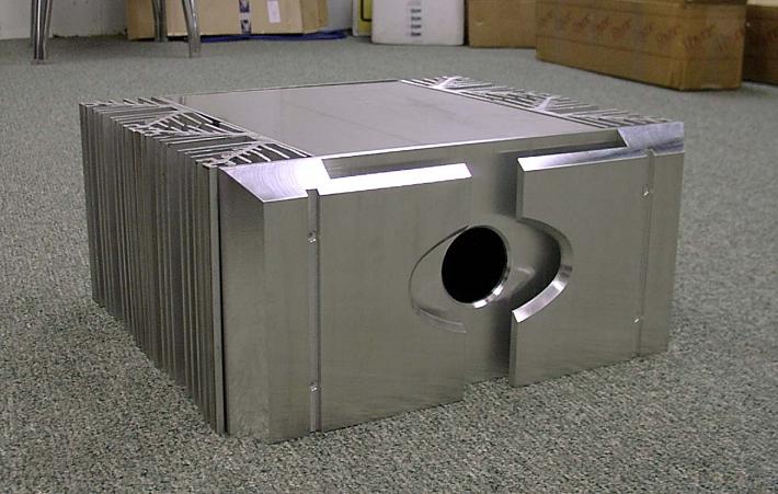

well, the faceplates are done from the machine shop, to many of you they will look a bit familiar. thank you nelson!
they are coming together slowly but surely.

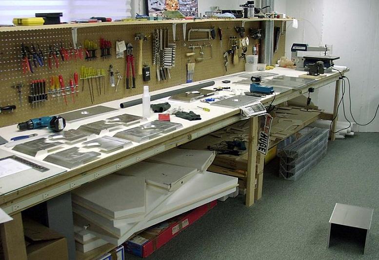

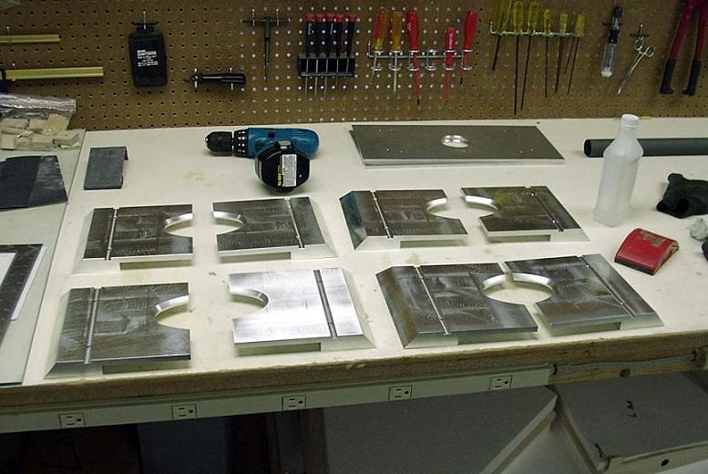

here is the metal waiting to be put together. you can see the pieces for the faceplates.

well, for the materials AND labor, it was $150 each. not TOO bad considering. you gotta see them in person to tell. they are absolutely PERFECT. they were done to perfect tolerences. this is the front fins and the back plate with the hole in it.
the bevels for the fins are actually varying. they get more acute the closer to the inside. plus, this aint cheap crappy aluminum, the whole project is T6 grade. the fins are 1 piece also. there are 2 8"x8"x1" slabs of T6 per faceplate. those werent cheap either. all in all, im happy with the cost of it. after they are completely finished, they will look as good, or better than any commercial amp out there.
there is a lot of work left. just finishing the faceplate to how we want it is a 4 stage process. i am VERY picky on how i want the finish to look. you cant tell by the picture, but the finish on the faceplates is brushed (220 grit), that is "polished" with ultrafine steel wool pads. this gives it that coarse industrial look, without the deep grooves or pits that brushing causes. it also takes out the dullness. so it has a kinda polished mirror look to it, but still that "unfinished" look of being just brushed. pretty unique.

its a 4"x36" belt sander. using the belt, not the disc. the piece is being held in place, so its flat, flush, and square... the curves arent being sanded at the same time. the bevels are going to be polished, not brushed. it will add depth to the piece.
the belt sander didnt give the finish we wanted exactly, so we opted for finishing it by hand. the 220 grit didnt give us what we needed either. it was the right "texture", but gave too many lines, and was impossible to keep uniform.
so then we decided to use a fine steel wool to basically "brush out" the imperfections of the 220 grit. this worked like a dream. it evened up the lines from the 220 grit, and even gave it a little polish. you cant see heavy brush marks at all, but its definately not a polished finish. worked really well. it takes awhile (1.5 hours per piece maybe), but its just how we want it. i couldnt imagine a shop doing any better....
so, the "face" is going to be this finish, as well as the back plate behind it. all the bevels are going to be brushed, including the channel on the front. the edges we have not decided. they are machined to an almost polish, and they look GOOD, but i might end up brushing them as well, and leaving the bevels as the only polish...
