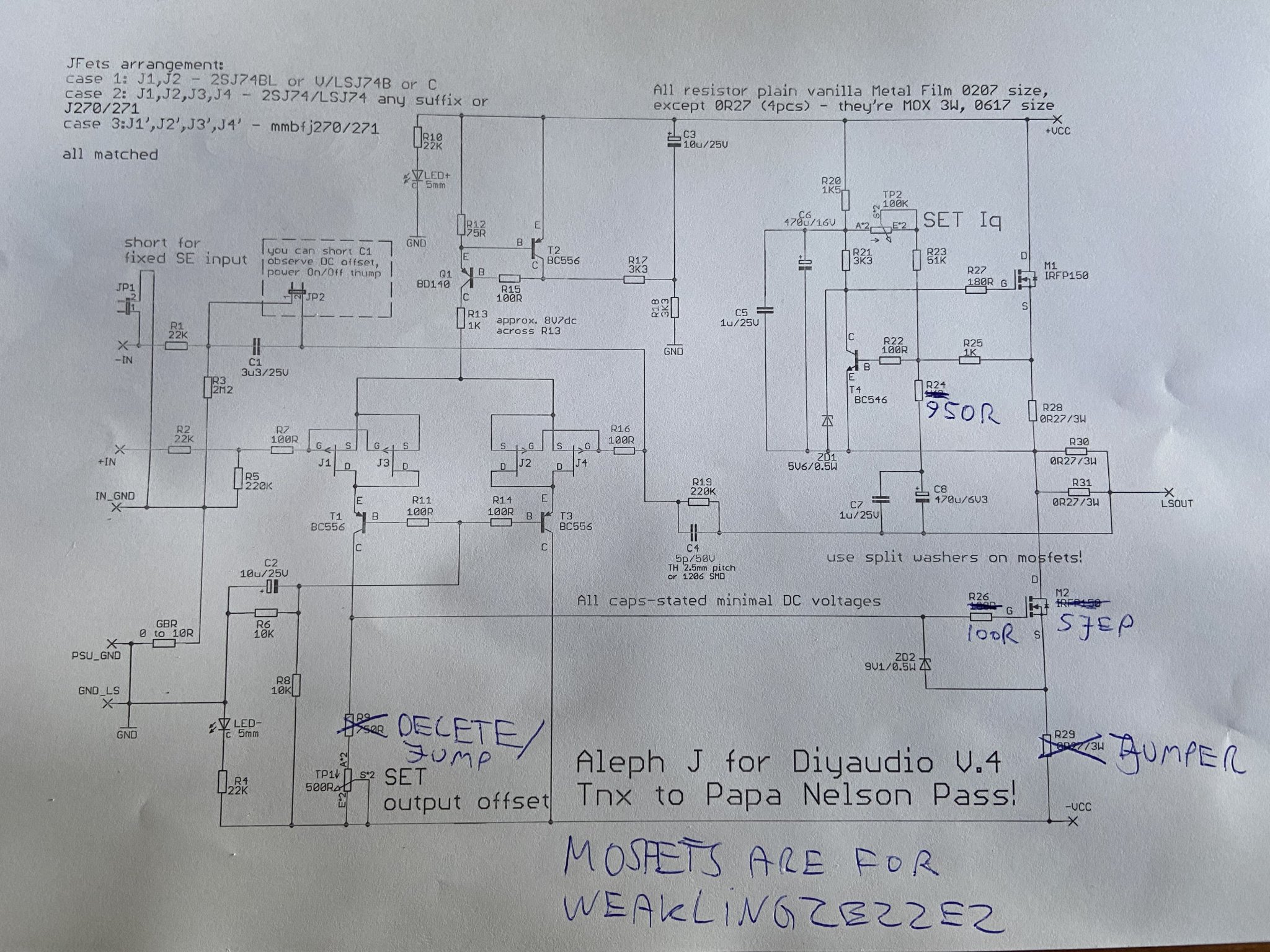

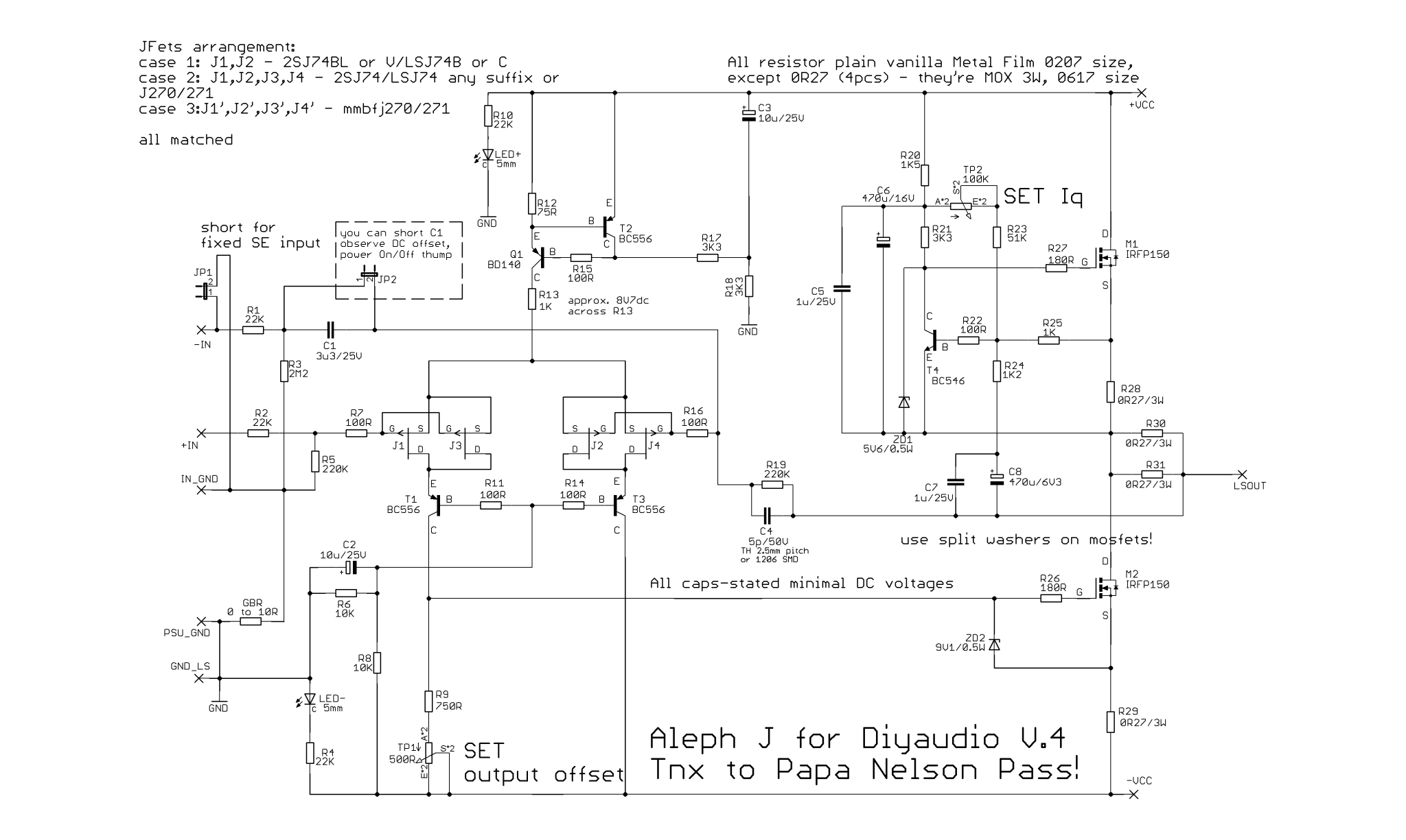

@mawi - if "schema" is more direct to "schematic" vs. schedule. Please find attached.

I never had SS devices for this. No files from this guy. Now... if someone were to send me some of those precious devices to make 100% sure they operated with this circuit / with these boards, I promise, promise, promise to post a complete schematic.

Hello ,
if this is the right place to ask for possible substitutes. I would like to replace 1 mosfet with 1 of my Semisouth SJEP10R063.
Any changes necessary?
wr
Helmut
andynor is certainly intending to write them ( values) later, but more eager to make fun first
anyhow - changes for implementing Semisouth down:
make M2 Semisouth SJEP
make R29 0R (short made of fat wire - same as 3W resistor pin thickness; elevate it 1mm above pcb, to avoid shorts)
make R9 0R (short made of thin wire, or nice resistor lookin short - they make them in 0207 size, one black strip in middle)
