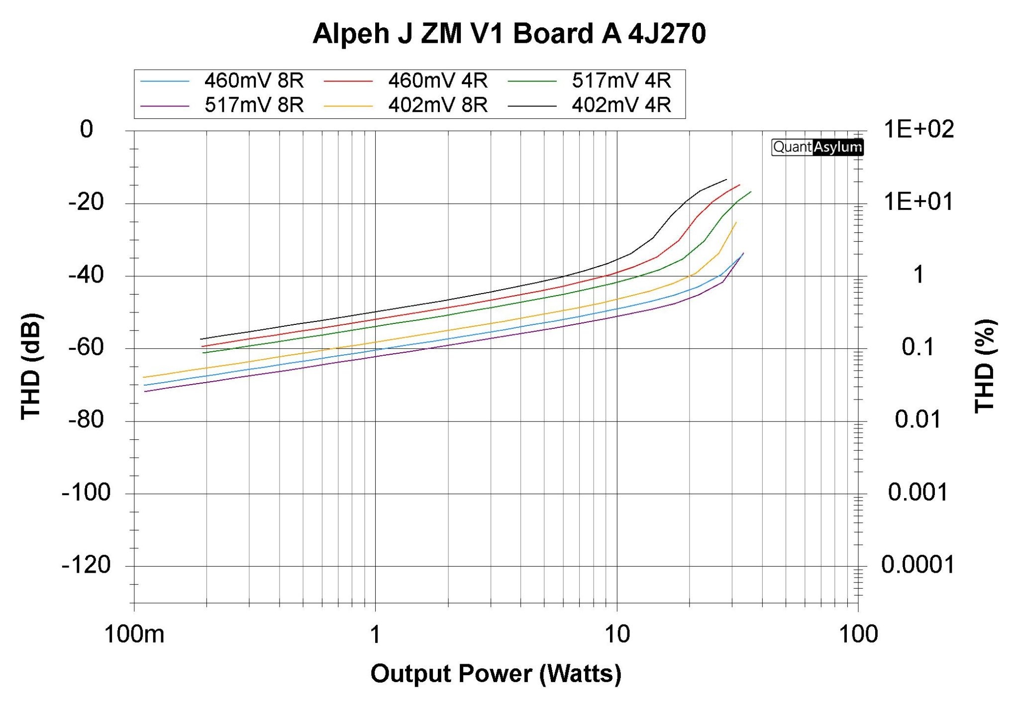

Thanks. It's the power that interests me most as I need about 20w and I suspected that a single output device would only be capable of about 10w at reasonable temperature.
I can connect my midrange drivers in series for 16r load and use my +-33v psu. So 25w needs about 1.3amps and 20v rms (56v p-p)

With 33V rails, I'll have to let the Mighty One comment re: if that's a concern for the JFETs or any other components - Typical builds are ~24V rails.Thanks. It's the power that interests me most as I need about 20w and I suspected that a single output device would only be capable of about 10w at reasonable temperature.
If you're planning on running 1A3 Iq; I've never tried it that 'low'. The lowest I ran it was ~3A during prototyping, and we set the starting point for the build guide at 3A4. THD is inversely proportional to bias current with this amplifier. THD is also inversely proportional to load impedance. THD is directly proportional to output power. (That's true within the ranges I have tried). So, I'd say it could be worth a try, but I don't have any measurements to offer with that type of configuration. You may have to adjust the trimmers and/or a resistor or two to get the Iq into that range. If you do try it, I'd love to hear how it works out.
At 33V rails and 1A3 bias, the dissipation per device should not be a concern.

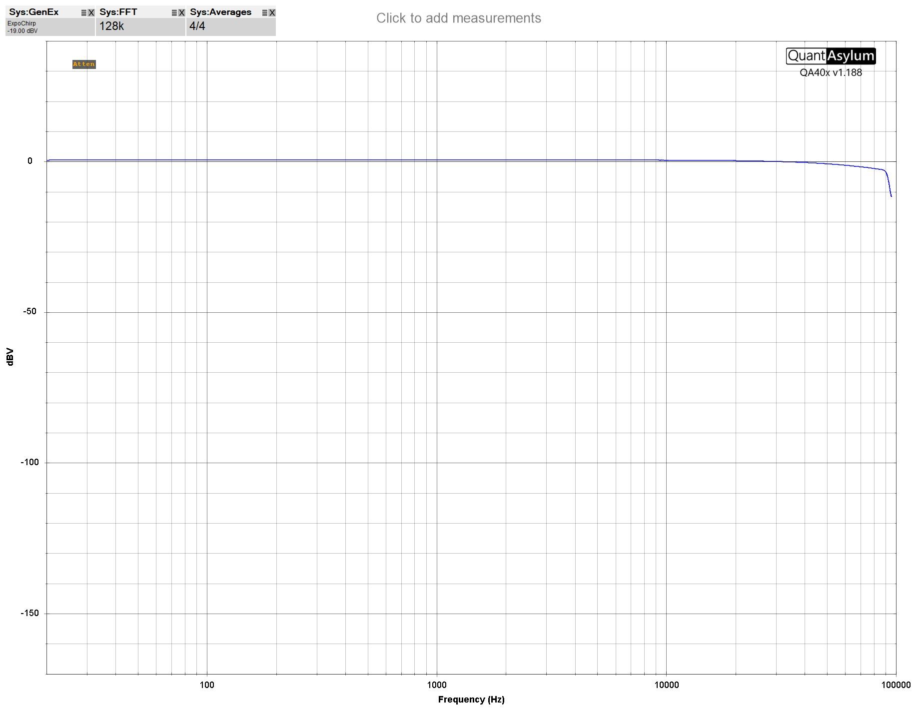

Attached is a representative set of measurements at various bias currents and a FR plot. The figures weren't tidied up for publication. They were more for my testing files; apologies. The mV figures are measured across R29. 402mV => 3A 460mV => 3A4 517mV => 3A8
I don't have any data for output impedance, but ZM may have a simulation and/or a ballpark to offer.
It should be mentioned again, that I'm still working on my measurement techniques, and I've made every attempt to keep things as proper as possible. The results should be representative of what to expect from a 'kit build' using the components offered. Happy to share any further information. The DUT was an amplifier made with exactly the components in the kit, but using prototype PCBs. The PCBs should not affect any measurements, and they used the exact same configuration, but it's only proper to mention.
Hope that helps.
Edited to add - For this purpose, 1/2 the Iq numbers above are probably more useful for your comparison. So, 3A => 1A5 etc.
I slipped up. My drivers are 16r in parallel so in series the amp would need to drive into 32r.
My psu can give from +-33 to +-39v and according to my calcs and ignoring volatge drops, about 20w is the most I can expect. On the otherhand there is no passive crossover as the amp is just driving the midrange drivers.
However I dont kow if the amp will work with 39v rails.

meaning - you wrote Iq for 2 channels, which is somewhat uncommon
this amp with 33Vdc rails and for 16R load, doable
Rout - it's an Aleph, who cares what's Rout?!
if you care for Rout, build different amp
