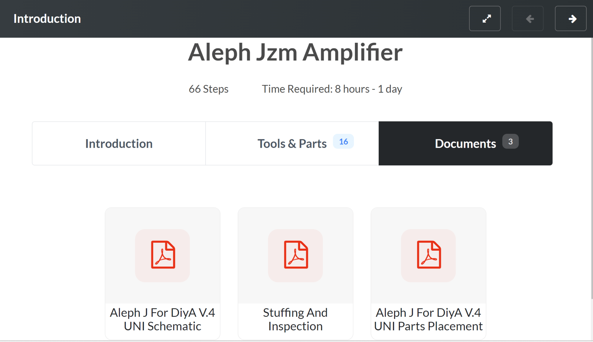

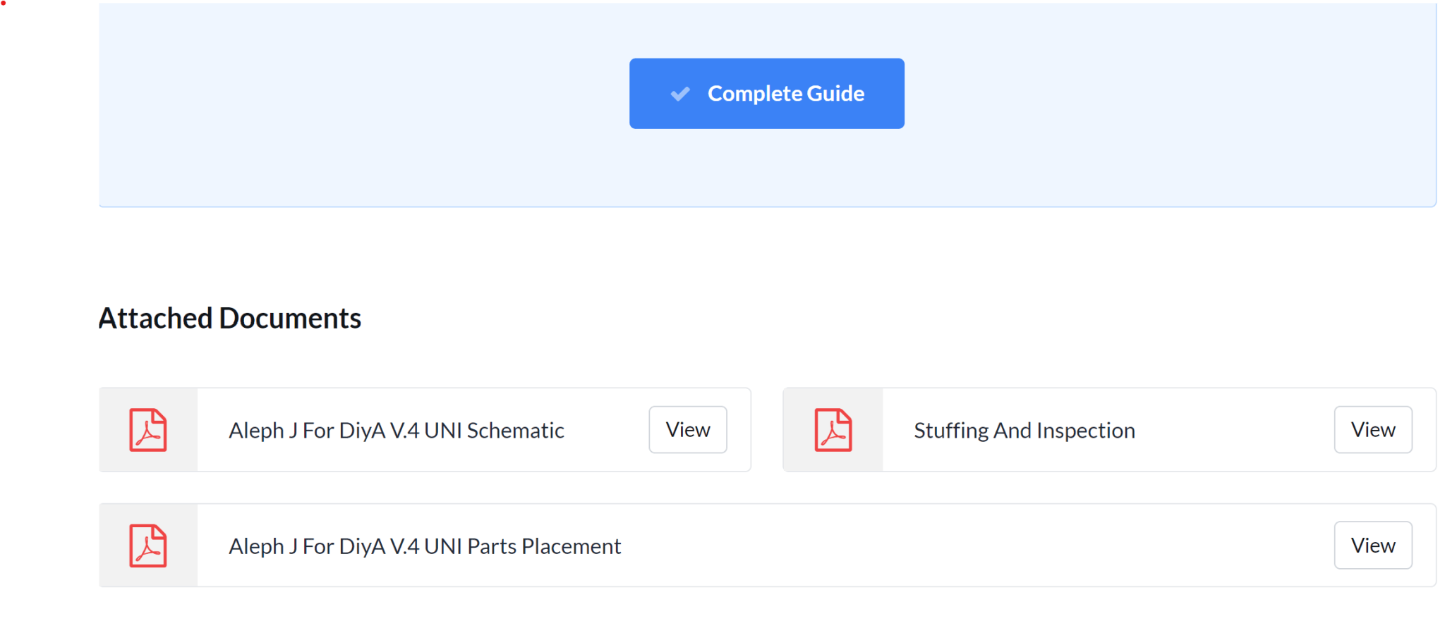

For all - The software used to create the guides has a few idiosyncrasies. See step 8.
For those in "Full Screen" Mode, there will be separate tabs at the top of the 1st page in the guide. For those that are viewing in the "long form", they will be at the end of the guide. Pics below.
Full screen - 1st slide.
Long Form - At the end

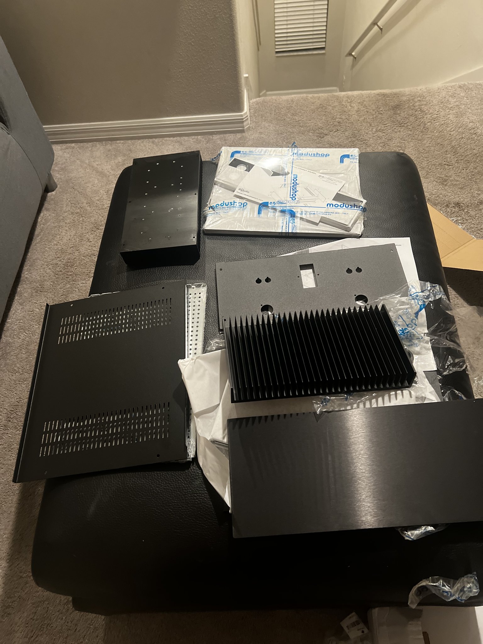

Deep end of the pool here I come. Just ordered the kit plus the back panel kit and keratherm from the store and the fancy chassis from Italy. Now I'll have to study the project and decide on a power supply.
^ Congratulations! Come on in, the water's fine.

I have a pair of TL speaker enclosures to dope out and build before I start on the amp. I wanted the parts on hand though lest they sell out.

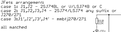

Hi guys,just want to purchase one kit for stereo and my question is,if I go with Toshiba 2sj74 jfets,do I need to buy a matched octet of this P chanell jfets or is a quad enough for stereo set up,so that I use than only J1 and J2 populated on the board?Or Im wrong??
^ If you get the JFETs from the store (BL Toshiba), you only need a matched pair for each channel. Put them in J1 and J2 positions. Case 1
You CAN use a matched quad for each channel if you have them (any suffix). Case 2
See notes in upper left of schematic from the build guide pasted below.
Ah,sorry have not see that writing but I have thinking from original papa plans that a pair is enough for each chanell.Thanks for help and thanks to ZM for perfect job and help to diy comunity😉
