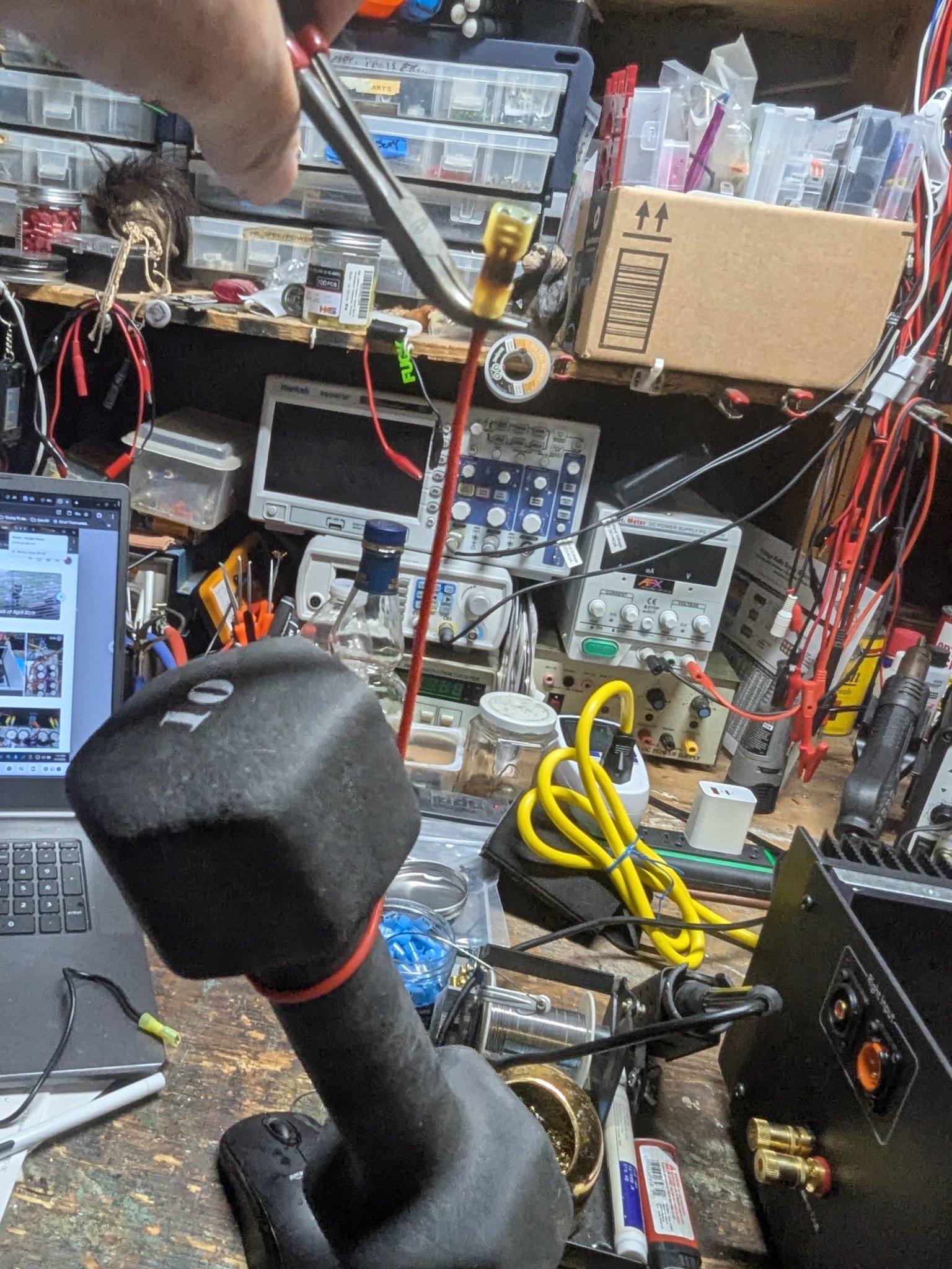

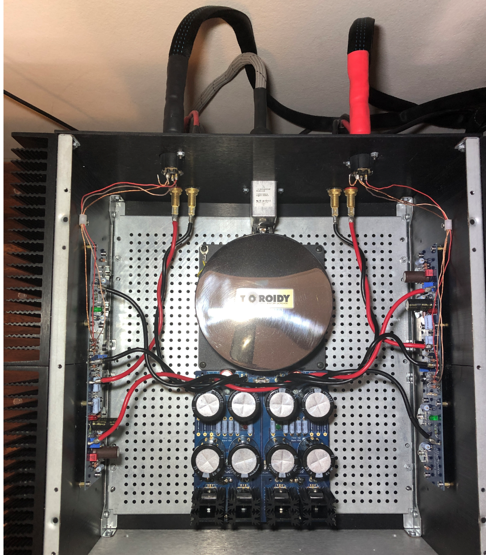

My Crimp Hand is strong! 💪. With that said I get the crimp thing and my misuse of correct size for AWG. I am taking it apart and going to back to build guide and above advise...

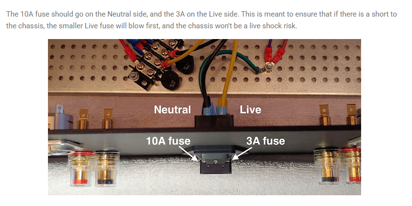

The Aleph J build guide power supply assembly and test post has a section on crimp connections with links to connectors and insulation sleeves from TE Connectivity that can be used when soldering the connectors. I'm using the same female connectors and recently picked up some of these sleeves but haven't tried them yet:

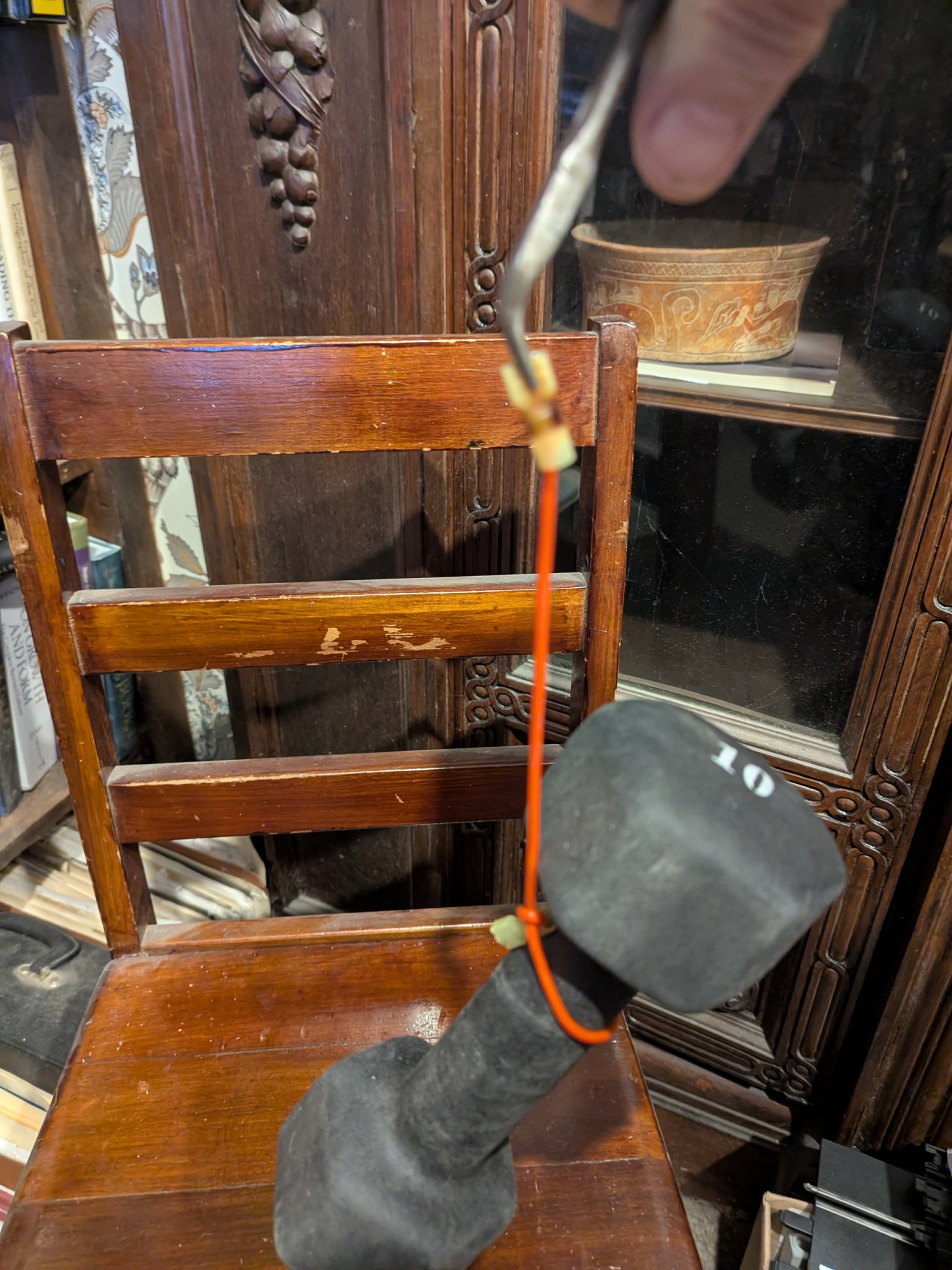

For those who doubt the power of my Crimp Hand!Now pinch the insulated end (right at the tip of the quick connect) and pick up the weight!
I'm listening, integrating and rebuilding...Hi. You need to read AND understand what the guys are telling you. You’re getting great advice and more than subtle hints to what’s wrong with the amp. As it is, the amps an outright fire hazard in my book. Connections getting brown/black from heat is dangerous, and you got it backwards. It is definitely not working well, and it is not drawing too much current. That bad crimp is creating a voltage drop and a lot of heat is being generated because of it.
Just because you didn’t make a mistake today, doesn’t mean you’re safe tomorrow.
It seems like you’re using the different color spades to color code the different types of wires. As is pointed out earlier, the colors on crimping connectors usually refers to the wire gauge they should be used with and using the wrong size is a bad idea.
I’m not out to get you or trying to be mean, quite the opposite in fact. I wish you all the best and want you to succeed and not get hurt. I’m being direct to get the point across.

Thanks, I am going with JZM's advise and going to solder most of the amp. I think I might take crimping advise here for the 120VAC connector as it is a bit cramped, but might even solder that up too... Thanks, T^ I love that movie....

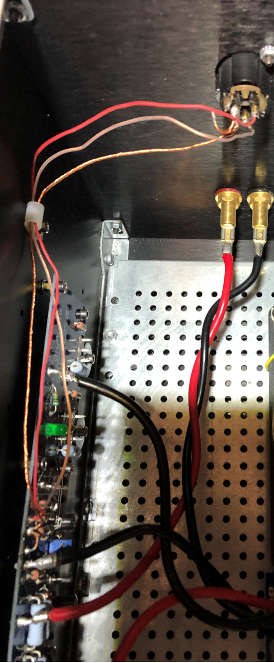

Ha, I get it, I was just busting balls. Yea it's disassembled and spades are de-soldered. Going to rewire today. Will post updates and pics... Thanks, TBravo…..the comment was more centered around the absurdity of touting the connection strength……and then grabbing by the actual wire. Let’s get this thing fixed! Any progress?

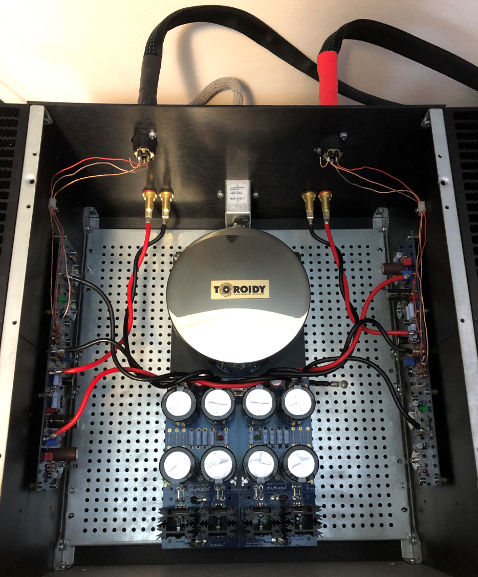

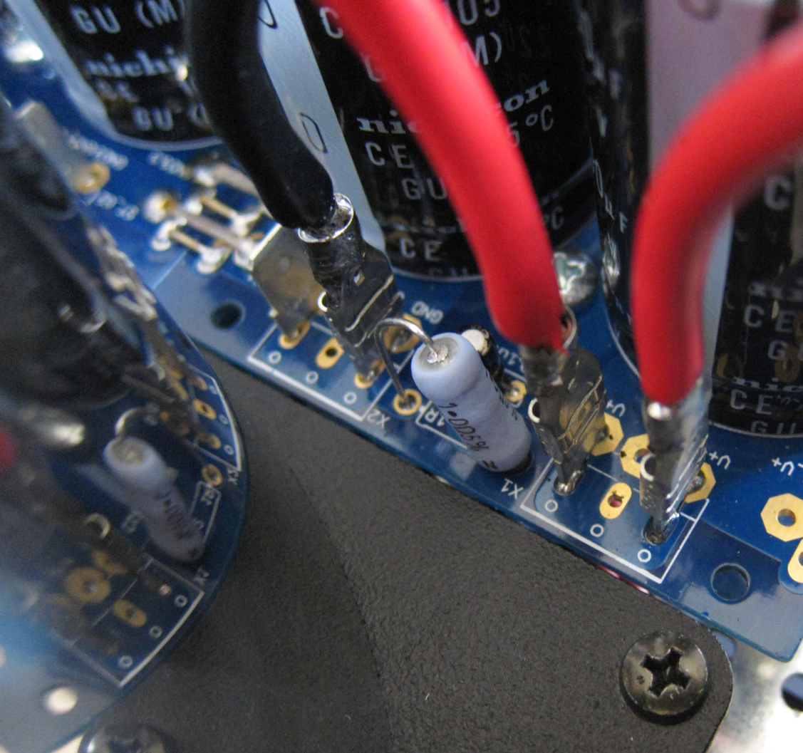

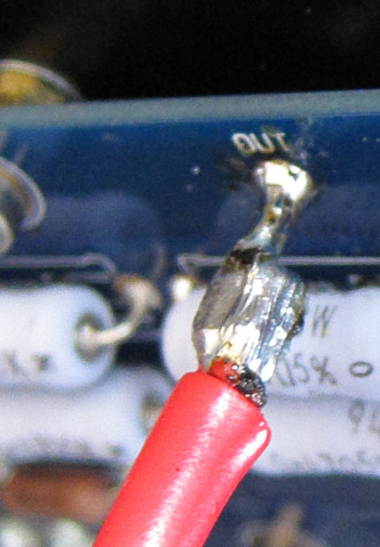

Based on your photo showing the crimp is "decent", why did the spade get so hot that it caused discoloration on the insulator? I'm just curious if we can definitely say it was an issue specifically with that connection/crimp, or if there may be something else going on that may not yet be resolved.

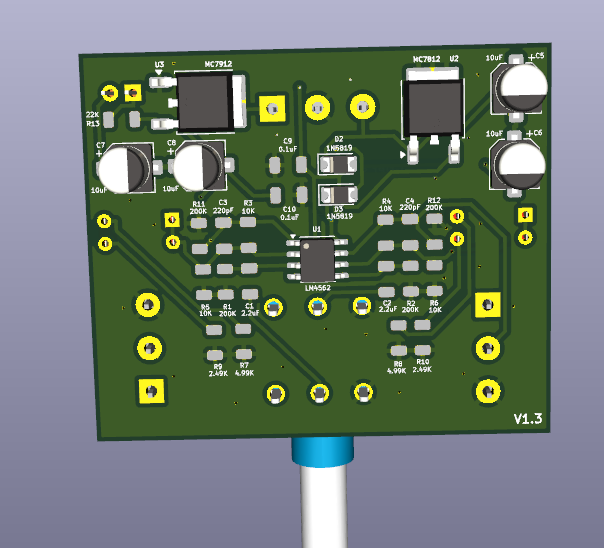

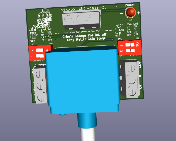

Yea, I worked with him and took his Gain Stage design and built a Pot Board that incorporated it in the pre I use with the JZM (see pics). Just using the Pass B1 buffer didn't give enough volume by itself.This is a nice combination, IMO. I'm using a version of Steve's pre at this very moment. Enjoy!
emuffler gave a description of what might be happening...^^^@tgier
Considering the amp works great for a while I think when hot some mechanical problem occurs with crimps that causes hum. Hoping soldering connection as per Zen Mod's initial post takes care of problem, his post gives me a heavy "been there done that vib" considering its brevity... T
