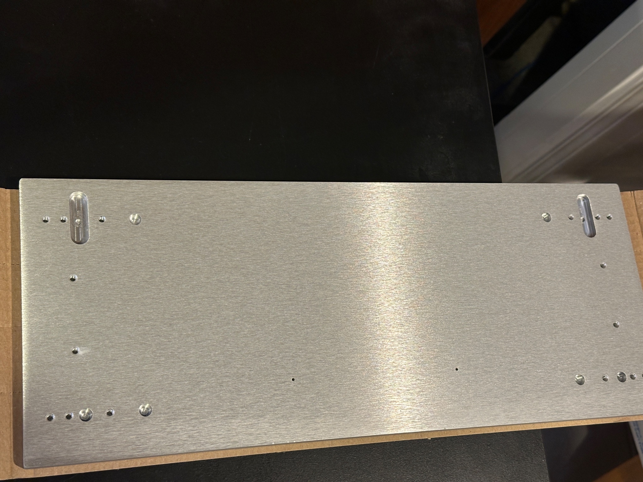

Or do I need to simply drill the backside large enough to fit "normal" LED, like the Zenmod custom Iron Pre chassis LED openings?
Serious part - That's the intention. If you're talking about the PASSdiy chassis, then the holes go all the way through the front panel b/c they're specifically placed in the "sine wave". Just providing a pilot hole of a few cm deep could still allow error in placement by the user if they tilted the bit drilling through or picked too large a bit. Plus, two LEDs looks cool.
Also, I scientifically calculated the exact diameter to give just the brightness I wanted. :rofl:
Anyway... yep, for me the easiest thing to do is pick a drill bit just the tiniest smidge above the diameter of the LED body, but not the neck ridge, and go down about 3mm or 4mm, but not all the way through the front. It should friction fit, but if not... a little tape... some hot glue... or whatever works will hold them perfectly in place.

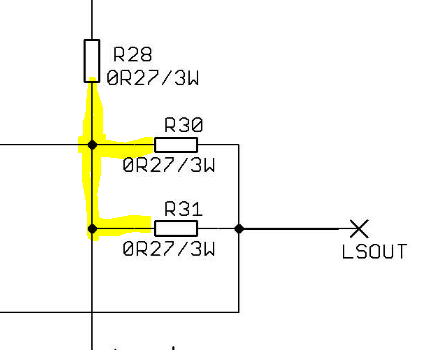

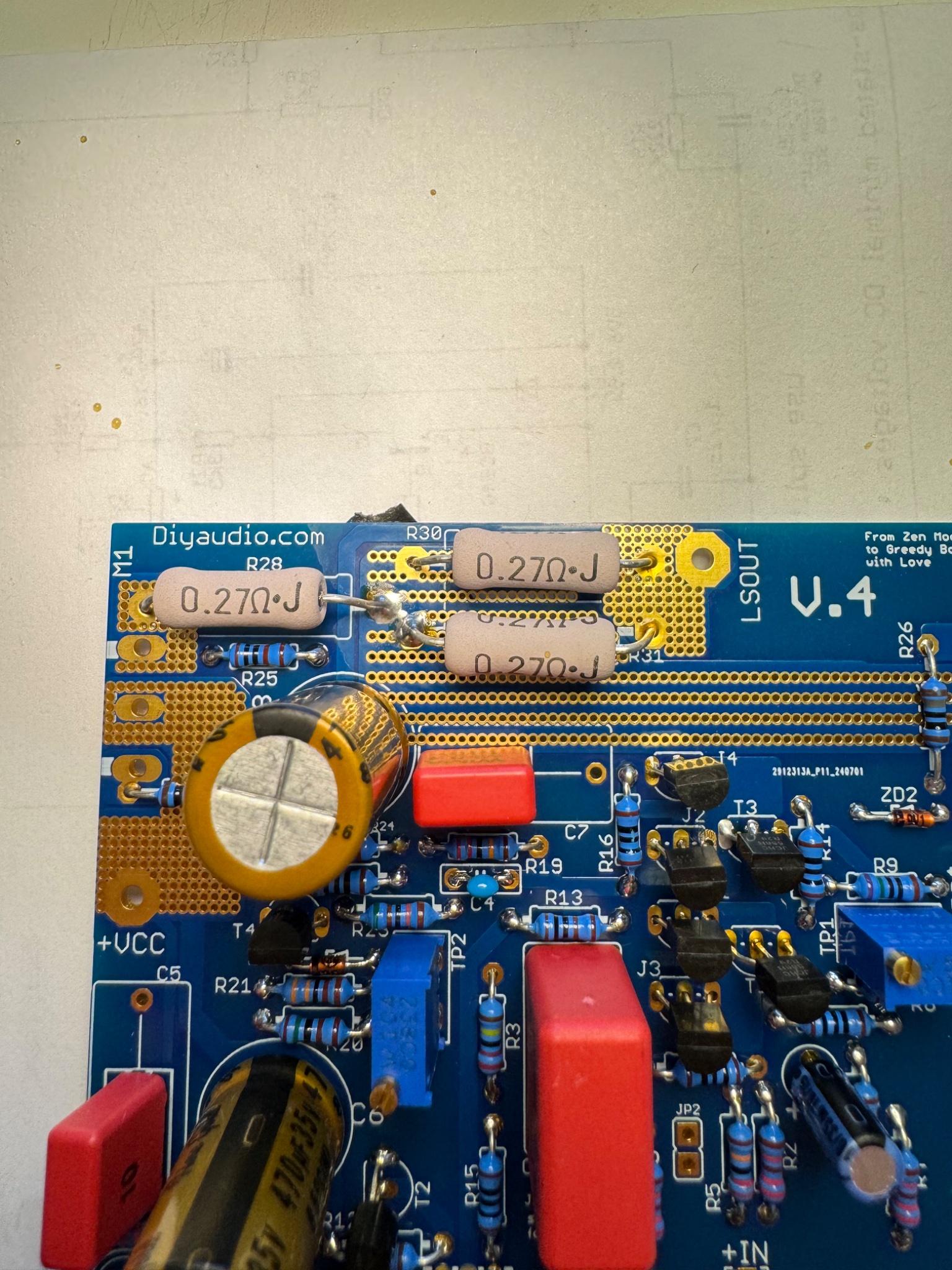

Hello, just finishing my boards for AJzm and have a quality control question.
All good in general but my first solder pass at the large resistors was a bit messy (switching to larger tip on the iron did the trick!).
The clean up ended up with a possible solder bridge on top of the board betw R28 and R31.
Is this ok, or should i clean it up (see pic)?
as a novice, reading the circuit doesnt clarify for me.
Thanks in advance!

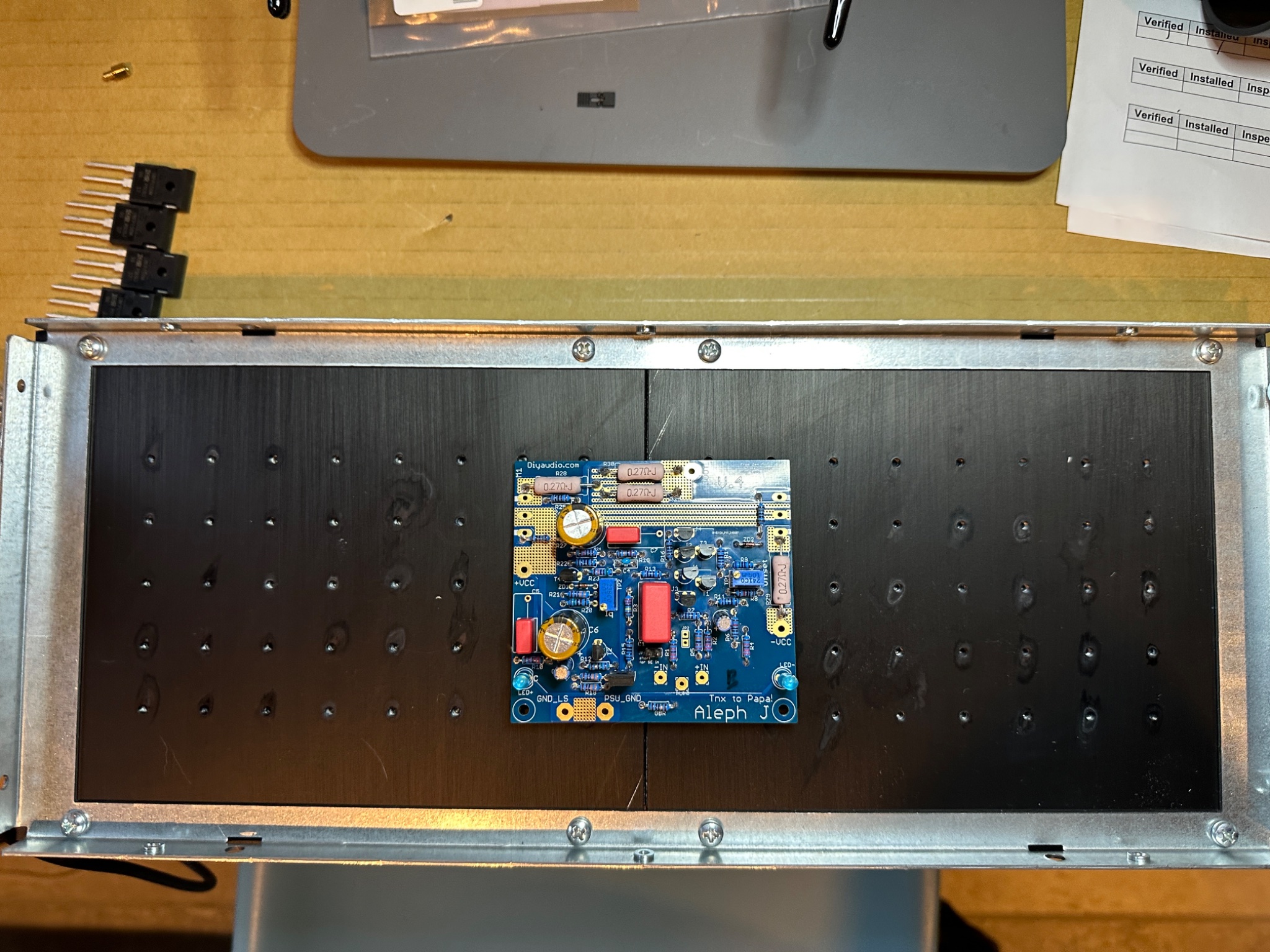

1. Board Placement - in the build guide - it shows the placement of the boards toward the bottom of the heatsink (which is actually the top in my photo). Why not move it up one row of threads so that the MOSFET's are closer to the center, seems like it may make accessing the boards for measurement (or tuning of potentiometers) easier. Just curious on this one. Photo 1 kind of demonstrates approximately where I am proposing to mount the boards.

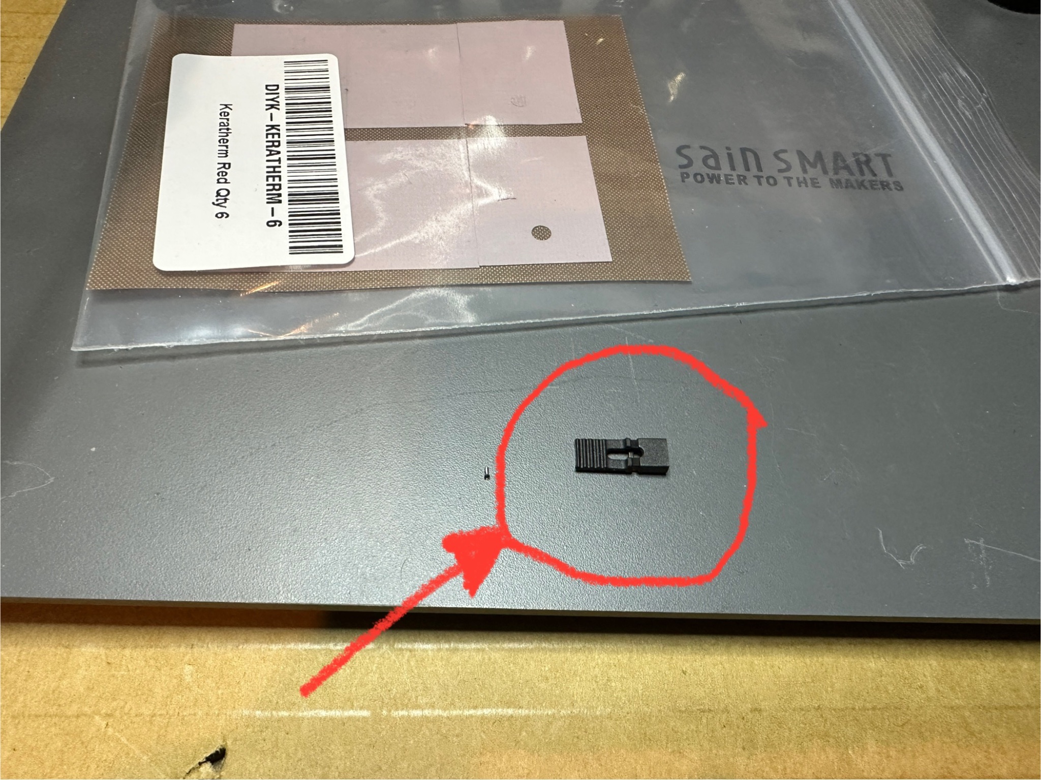

2. Where can I get a pair of the wire management towers, I will need to do something to get my front panel LED's to stay put because my front panel only has two small holes for the "light" without larger holes on the back side of the front panel where I can set the LED's. I think my LED's are 5mm diameter similar size as the ones in the kit. Photo 2 shows the back panel with the tiny holes for the LED's.

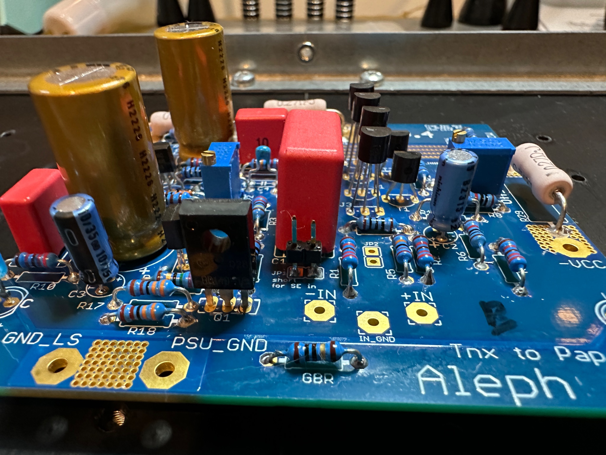

3. I want to build my amp with XLR and SE inputs. The build guide, at Step 55 in the information bullet says to "remove the header cap from JP1" if using both SE and XLR inputs. Is the header cap what I have shown installed on JP1 in Photo 3, should this be removed? Or is the header cap the thing in Photo 4?
Generally, you mount the devices ~1/3 up the sinks. In this case, you've got PLENTY of heatsink for the dissipation. Where you have them is perfectly fine.
You're covered there... from #596. 🙂
Leave off the cap in #4.
