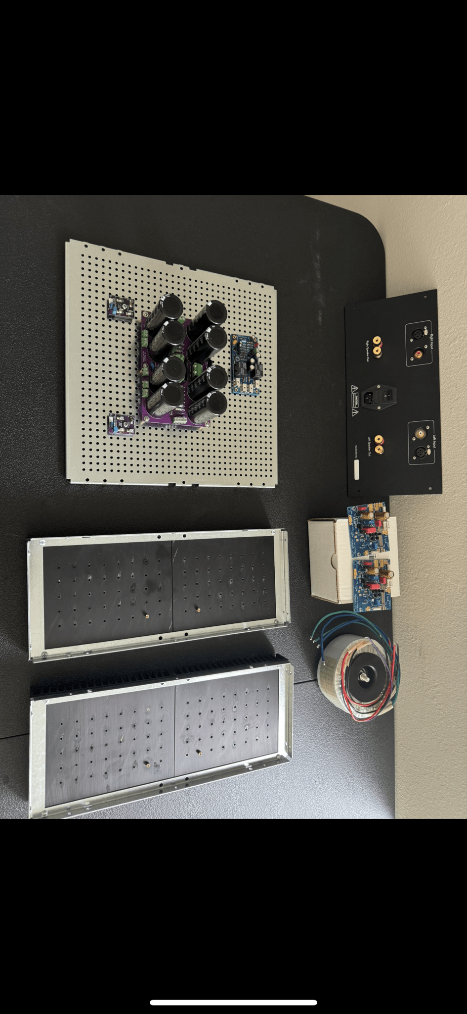

Finally, no more procrastination!
PSU done Amp boards almost done.
PSU mounted with rectifiers.
Waiting on 3d printed bits to get finished. I also am awaiting a new variac.
Also rear panel has all the bits mounted.
Much to do so little time!

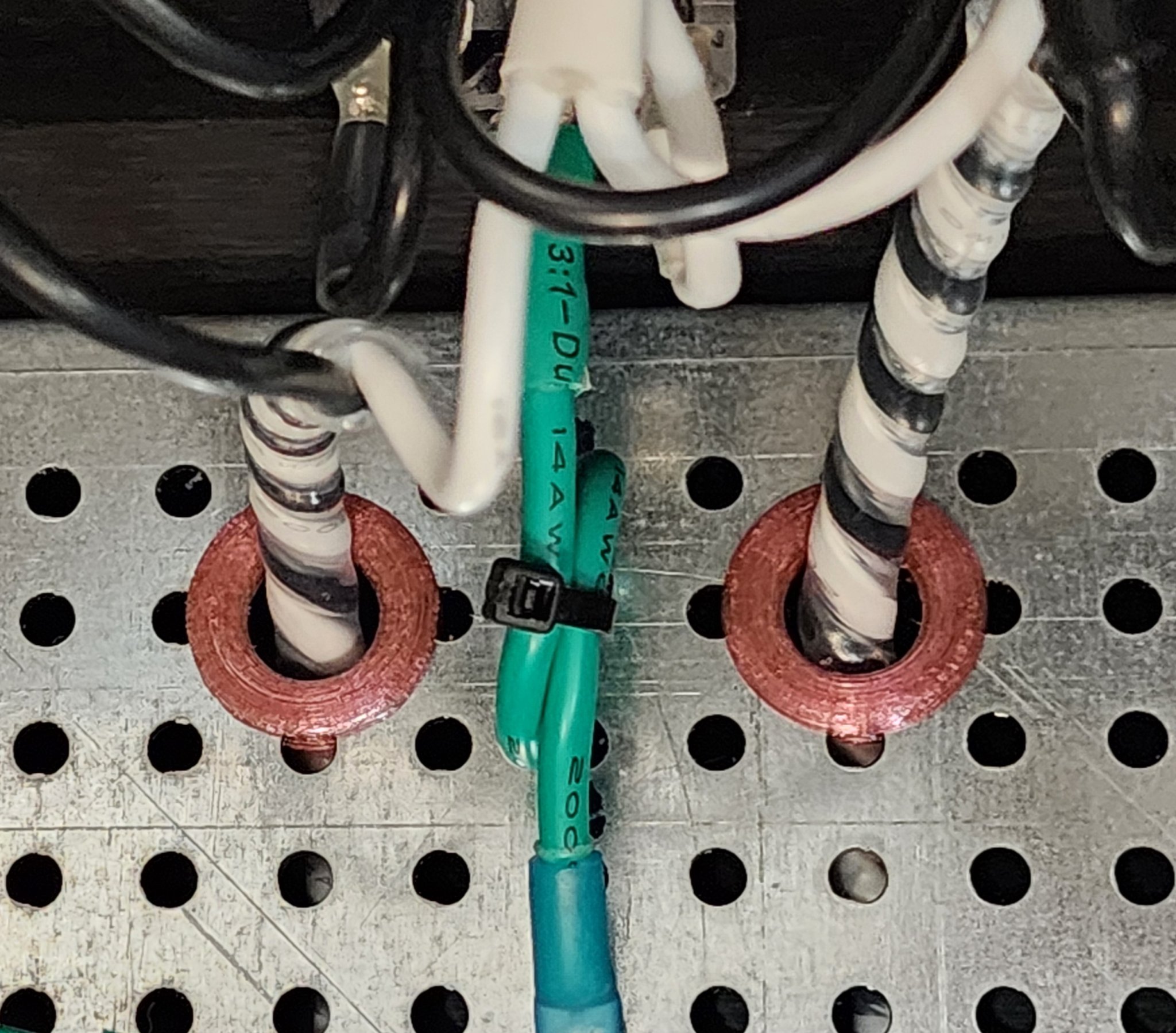

lip up, 7-10mm spacers (longer screws, 2-3pcs of M5 nuts as spacers), mains wires bellow
@uptownsquash - I'm not disagreeing with his-mightiness... just adding a POV.
With that particular PSU... your mains wiring can be quite short. It does not run all the way from the back of the chassis up to the front. It simply runs a few inches from the PEM to the PSU board.
So... flipping the panel to leave sharp edges upward and leave more space to put mains wires between the bottom panel and perforated plate in a Modushop chassis is a bit less critical with this PSU layout. As an example with a typical layout seen with the Universal PSU boards, I almost always flip the baseplate.
The AJ I built for the guide was absolutely hum free with sensitive speakers, and I didn't flip the plate.
Note - I can't quite tell what the blue module is, but the two relays? make me think it's a speaker protection board. You probably wouldn't want your mains wires running right under it (unless separated by the perforated plate).
YMMV.
YMMV.
