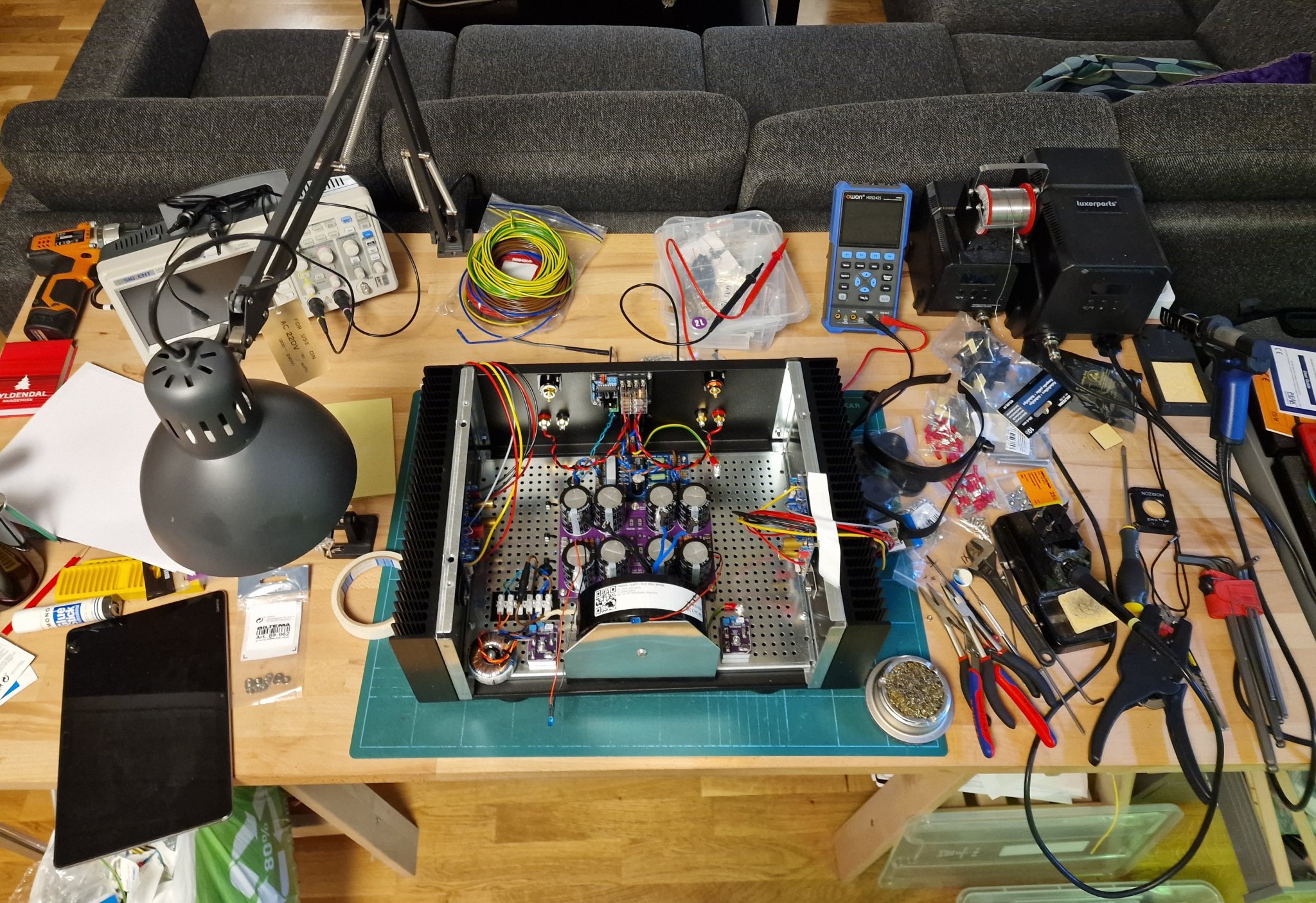

Finished my Aleph Jzm today! I followed the excellent and very detailed build guide. A completely trouble-free build. I've only listened to a couple of records so far, but first impression is very good. Thanks to everyone who has made this project possible!
A photo from yesterday of the then unfinished Aleph Jzm:
