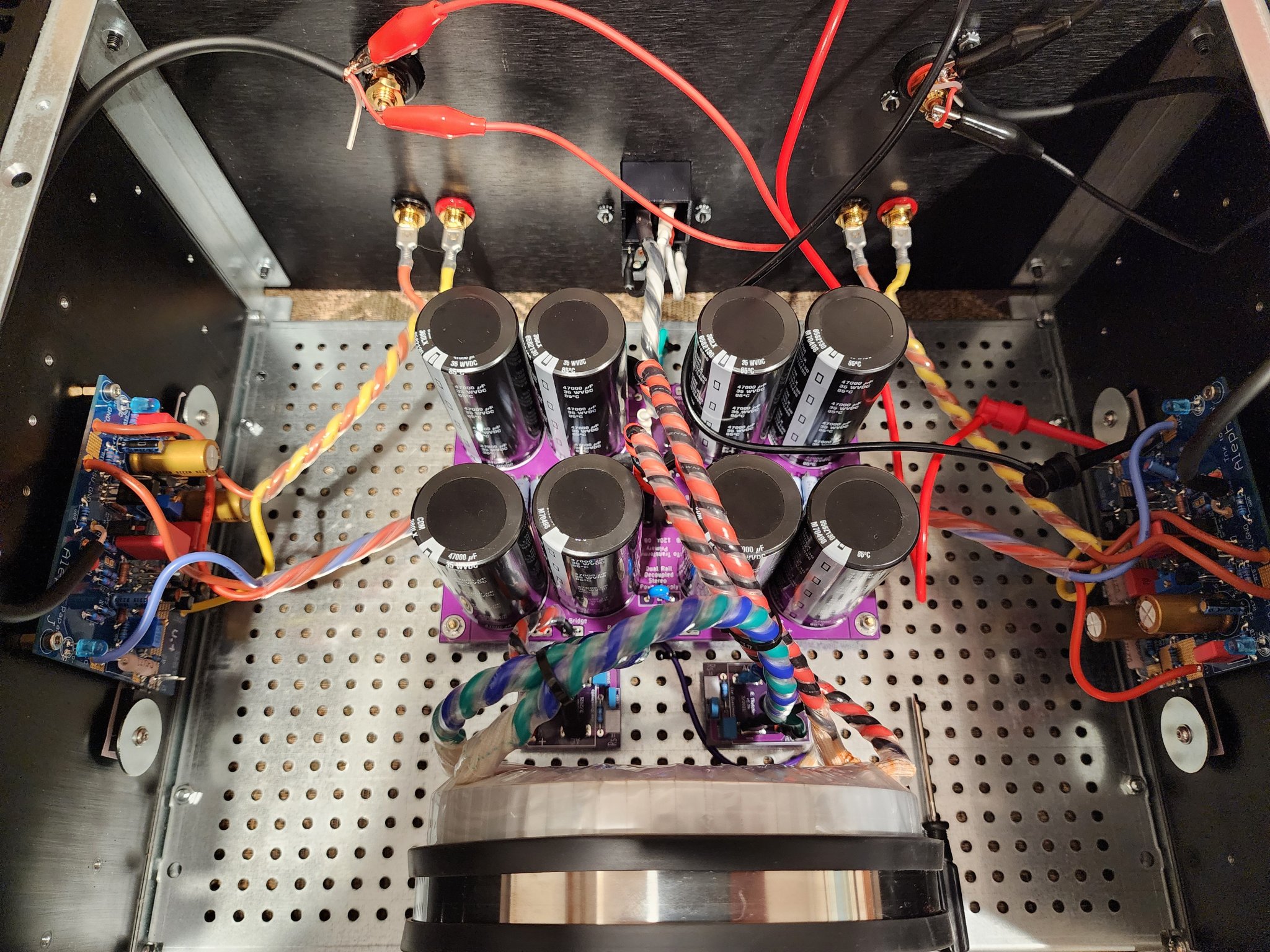

Well, I can say building the Aleph Jzm a second time does go a little quicker. I still followed every step in the build guide. What a glorious build guide it is! (Thank you @ItsAllInMyHead ) I even see I'm mentioned in there....transformer seat design and wire posts are free for anyone to print BTW (search "3D" posted by "birdbox"), and if you don't have access to a 3D printer, feel free to PM me for one on the cheap.

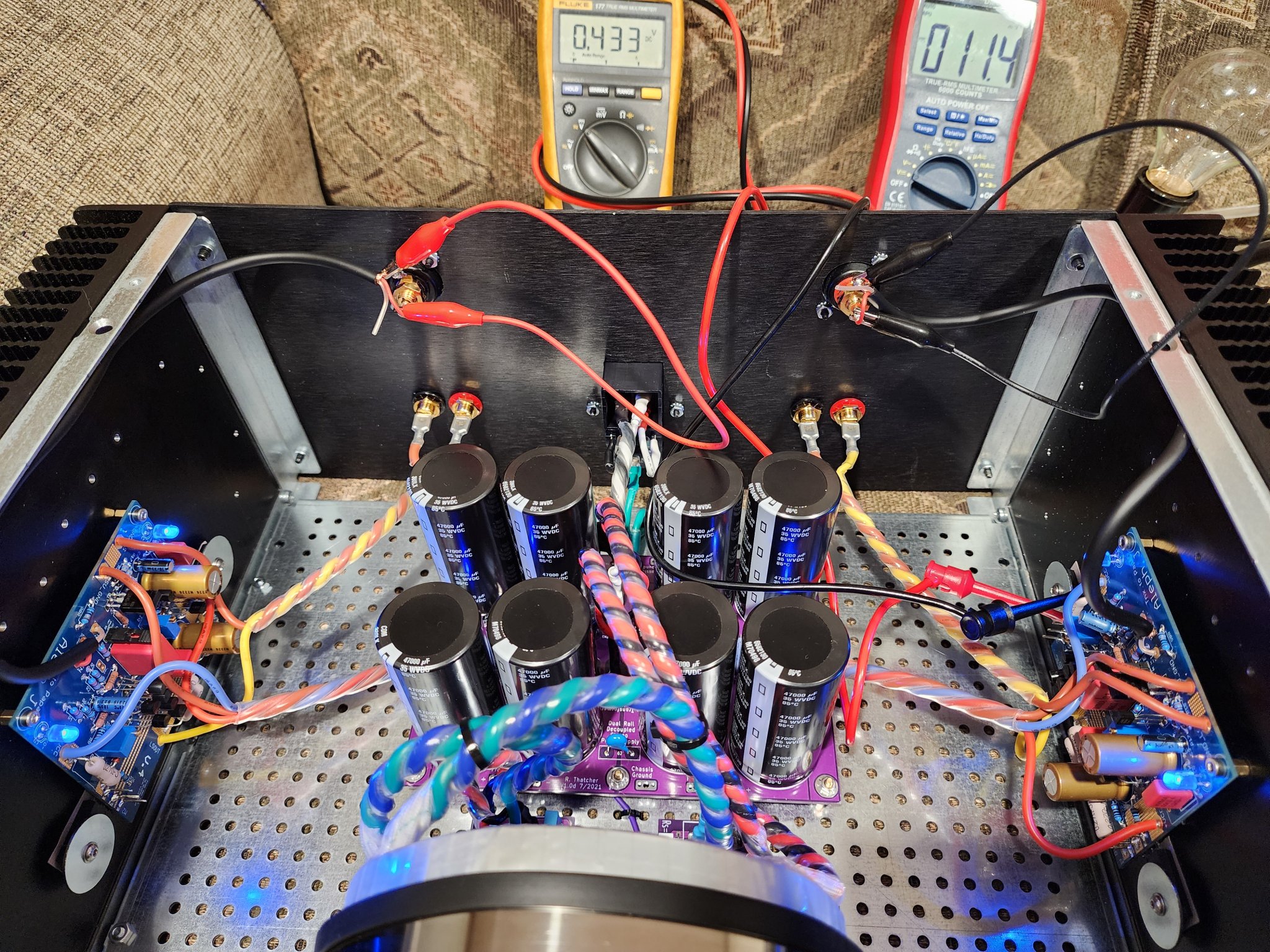

First confirmed good PSU voltages with no amp boards (using dim bulb and variac), then a left channel check with variac, followed by right channel check (after letting capacitors discharge for an hour of course, and confirming no voltage before connecting up).
Biasing will happen in the morning for me, and hopefully glorious music after that. So far around 10-12 hours of diligent work to go from blank amp boards to power up checks (Note: @rhthatcher 's PSU was already fully populated before I started on the amp boards). Wiring actually took the longest time as I was very focused on "do it right the first time".
Now, a little amp porn....
Image above is of the right channel check at 120VAC from variac (no DBT at this point). [Left DMM is voltage across R29 on right amp board, right DMM is offset on the right speaker posts]

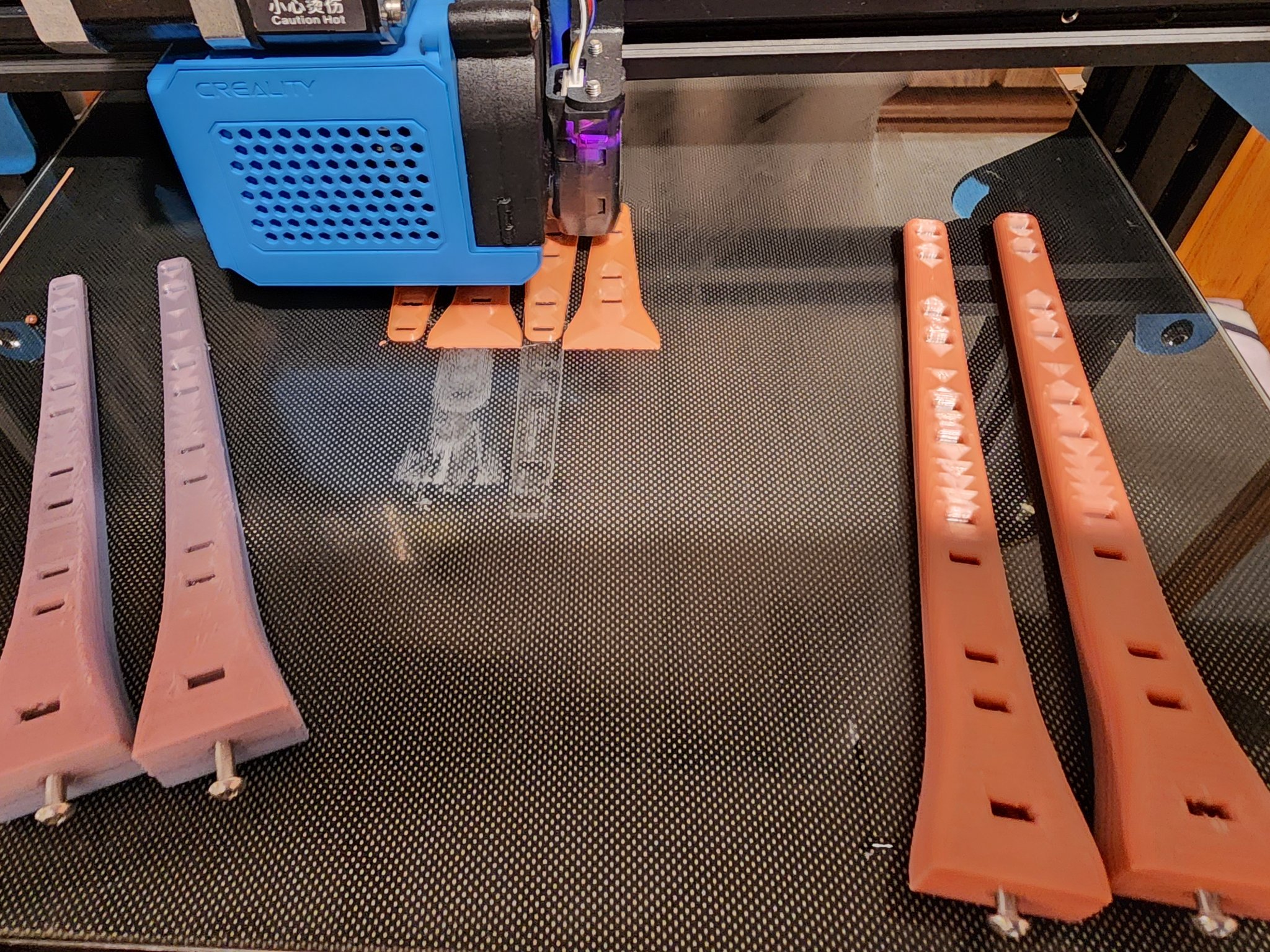

Printing some wire posts just for fun. Maybe just a little "happy factor" that I can relieve any stress on the wires & connections by using the posts properly.

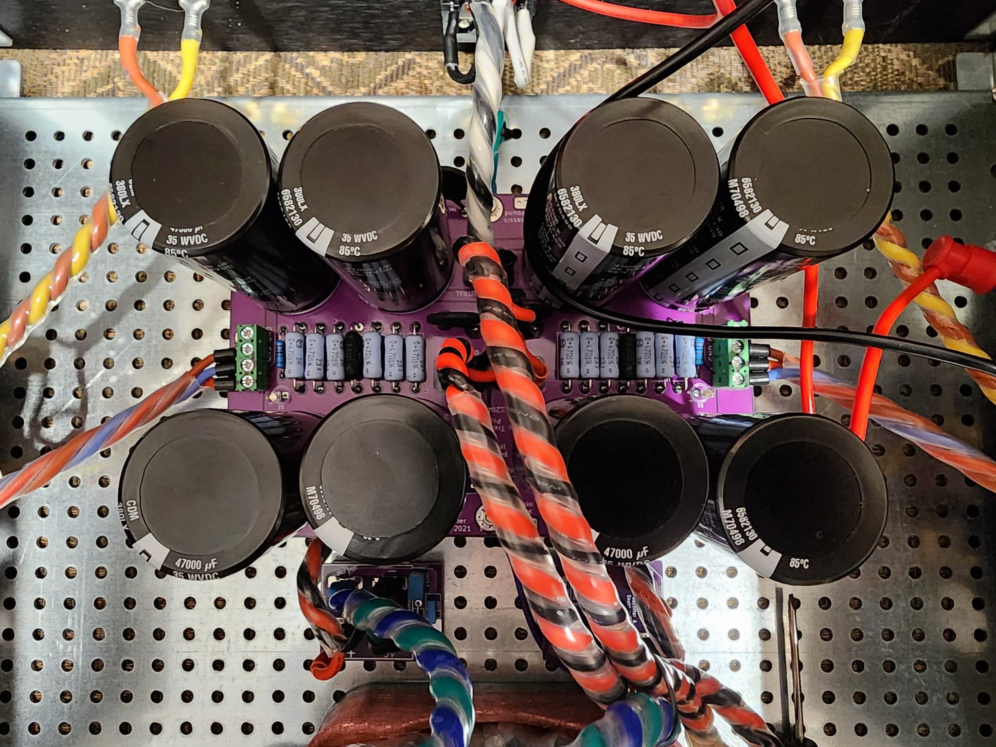

All the wiring is BNTECHGO 16Ga w/ silicone insulation. I twisted the wire inside 4:1 marine heat shrink to get the tight twist and lock it in place. I know Zen Mod will suggest direct solder of all wiring to boards and I agree with that approach. I just already had the PSU all soldered up with spades and terminals, so didn't want to desolder to do that with my time crunch to have this complete by Saturday night (I fly back to WA Sunday).
Tightly twisted wires, nicely done dressing those up! 47k caps, too. That’s going to sound beautiful!

Well the technique to twist wires using a drill was inspired by you @rhthatcher . I simply added using heavy duty marine grade 4:1 heat shrink to hold the twist in place.....I cool the hot heat shrink under cold water to avoid it un-twisting before releasing the torque from the drill.
I'm not sure the super tight twist is really needed from an EMI reduction standpoint...but it looks nice and makes for tidy wire management.
EDIT: By the way @rhthatcher , you're stereo dual rail boards are fantastic! I highly recommend to anyone looking for a practical and easy to implement PSU board.

I love that wire, but the only disadvantage (that I've found) with the high strand count and silicon insulation is that it is pretty "springy". Your solution is fantastic for maintaining the twist. I tried the zip tie every few cm etc, but yours is a more elegant solution, IMO. Wire management / dressing is one of my "biggest opportunities for improvement". That's MN nice for "I suck at it".
