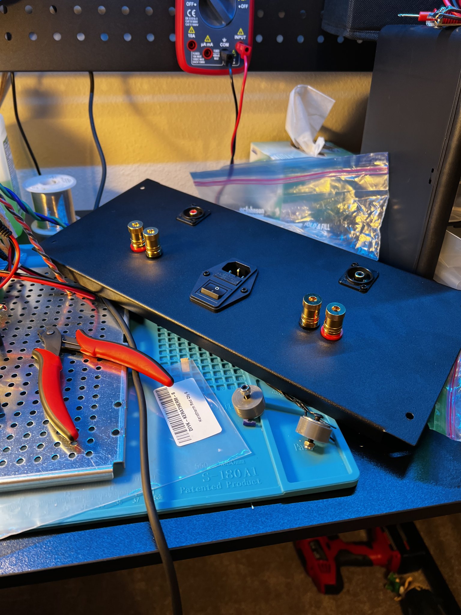

My biggest complaint about those cases is... the binding posts sitting very close to each other. Very bad!!
The hetasinks are also minuscule...

Jacruzer787,
Your IEC/switch module appears to be is upside down.
I am not a big fan of metal speaker binding posts, the could accidentally be shorted when the amp is on.
from same reason I'm avoiding cases with holes, water can accidentally go inside when amp is on

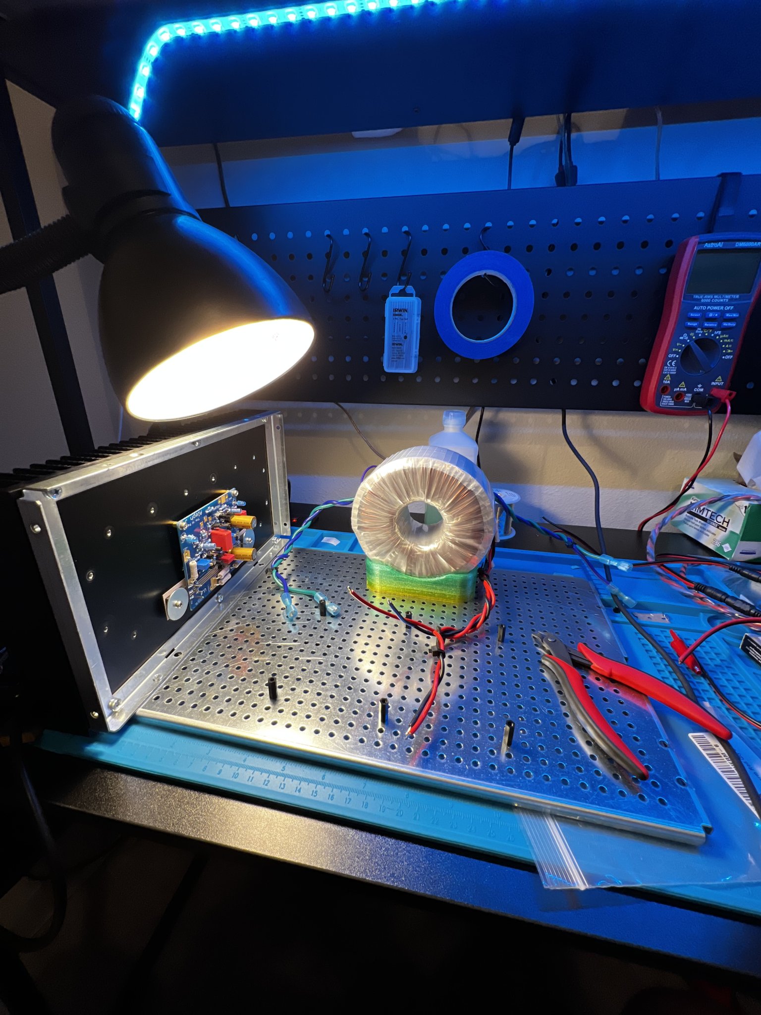

I like my Aleph Jzm so much, I'm about to start building number two today. Then I can have one in WA and one in MN! Saves on the suitcase space lugging one back and forth with me 🙂
Now, the question is...How long will it take to go from blank boards to music? I know it's definitely not a race or something to rush, but I head back to WA Sunday morning....I have 5 days.

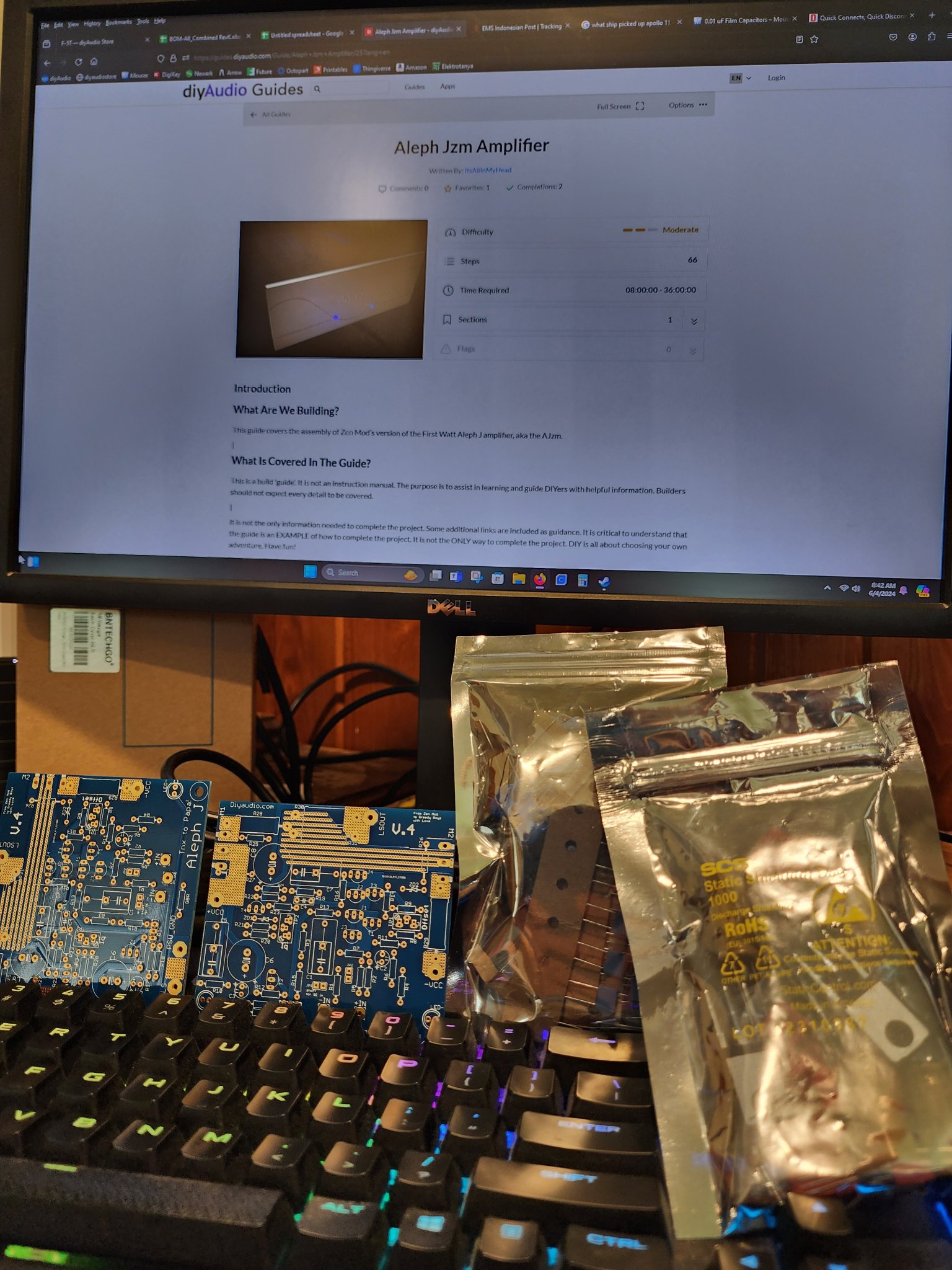

It would be nice to see the store offer
The Aleph Jzm board only option
And someone could post BOM were we could gather our own parts!

you have on disposal all files necessary to make your own BOM, as anyone asking for just pcbs, should be able to do
ZM not preaching, just saying that making own BOM is measure of learning and independence .......... which can give you enough certainty to be able to use parts you already have in drawer

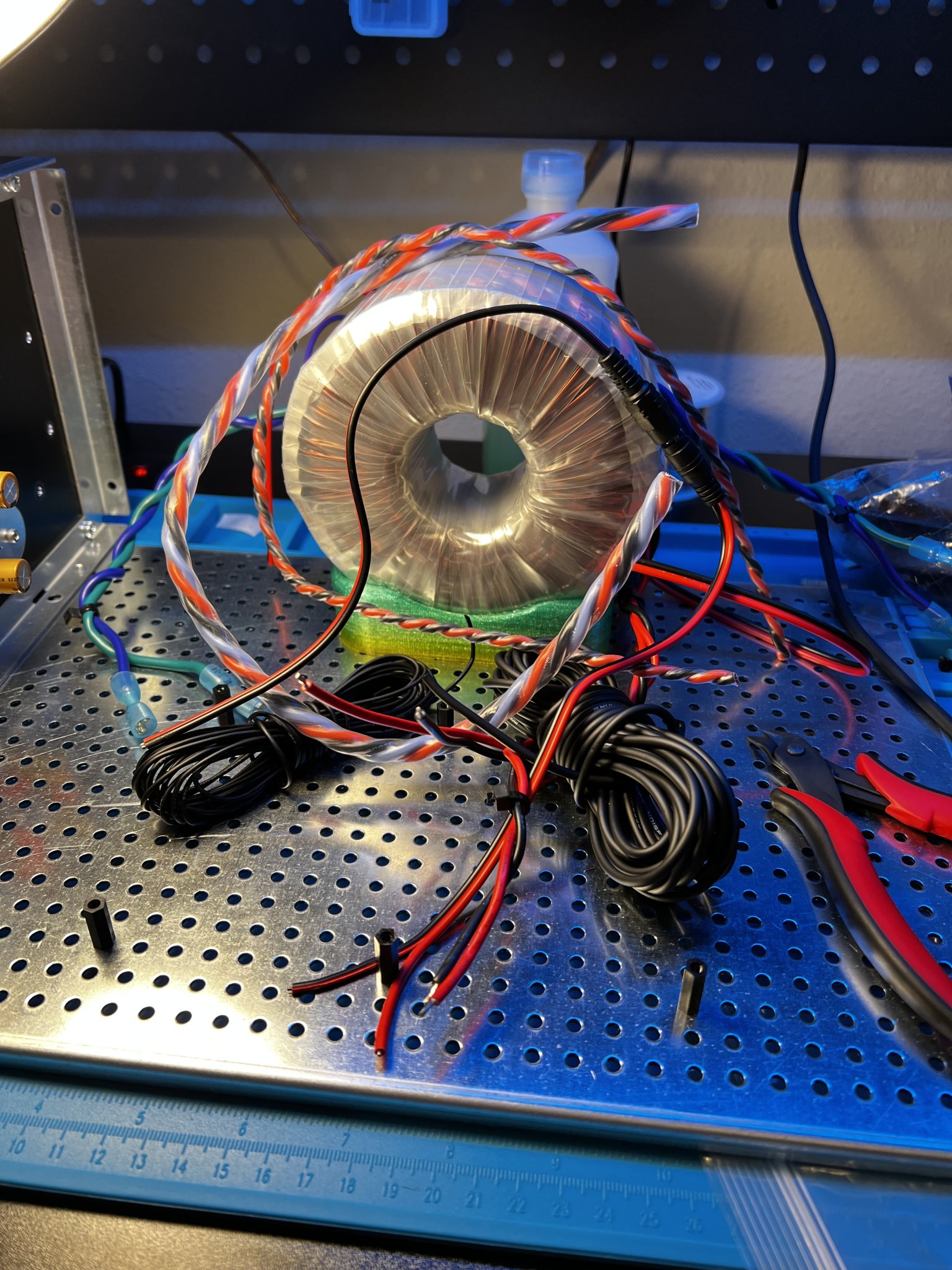

My kit arrived yesterday so once my 5mm 150sqcm copper heatsiink interfaces* arrrive I'll start assembling.
(my thinking is to get the heat away from the mosfets as rapidly as possible as Cu has a 75% better thermal conductivity than aluminium. This in turn gives a much larger contact area with my fan cooled heatsink.)
