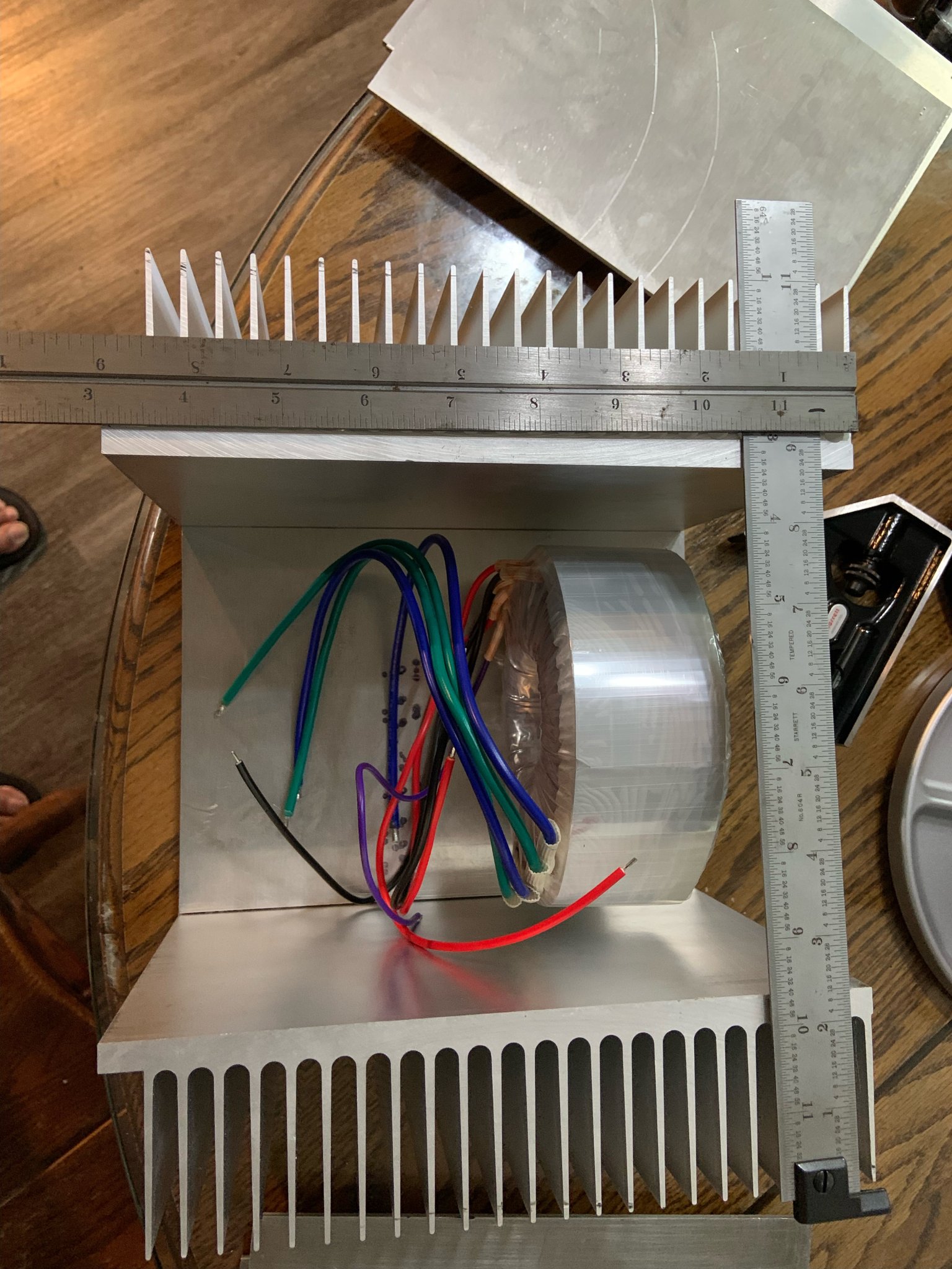

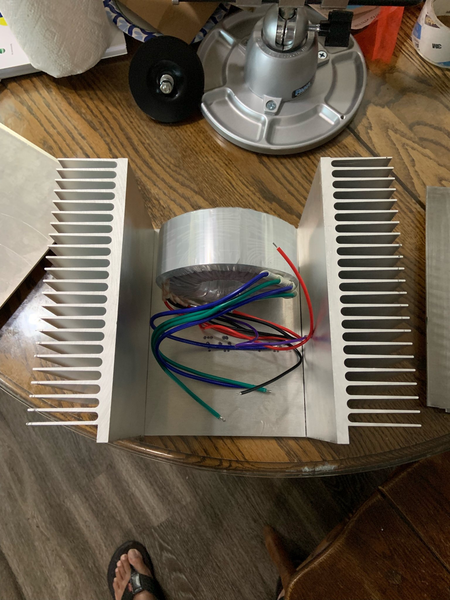

I now have both the F5m and Jzm kits. I wanted to use what metal I had on hand but looks like the panels might result in a small box. Also are the heat sinks adequate for one stereo channel? I have four pairs of them, I could double but do not have the real estate for large footprint ampls.

Those heatsinks are on the small side. Besides the challenge of fitting the PSU inside the chassis, they will limit the bias current that can be used. Still possible to build a nice little amp with these. Start at 1.2A and see how warm it gets.

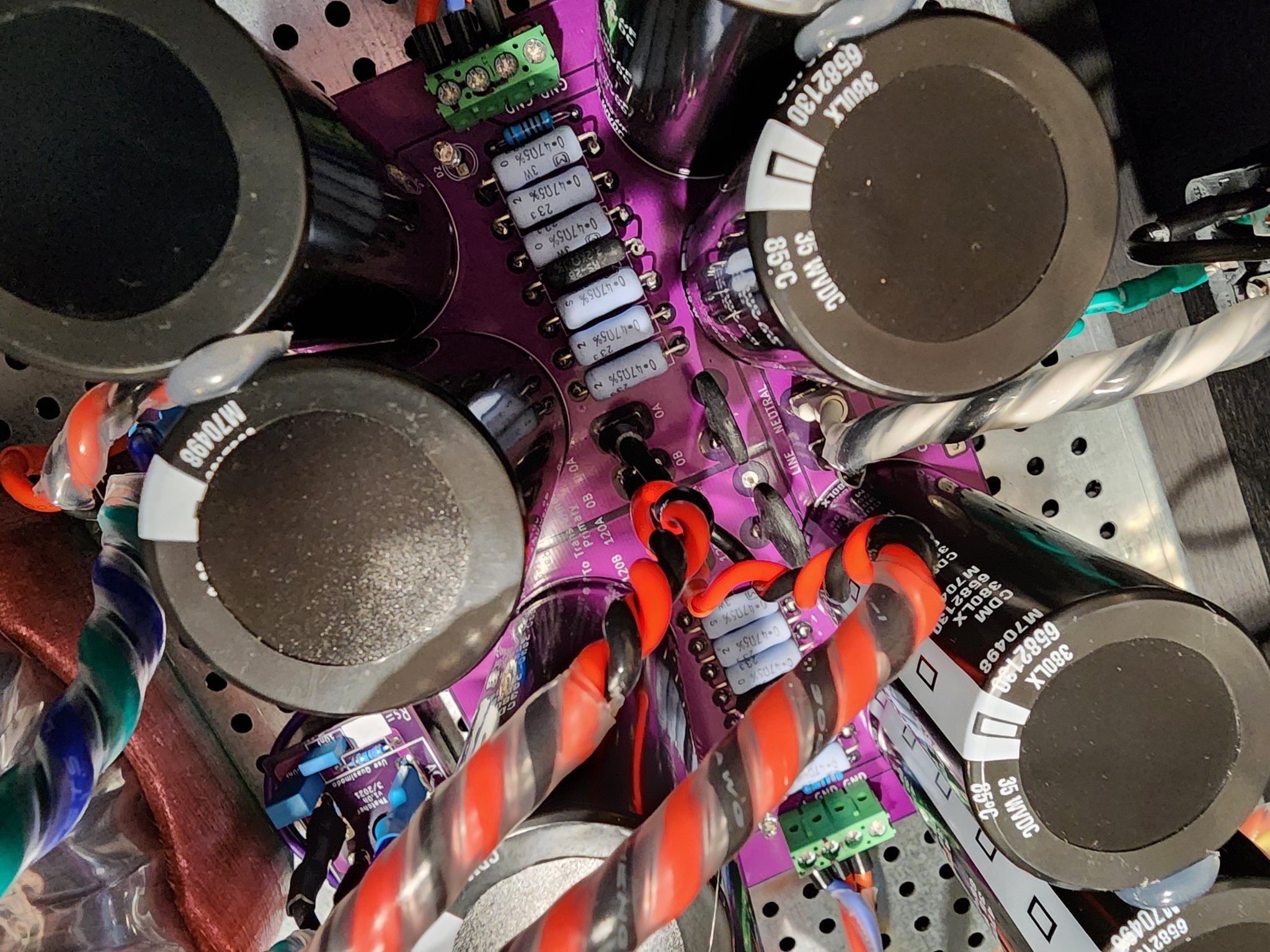

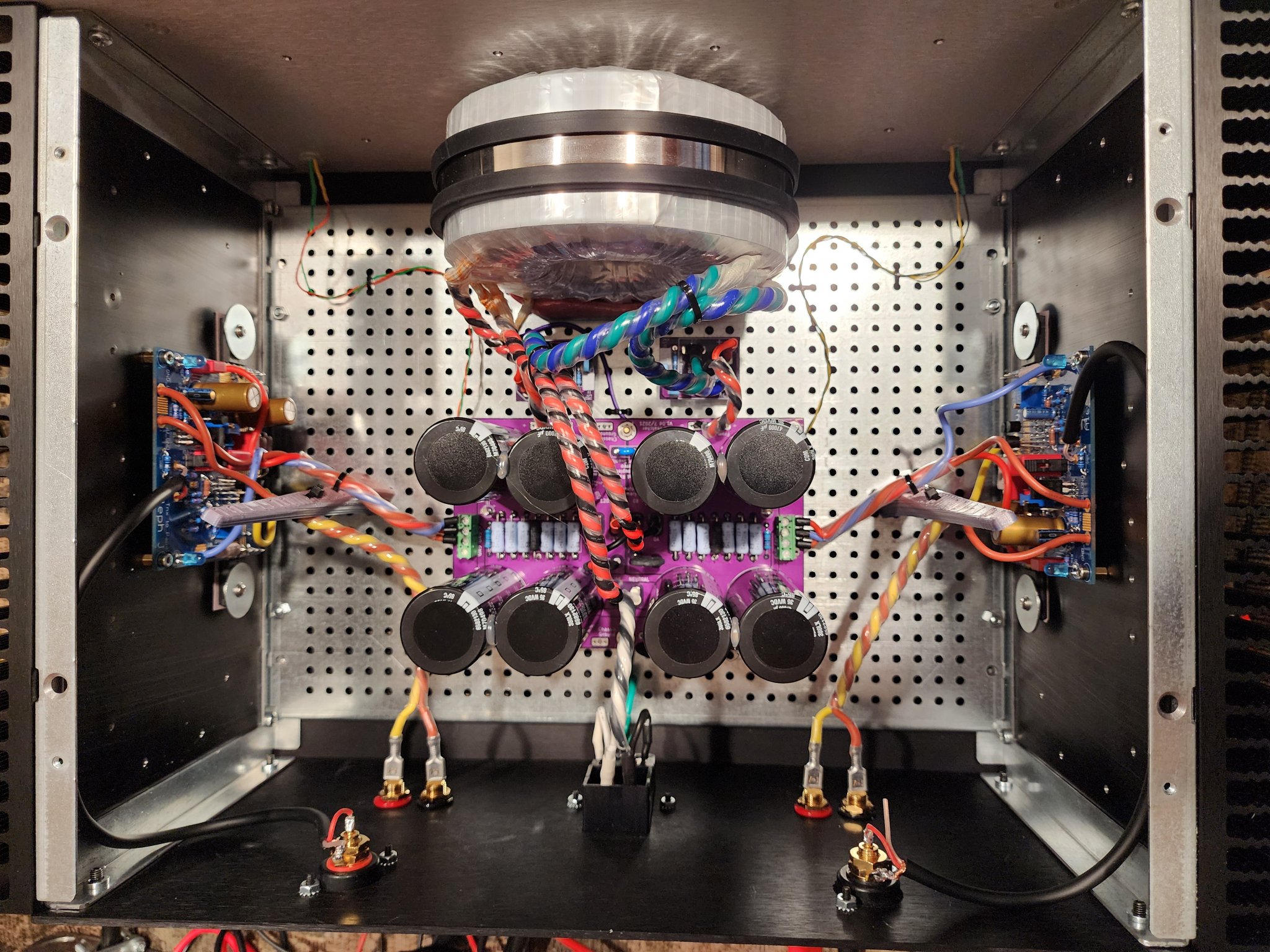

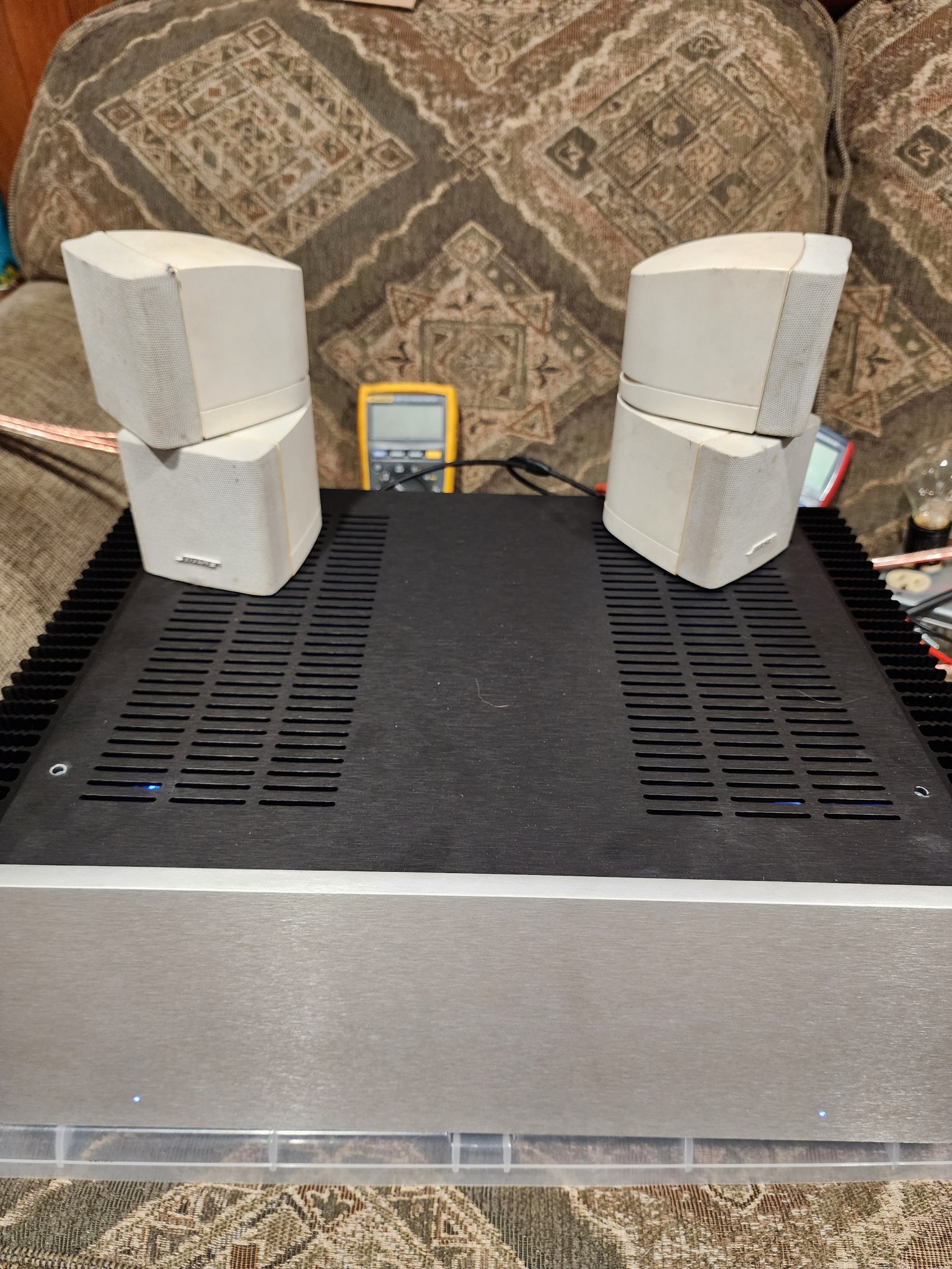

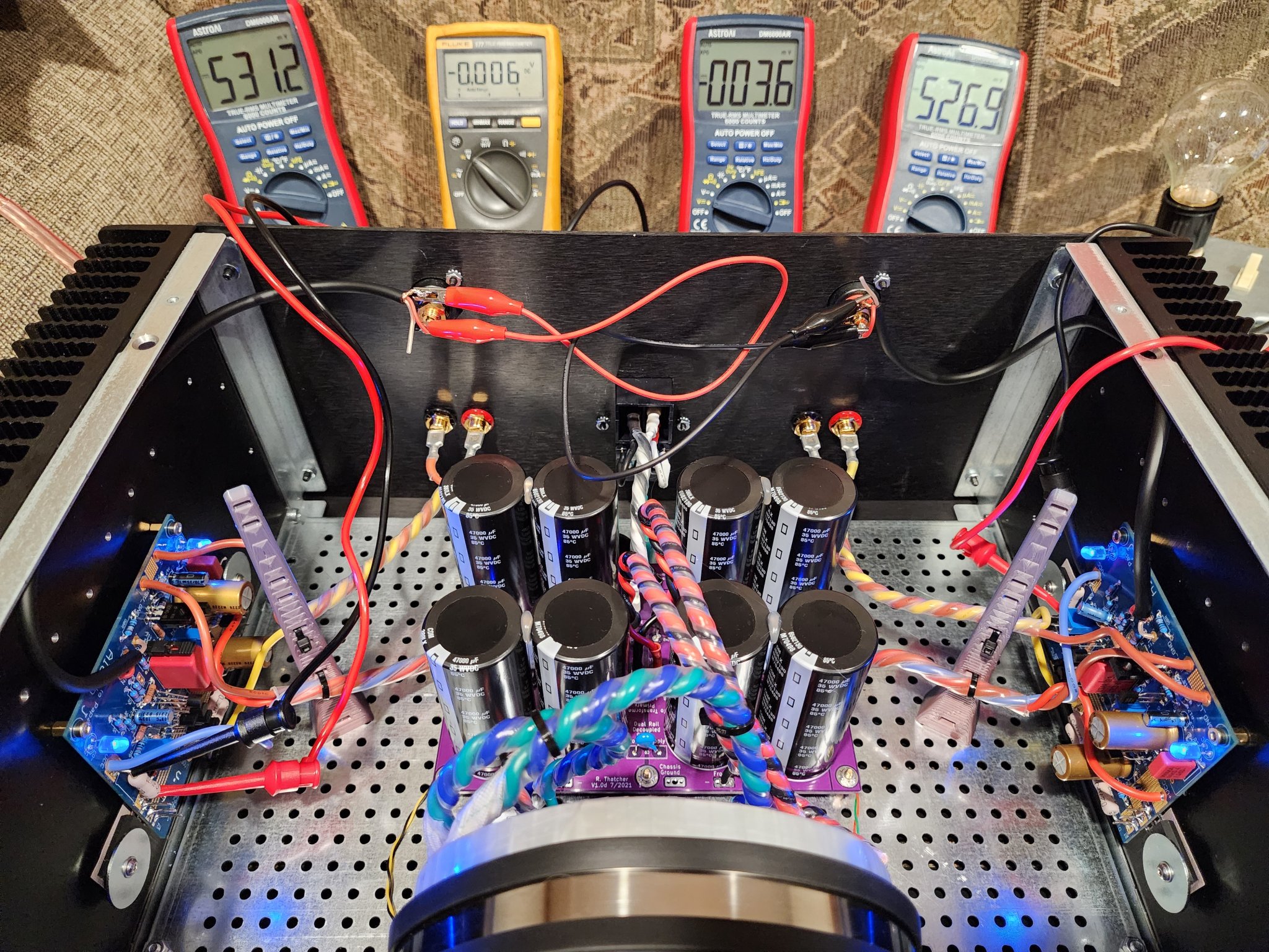

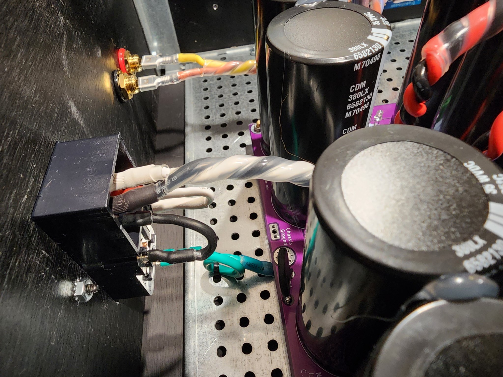

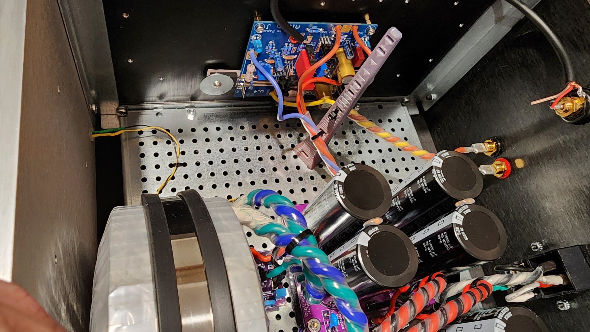

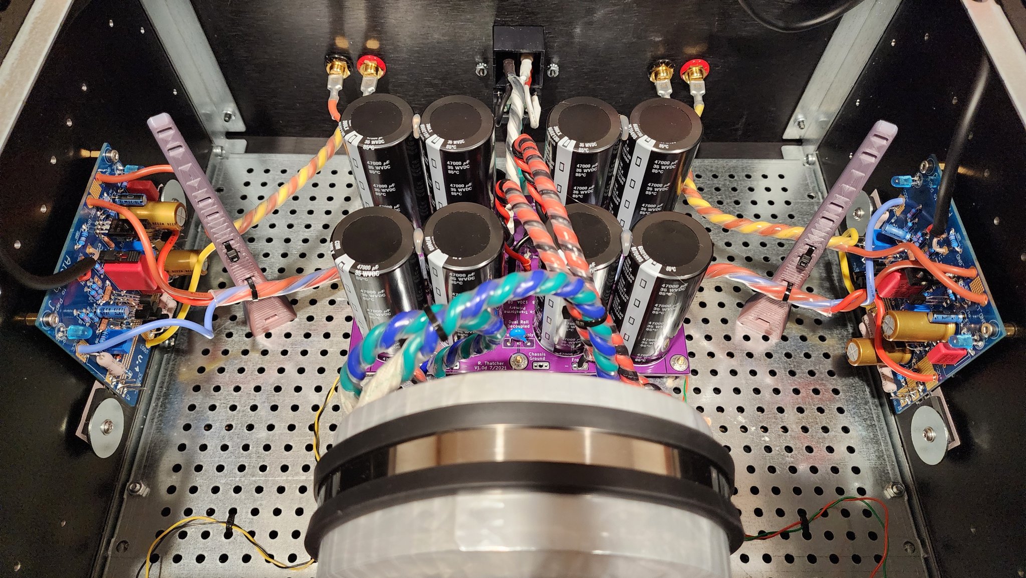

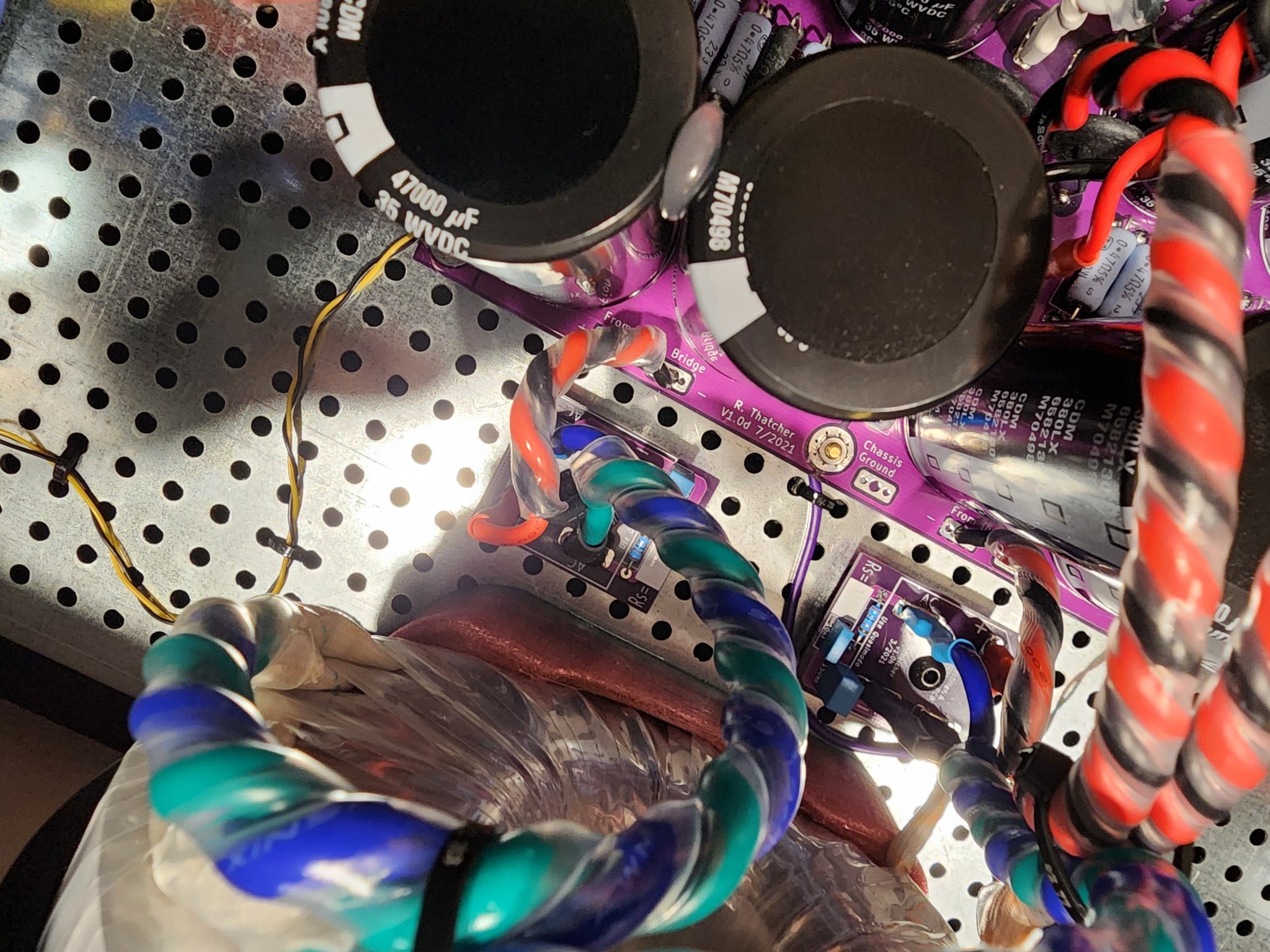

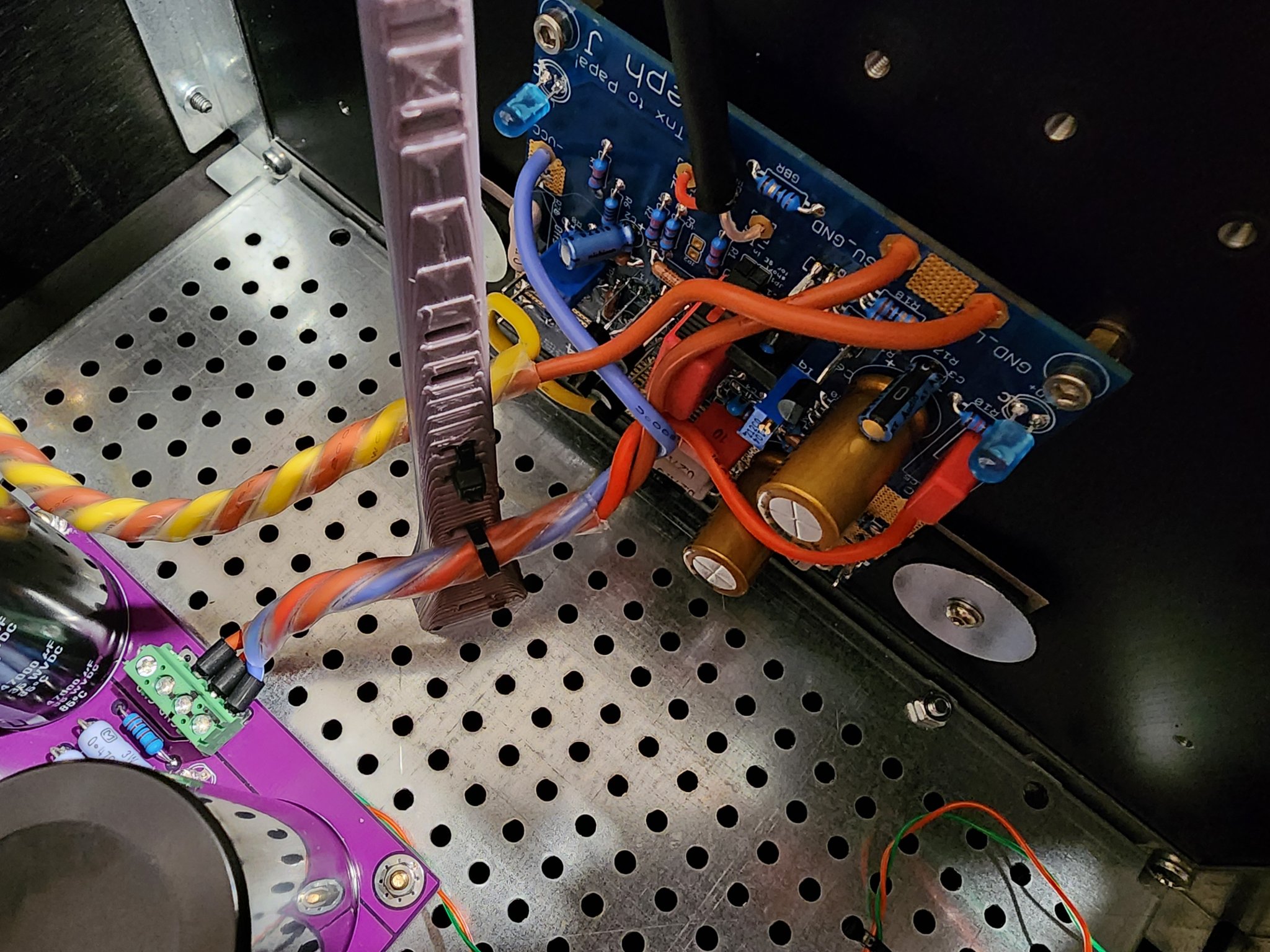

Another Aleph Jzm has been born into this world and playing glorious music! Part Deux sounds just as good as the first, although this one has significantly more capacitance. Part Deux will remain in the land of 10,000 lakes so those here can enjoy it's oh so wonderful sound.
I only hook up the finest 1998 vintage Bose Acoustimass satellites for this lovely amp
[Ok, that was my test speakers before given it something with a little more range.]
Not much else I can say other than I love this amp. Will there be a "Aleph Jzm Part III: Return of the ZM" in the future......time will tell.
As always, Thank you to Papa, Zen Mod, ItsAllInMyHead, and so many others!

@vinay There are Metal Supermarkets locations in Kent and Everette. They stock loads of suitable perforated sheet in steel and aluminum but they're pretty pricey. You may get better pricing as a walk in customer than online. It's likely cheaper to order a prefabbed bottom plate from modushop, even with shipping involved. I'd agree that you're probably in the 1-1.2A bias range with those HS depending on how cool you keep your place. 10"x 6" x 2" fin HS work for me but I need to dbl check where the bias landed after I moved them inside. Originally I set them at 1.3A but my shop is several deg cooler than the house
Fins are 2", base is 3/8, length 9" and height 6".How big are those HS?

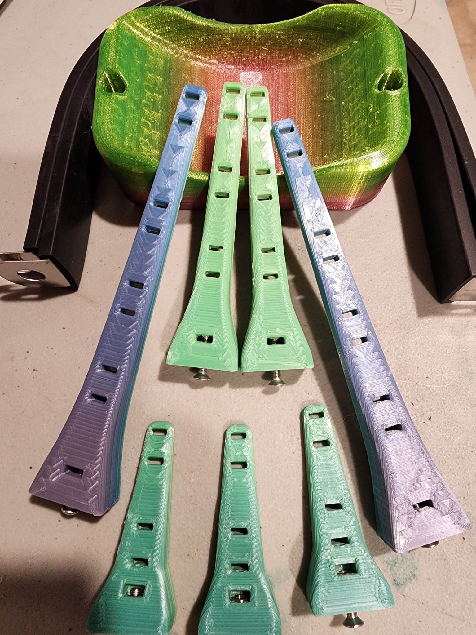

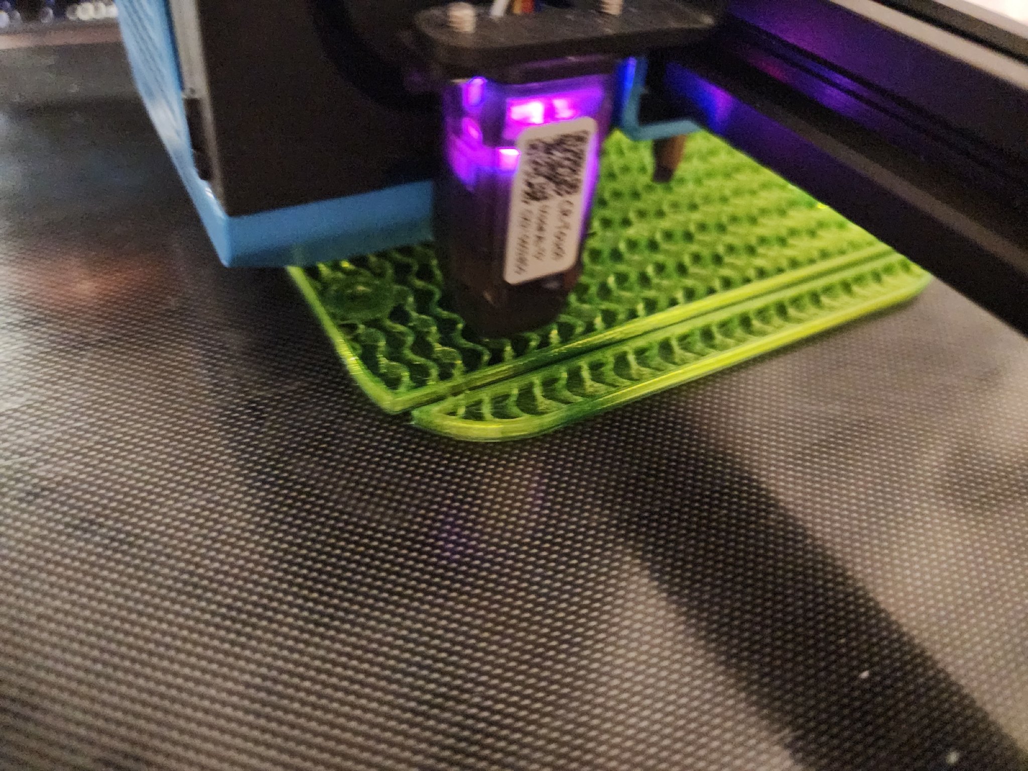

neat. I will just make a seat out of some wood and foam, and use one of those strap clamps for my implementation.That's a fancy 3D printed "Transformer Chassis Seat".
Thank you for these close up pictures... this gives me hope that I can get this together.Another Aleph Jzm has been born into this world and playing glorious music! Part Deux sounds just as good as the first, although this one has significantly more capacitance. Part Deux will remain in the land of 10,000 lakes so those here can enjoy it's oh so wonderful sound.
