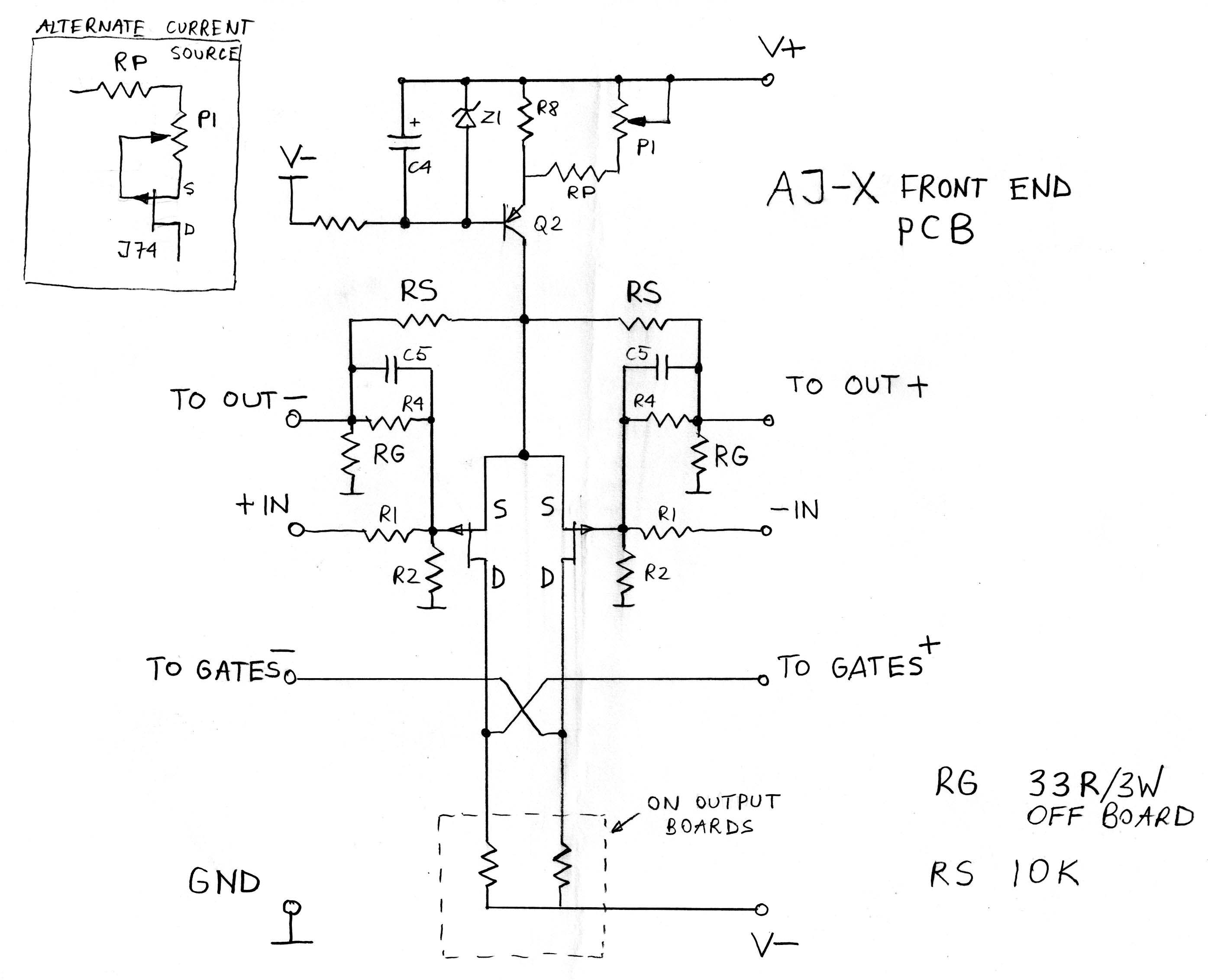

Good point Peter. I obviously haven't thought this through yet. With lower rail voltages I don't need caps rated at 50V, which would be cheaper. BTW is there an official schematic that coincides with your latest JX boards? I came across a couple on one of the threads here. Can't remember which one. With all the different discussions on design changes with each new GB wanna make sure I'm referring to the right one.

You will find the info on a working amp here: http://www.diyaudio.com/forums/pass-labs/145387-aleph-j-x-amp-project-27.html#post2012118
X front end schematic attached

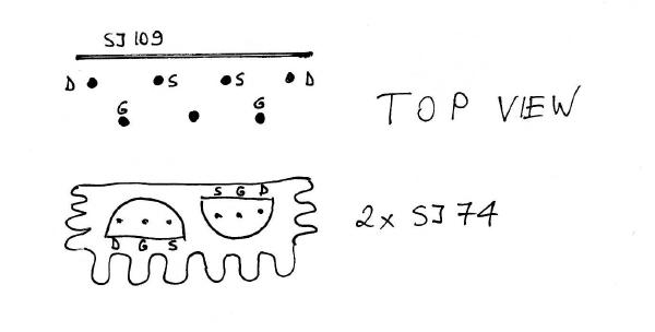

No, Ian.
You need type 0 for Aleph-JX, type 1 or type 2 for B1.
